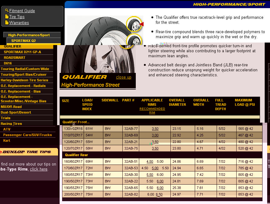

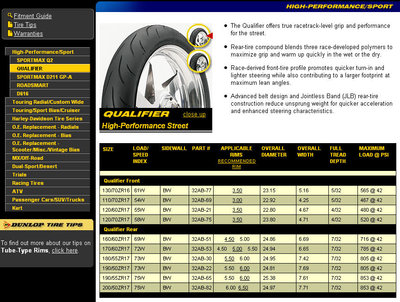

Thanks Bill. Everything you've written is making me think I should rethink these wheels, even if they're free. But I think you're off on the tire sizes - my understanding of industry consensus is as shown in the Dunlop chart below:
At least here in the US, a 4.5" rim is still pretty good for race tires; there's still a lot of options available including some decent slicks, thanks to the Supermoto scene. But I'm getting more inclined to wait for some skinnier rims to show up. Know any Skorpions with spoke rims?

I admit I have little knowledge of present Dunlops. With much bad experience in the past, I would touch them with. gloves.
Reference rim sizes for 150/60;
Pirelli - 4,25"
Bridgestone - 4,5"
