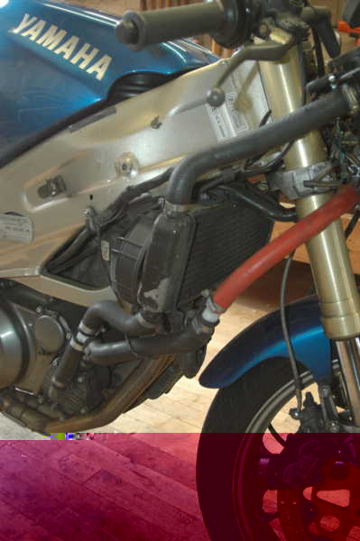

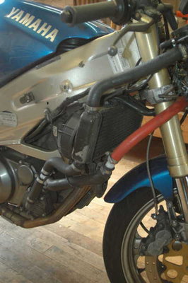

I don't have any shots showing a MZ (I sold my water-cooled Skorpions and mine is air-cooled) so I can only show you my Yamaha but it is basically the same thing.
The hose from the back of the cylinder (the one with the phoney thermostat) is connected to one of the two inlets at the bottom of the FZR Image
In the Yamaha that hose comes from above the engine in the mddle, here to be seen between the fork legs.
Then you cut the hose to the water pump apart:
using the T, you connect that new length of hose (here the red garden hose) to the other inlet at the bottom of the housing,
the original hose goes to the bottom of the radiator as before. The outlet at the top of the housing goes to the top inlet of the radiator.
Don't be mislead by the Yamaha here; it has a separate filler cap because the radiator is hidden and inacessable under the faring. You do not need this at all. Your MZ is no where near so cluttered-up.
The FZR part has the fan switch as you can see and I would connect the fans to this rather than to the radiator switch. The other small one is for an electric thermometer which, unlike the MZ, most Yamahas have. You could obtain one and mount it in that useless clock hole.
That is all there is to it. You get a true, thermostatically controlled system that dependably keeps the coolant at ±80ºC and gets to temperature in short order. Cold, the thermostat remains shut, the coolant flows thru the bottom of the housing directly back to the engine, bypassing the radiator, until the temperature of the coolant is high enuf to open the disc valve and allow flow thru the radiator, Higher temperature opens that valve more, colder opens it less, just like in any more modern car.
