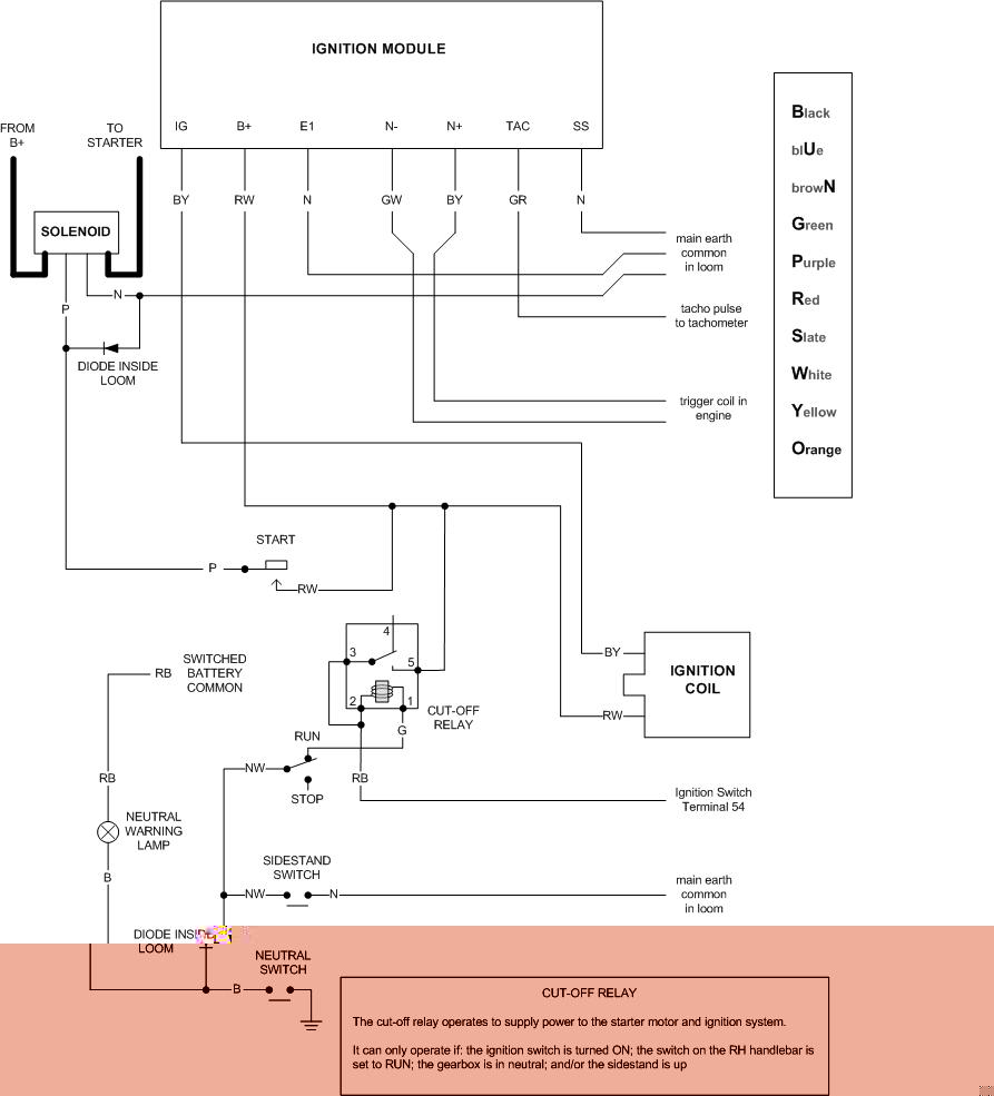

first up is a (bad) pic showing the starter motor area, there is one earth wire going to the starter, and this is the only thick earth coming from the battery. i noticed slightly to the right of it is another threaded hole with nothing in it or going to it. does all this sound ok so far?
next up is the relay
as u can see, it still has a free connection, these may even be in the wrong order as i dont really know what my friend had tried with it. it looks ok and dosnt smell like its got too hot at all.
I would love to get this running this weekend and i really do appreciate your help so far guys

Postby DAVID THOMPSON » Fri Aug 26, 2011 5:47 pm
it is the relay 19 as fitted original and
a link above shows how it is wired and replaced (repeated here)
viewtopic.php?f=4&t=2085&hilit=relayrelay
the green wire works with the side stand switch and neutral switch
to make relay close
when the key is turned on red black comes on with power if kill button side stand sw and netural sw are proper
then red white is +12volts also
if the fuse blows when the start button is pressed that's a different circuit than this relay is part of..
the start relay is on right front side under the seat seat near tank mount
it has 2 wires going into it that are small a brown which is ground and the other looks to be purple on mine that's +12v
and has power when the start button is pressed
disconnect the plug connection
if both measure as if there both connected to ground then there is a short in the start button wires
press start button with key on while measuring for voltage on these 2 wires
if you get power then the start relay is probably shorted inside its case
after a look at the wiring drawing item 32 is a diode in the harness some where if it shorted it could be the problem
i am thinking its in the push switch at the handle bar but also diode could be it

Postby kev » Sat Aug 27, 2011 12:36 am
going on the way im reading that diagram and the diagram on side of relay, id say its current wired up wrong, terminal 4 should be the terminal without the wire going to it, not 3. im going to try and pick up a new relay today and failing that i expect there is a away i bypass the relay for test reasons by touching the wires together. the handle bar switch dosnt look the best either so i will test that later and if needs be, i will remove those wires and bridge the wires there too. hope to solve this soon then i can start on the fun mechanical bits.
kev
Posts: 28
Joined: Fri Aug 26, 2011 5:26 am
Re: mz rt 125 blowing fuse
Postby kev » Sat Aug 27, 2011 3:09 am
heres the readings i have from relay+ battery
battery 11.54v
relay- red/black wires 11.30v push start button slight drop in v
blank terminal 0.07--push start--11.30
green 3.00v push start 3.5v (stand is down)
black/white 9.15v push button 0.01v however if remove this wire and test on relay terminal i get 11.30.
