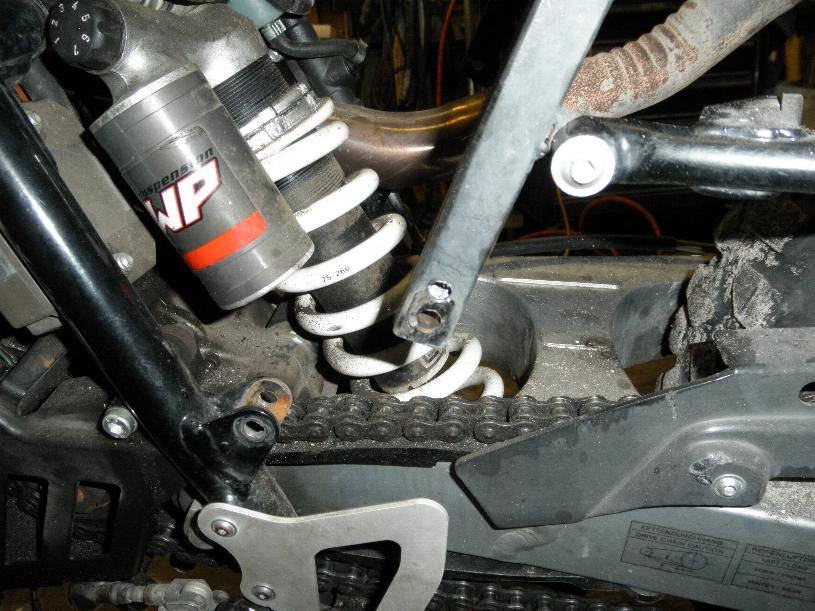

Here is another way to lower the seat, without affecting the suspension. I removed the airbox at the same time, so it may not work if you don't. Drilling a new hole and cutting an inch off the bracing dropped the seat to near level. Before it was slanted towards the gas tank.

Postby jrm » Thu Oct 13, 2011 11:51 am
I did:
.Longer dogbones 130 I think
.Cut lower subframe strut by 1" and then filled both side with 2 strips of steel so they went right up to the horizontal of theframe, welded and redrilled.
rubber bobin fitted under raer tank bolt to take up gap.
.air box had to go as it woulnt fit
base for electrics made from sheet alloy
.K&N stlye filters fitted to hose not carb to offer protection from weather
.rings have to be fitted to stop rubber collapsing
.Seat had to be cut and plastic welded to change its shape.
.removed seat foam fitted gel pad then put some thin foam on top
.pushed forks through by 2" and fitted billet rised clamps
Changed exhaust new S/S KTM end can and a link pipe
Just a few of the mods
