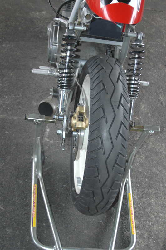

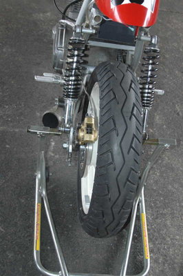

Bridgestone BT45
Use 140/70 for the rear. The 4" rim is too narrow for 150 tires. Again, this has been thrashed before. Makers reference rim sizes for 150/60:
Pirelli/Metzeler: 4,25"
Bridgestone: 4,5"
The BT 45 is your best choice for all-round riding and stands up relatively long. It is also quite good in the wet. Don't be cecieved by it supposedly being old-fashioned. We racing these tire in classic classes where 18" and larger rims are prescribed; on things like this 100hp 1200cc, 190kg Laverda
or on 1000 Guzzis.

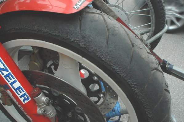

No sporting radial tire good in the rain is good for mileage. For me it is safety first. In my own experience with lots and lots of tires from Pirelli, Metzeler, Michelin, Bridgestone, even Dunlop and Avon (igad!), cold grip and wet grip are the first criteria, followed by handling. How man miles a tire lasts is unimportant - or rather only an aspect in comparison of otherwise very similar tires. On the road I prefer Bridgestone above all others by a wide margin. I won't even touch Dunlop or Avon, and am wary of Michelin from personal experience. Always in reference to the Skorpion or SZR, not to much heavier, vastly more powerful bikes where Pilot Powers etc are very good.
For what it is worth, I raced with Pirelli SuperCorsa, Pirelli Dragon Rain, and Bridgestone slicks.
We use SuperCorsa with the Bimota:
and as said, BT45 on the Laverda:
quite easy to see the dual-compound tread here and also that tire is ridden to the very edge. like the Pirelli on the Bimota.
So, you can see that the "old-fashioned" BT45 is up to the job.
OT, you also see the factory 3-1 megaphone; too bad I don't have a sound clip of this 180º 3 cylinder scream that brings the fans running to see if they guessed right...
and while ob the topic or growls and roars, the Bimota is so brutal, that people run for cover: over 130DB, out of range of most instruments.
