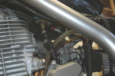

Hehe! Yeah, it's a plastic tank. Honestly, I found the tank to be completely clean. The gas looked great as well.
I think there is another problem. I have no idea what it would be unless somehow the timing is off. I really wish I could use the high performance tools I used on my race car (EGT sensor, knock sensor, fuel injection, wideband, etc)
Seriously considering converting to a fuel injection system.

Probably not getting enuf fuel. The petcock of the MZs is notoriously too small, rtho the Baggi's is a wee bit better. The petcock also has a sieve.
Cup racers drill the petcock out as far as possible. I throw them away and use a Colder quick release connector. For the tank I make a simple straight-thru hose fitting out of brass, soldered. An acquaintance made them from CF tubing (model airplane stuff) and sheet, epoxied together.
Makes everything easier and if you need to shut off the gas, just unplug. And with a hose ID of 8mm it cannot possibly lack, not for that reason anyway.
But it could be that the valves are too tight.
Or the plug gap is too large or the lead has a bad connection. Those screw-on leads are crap anyway.
Or the coil is funky. Doesn't happen very often; I've seen it only two or three time and never with the DENSO coil but who knows.

Thanks for the info. I am certain it's not the petcock. It flowed very well even before I cleaned it. If it used so much fuel that the flow rate was the issue, I would only get ~10m of cruising before running out of gas.
I'm using 3/8" hose because I needed it to make this fuel filter fit.
I checked one of the exhaust valves and it seemed fine. I will check the others before I ride again (I am waiting on a countershaft sprocket nut/washer.)
The plug gap is fine and maybe the lead has a bad connection, but that doesn't explain it acting like it's running out of fuel only when cruising. It can accel from 0 to 70 without issue but it won't hold 70. It could be a coil maybe. if the denso coil is cheapish, I'll get one just for fun.

After cleaning the tank and filter, and installing the larger fuel line w/ fuel filter, my stumble issues have gone for now. Maybe they won't come back!! :)

If it was, I could not tell. I cleaned it: (simple soap and water, then let it dry, then rinsed with gas before draining and reinstalling)
However at the same time that I cleaned it, I also installed larger fuel hose and an inline fuel filter. It's hard to do without putting a loop in because the bung and carb are so close together, but I was able to pull it off. get the shortest filter possible.
I've never had the problem since.
