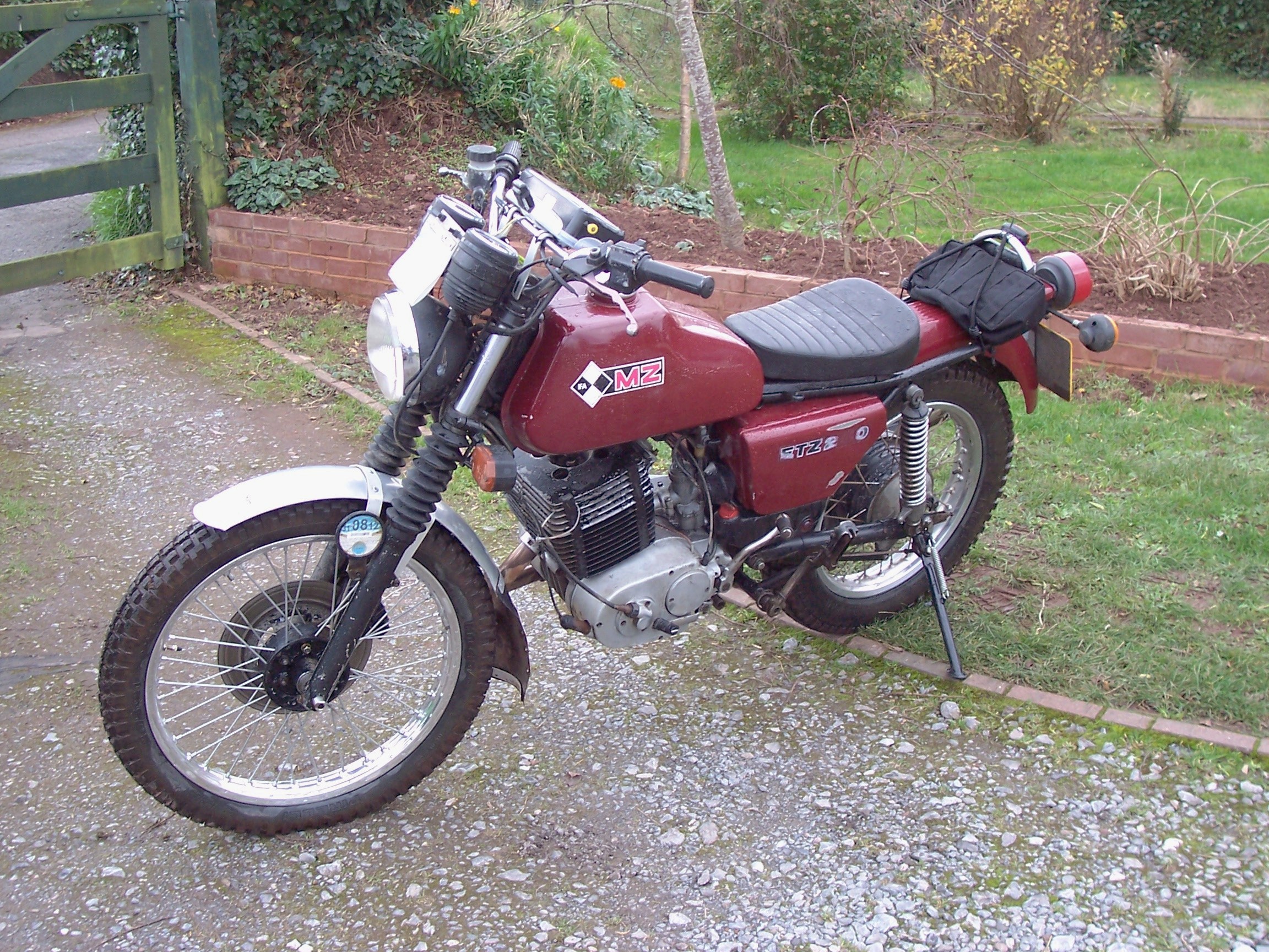

I have an '85 ETZ 250 that I use for long distance trials. I have noticed recently that it is losing power markedly even though I run a 14T gearbox sprocket. Tried fitting a Mikuni from Allens but that seems to be even worse. Ok on small throttle openings but won't clear or rev out and seems to be firing all over the place. Quite noisy on opening the throttle - from the head - like pre-ignition, but I have just decoked. Any ideas? Timing? Points? Are they prone to any particular troubles in this way?

I also found the carburetter that you have in your picture can be a bugger to set right , when worn the C clip that holds the needle, has been known come off and go through the engine with devastating results, the previous carb with the three float bowl screws is far superior, and easier to adjust.

Thats a very cool bike you have! what a good use for an ETZ.

How have you done your rearsets? Its a job I'm planning to do on mine, but not figured it out yet....... I'm assuming that you need to fold the left peg up to use the kick start?

Thanks for your offer of elec ignition - I may take you up. And thanks for the compliment. To be honest it isn't the ideal bike for 'trials' but it has a certain charm. The rear set footpegs are the original pillion mounts fitted with modified BSA pillion footrests, which fold to clear the kickstart. Not ideal but works for me, and I don't want to modify the bike beyond the point of no return - at the moment I can replace all the triallsy bits and get back to the original bike.
