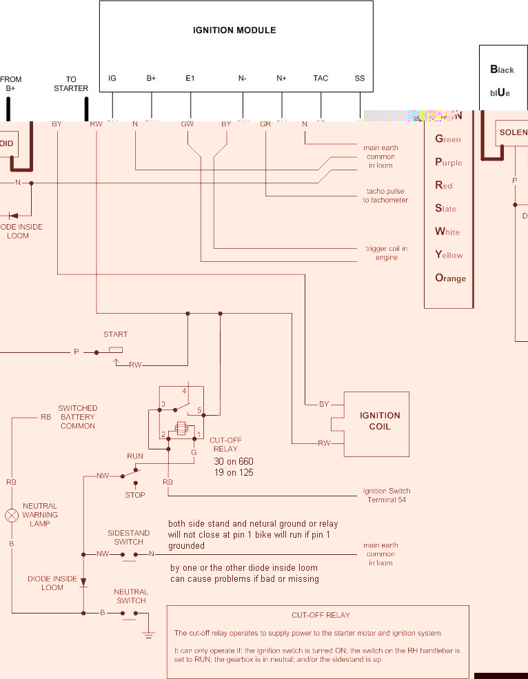

Postby DAVID THOMPSON » Sat Mar 10, 2012 11:16 am
maybe this will help
click to open in a new window then click again to make it bigger
also copy and print for shop display
most of the electrical problems i have had were all located using this drawing
Re: Mastiff with no spark at all
Postby Bill Jurgenson » Sat Mar 10, 2012 11:54 am
diagram says it all.
and it is very easy to see how especially the damned sidestand switch can be a real pain when it starts bouncing at higher speed or rpm, a very real problem.
Biggest pain of all is that these idiot traps are completely unnecessary. Generations of riders got along fine without them.
Rather than alleviating dangers, they cause more of them by relieving users of the obligation of THINKING.
nuf said

Postby breakwellmz » Sun Mar 11, 2012 3:03 am
Nice wiring diagram Dave,makes it look SO simple!
Is it really just a case of removing the side-stand switch and twisting two(?)wires together to get rid of the beast?
