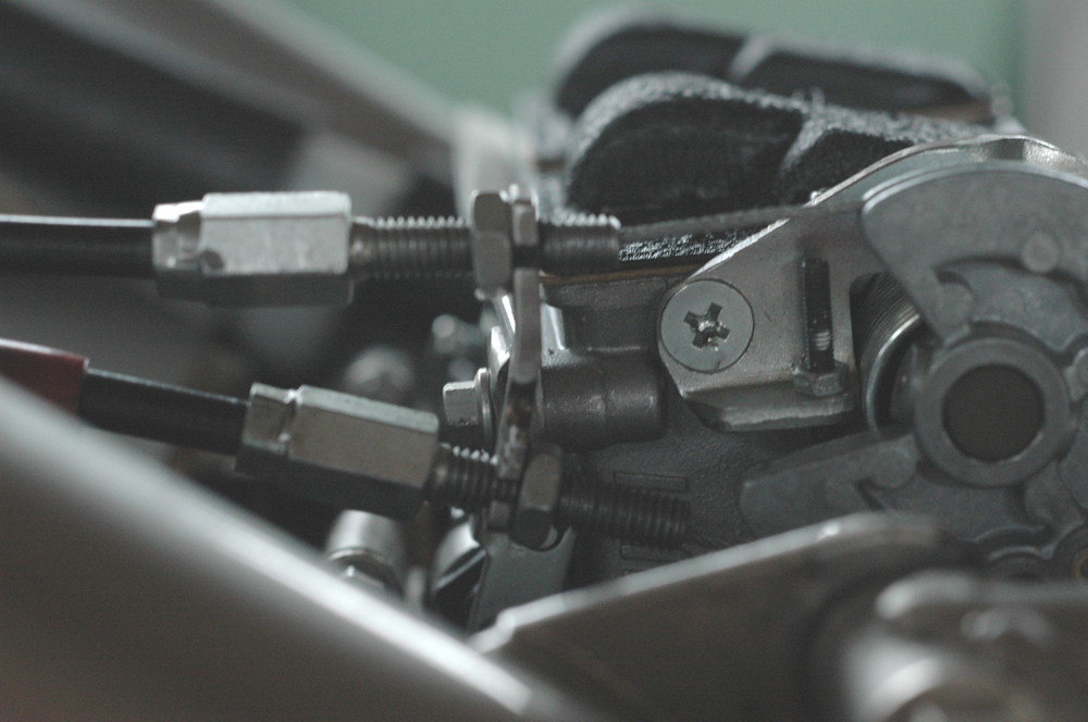

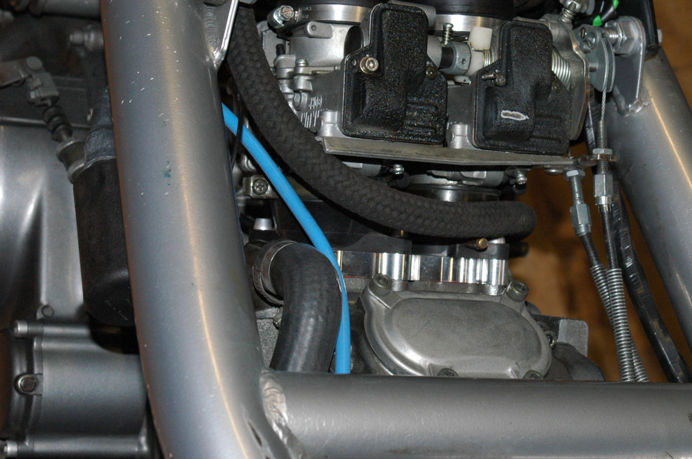

Postby Bill Jurgenson » Sun Apr 15, 2012 4:11 am
On the Mikuni , I understand you have to change the throttle linkages and control ? What parts do you use ?
with the Skorpion, nothing of the sort.
hier in the red bike mentioned above, right into the original airbox.
Even still had the Grimeca wheels but had already gotten my custom rearsets that Chris Hunsicker later got.
hier in the blue Tour called the Toy:

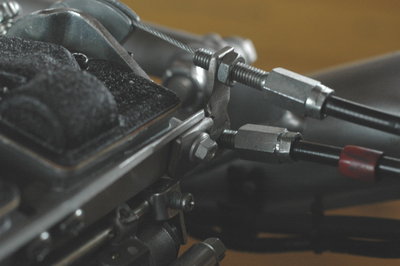

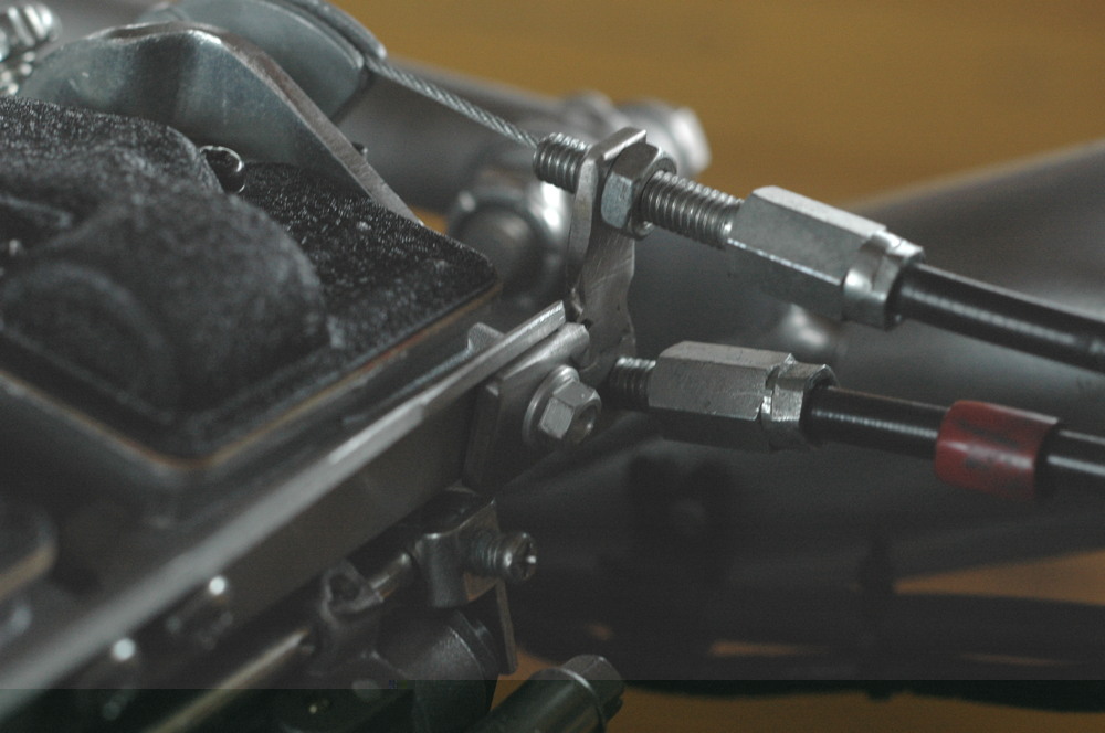

here with one of those milled spacers between carb and head, this one from Barker.
You have to saw off the cable bracket that does not clear the tank:
and make your own simple one like in the photos above. The cables are the exact same ones that were always there. You can also hook up the choke from the bars to the left carb if you still have that little lever; I did not, having long since junked both the bars and the armatures.
I have no working knowledge of eh baggi beyond test driving but the dual setup as shown above will certianly fit just like in the shots. Anything longer gets into trouble, however as Harold found out.
There is really no use in discussing Galen Miller's (not Holeshot's- they only sold it) Bikeworx kit since it is no longer available. It was good on the Skorpion but does not fit the Baggi or SZR.
Of course, you can, like Harold, make your own but then one would not be asking these questions here in that case...
Bill
