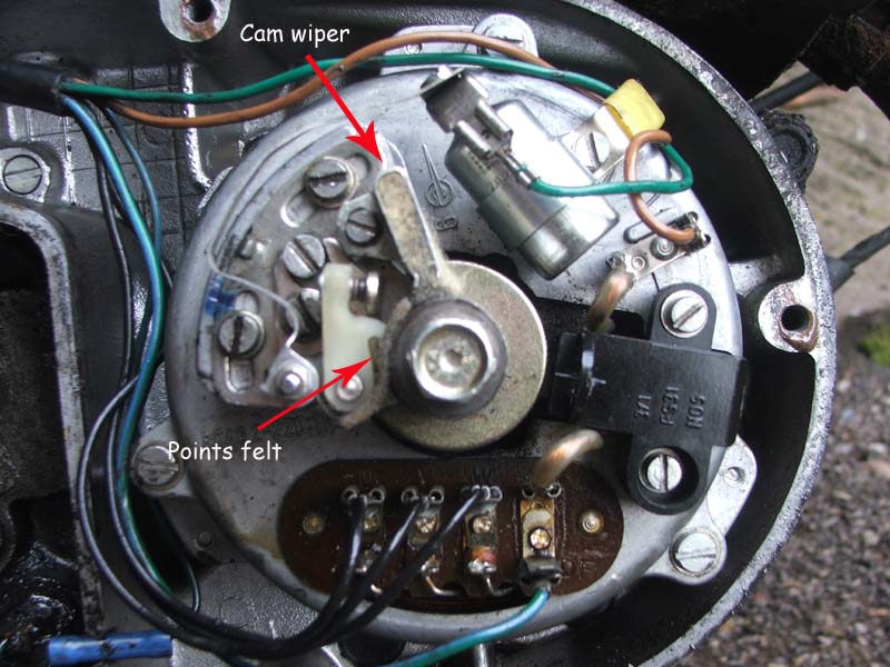

Any other ideas would be appreciated. Also, where is this felt pad supposed to sit, a pic would be great!

The felt pad fits between the points and the cam. The cam follower should go through a hole in the felt onto the cam. Also remember to oil the felt wiper, as this lubricates the cam to reduce wear on the points cam follower.

Postby radiograf » Mon Jul 09, 2012 2:26 am
There you go, points layout on an ETZ251.
points layout etz251
As I said before the points cam follower fits through a hole in the felt .

Postby DAVID THOMPSON » Mon Jul 09, 2012 7:36 am
CLICK ON THE PICTURE IN ABOVE POST FOR A BIGGER VIEW
and that shows it better an it should do a good job

Postby mzeck » Tue Jul 17, 2012 2:14 pm
New points now fitted & I now understand where the felt pad sits - thanks very much guys!
