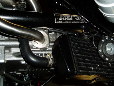

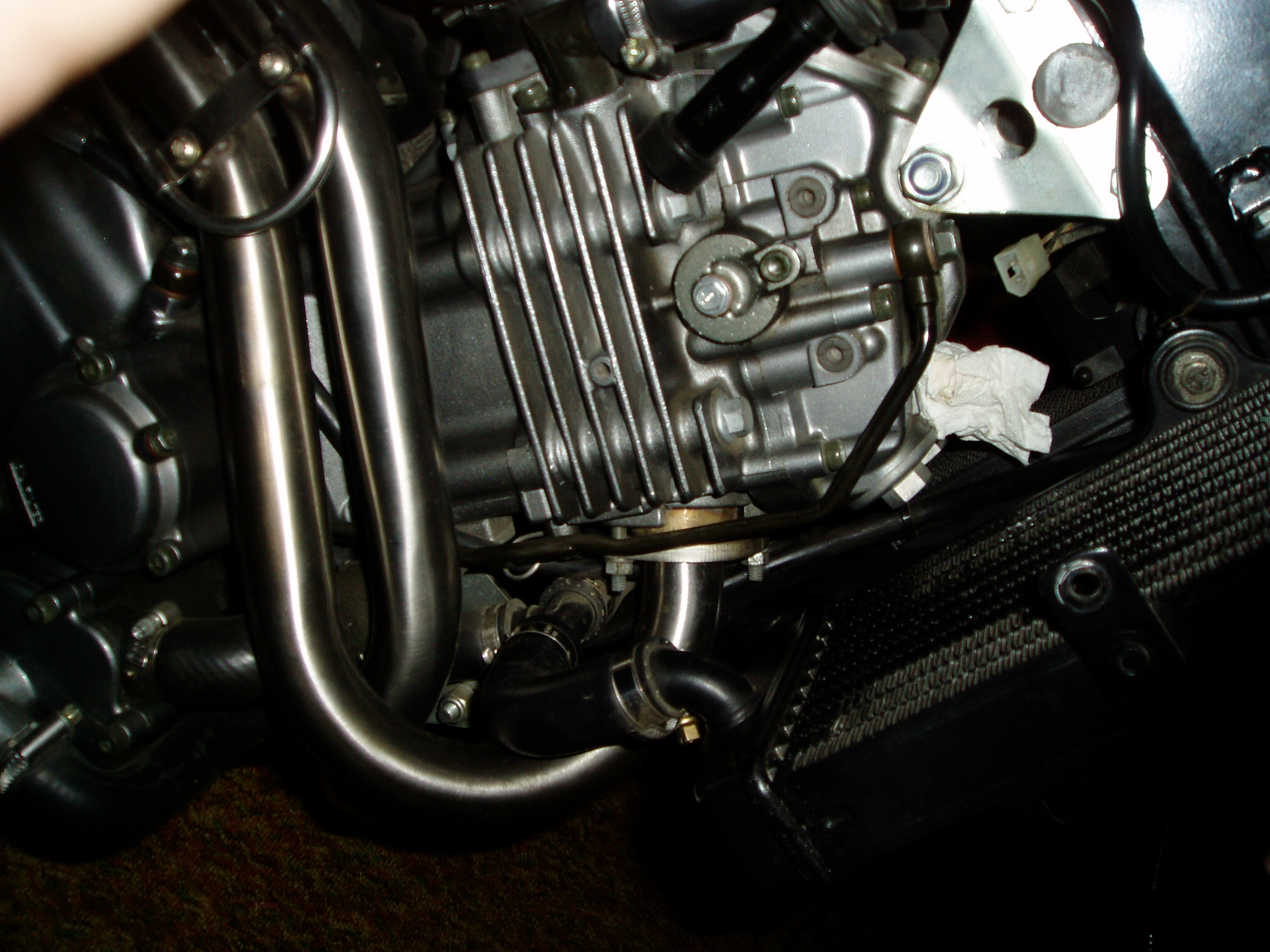

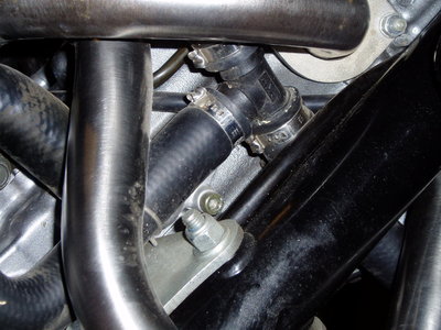

Postby OLDMTNCARVER » Tue Aug 28, 2012 11:53 pm
Yes it is close...
Here's another view as it goes behind the oil line and up through the retaining loop.

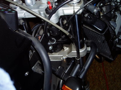

Postby OLDMTNCARVER » Wed Aug 29, 2012 8:18 am
Continues up through a plastic retaining loop on the frame. It is then tied to the radiator over flow tube with a zip tie at the bottom of the left radiator and on up between the radiator mount and frame.
Note that the pictures are of a "from the factory condition", lower height Baghira.

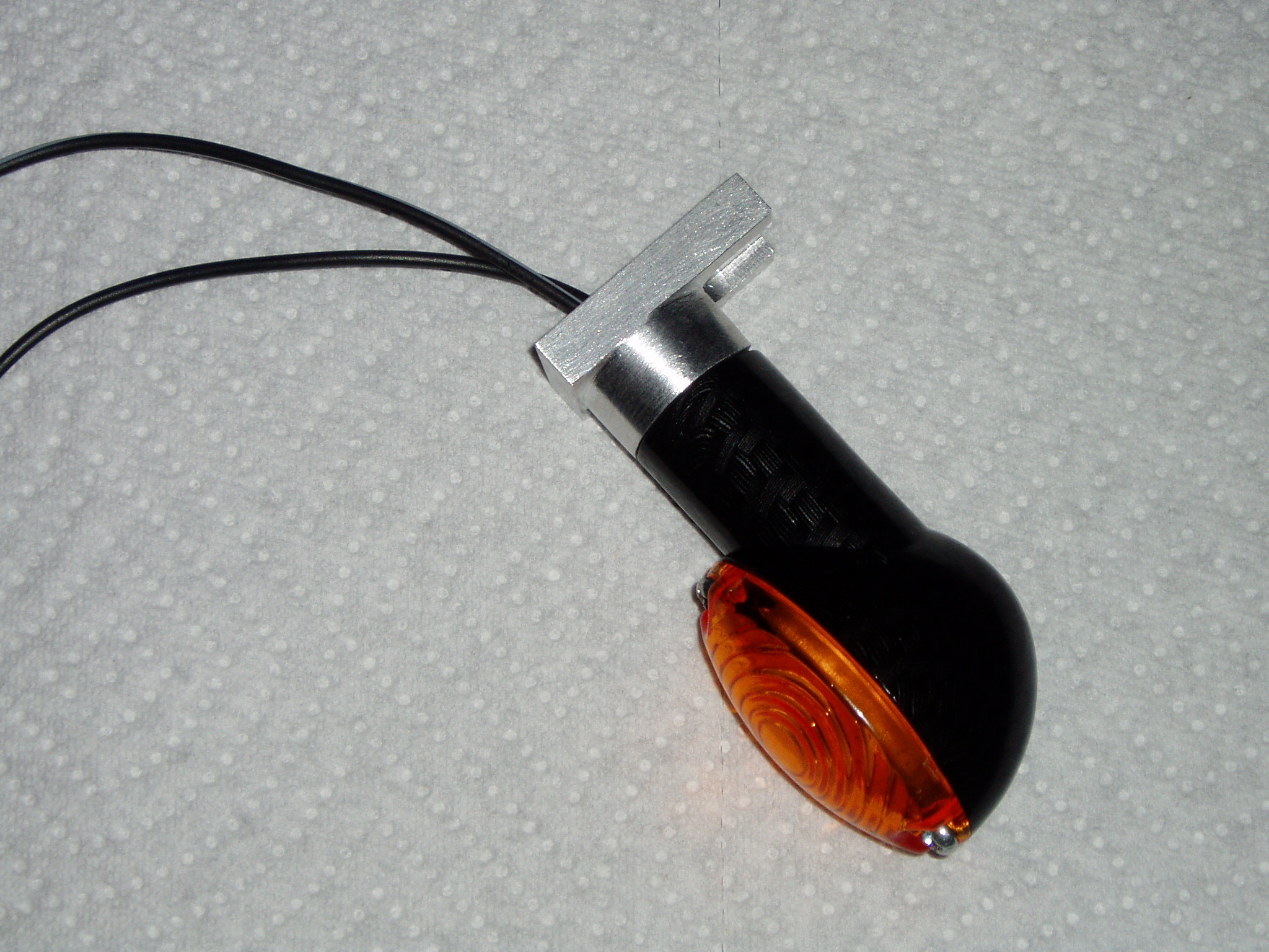

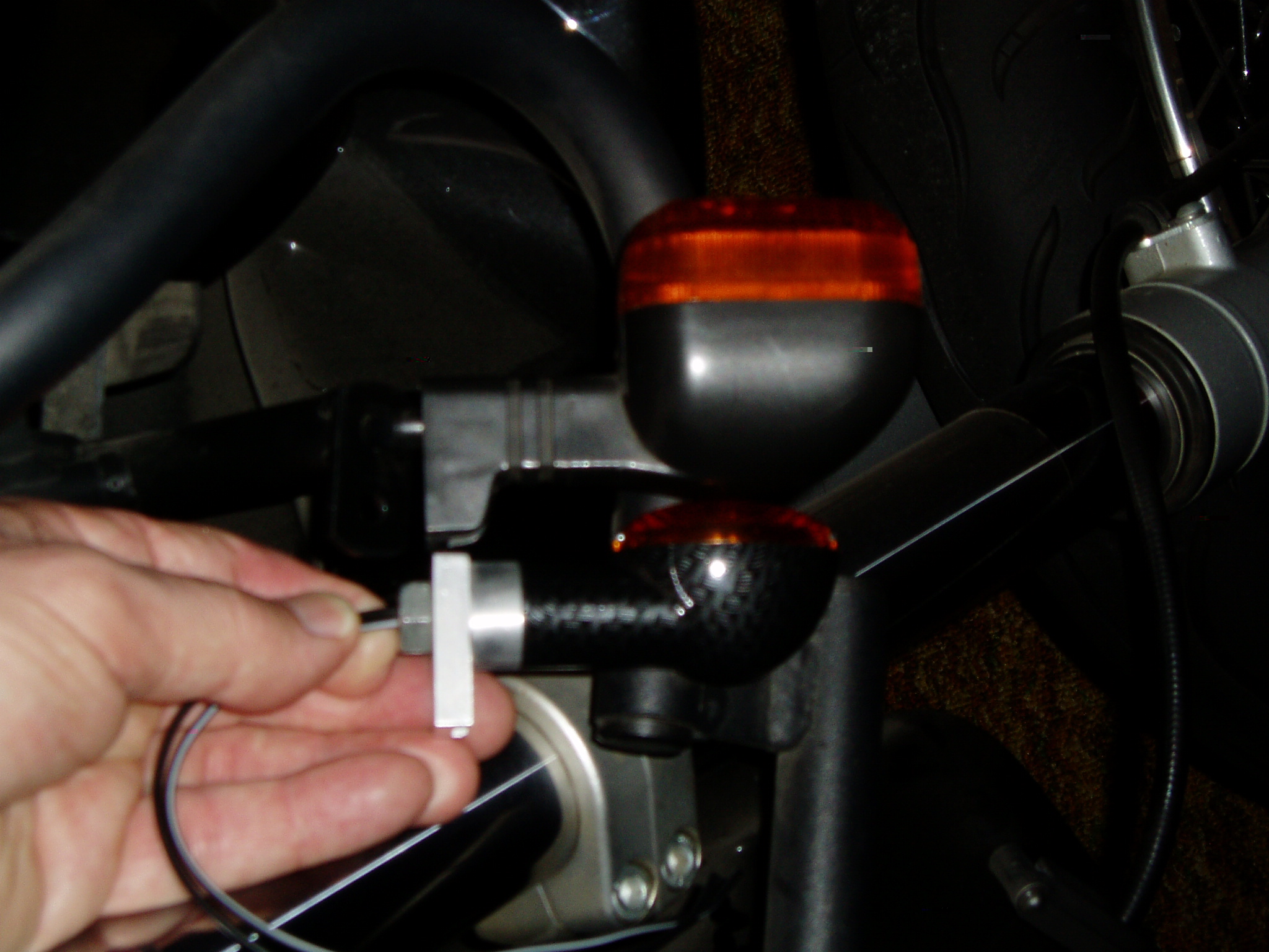

As you might have read in other posts I'm working on electrical issues at the moment and learning some... so the plastic is off and at the same time I figure that I might as well clean things up some. I've done some modifications to an extra subframe as I checked the electrical back there.
Before I get into the front electrical... turn signal mounts...
Another picture for reference...
Again, your bike stock or not, any help with reference pictures just ask...
