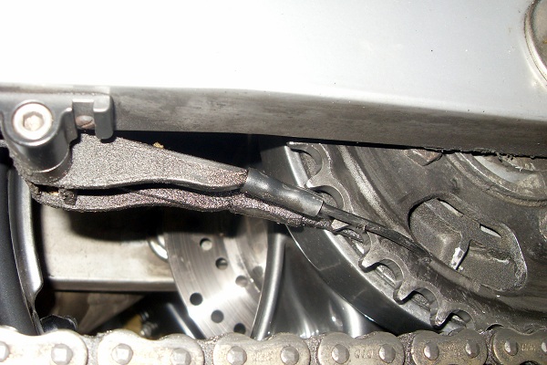

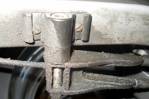

Postby Norman Wade » Tue Aug 28, 2012 1:51 pm
My Scottoiler has the Dual Applicator. I found that it works well if the tubes just touch the sprocket as the oil will then flow onto the chain.
I attached the Dual Applicator by drilling two small holes in the bottom of the swing arm and using self tapping screws (sorry it's so dirty - shows the oiler works!)
It should be fairly easy to use the Dual Applicator with a PD Oiler (or any other type) as long as the pipes are roughly the same diameter.
