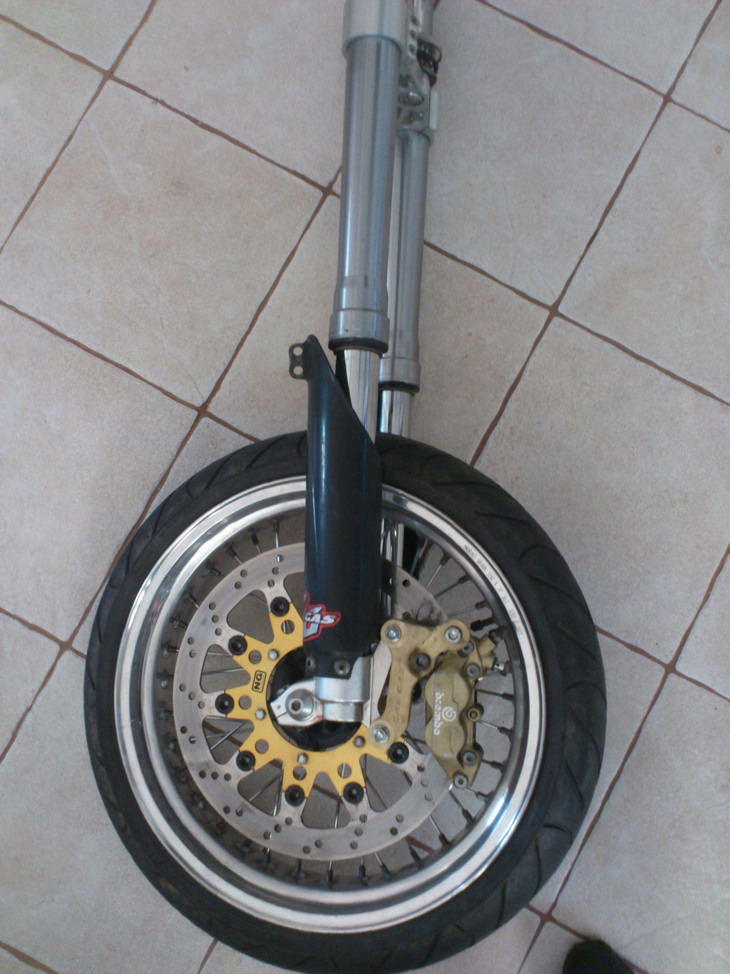

Hi, I've recently broken a 450 Gas Gas with 45mm Mazorocci upside down forks, 17 inch Supermoto wheels, 320mm disc and 4 pot Brembo caliper. I can't help thinking how sweet they'd look on my Baghira. I'm sure resprung they'd work well and it would sort out my wooden brake problems. I have a friend that works in a machine shop and I'm sure he could make me a steering pin if required.
Any tips on the conversion or if they would be suitable for the job would be much appreciated.

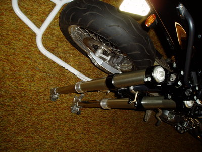

Postby malachi » Mon Oct 15, 2012 4:16 am
these are the one's on mine think they are ccm but maybe wrong
