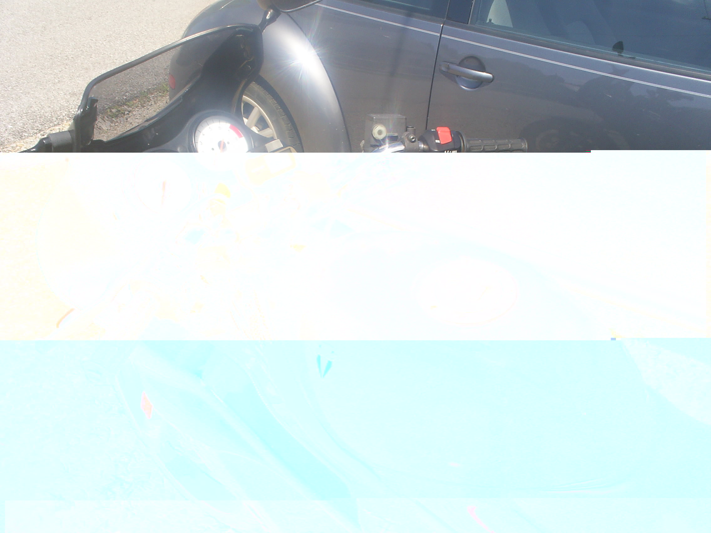

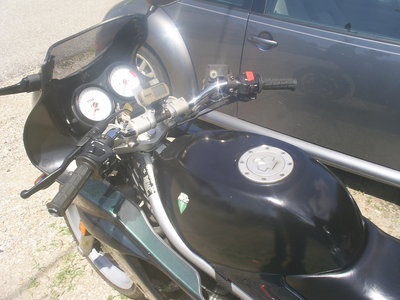

Postby DAVID THOMPSON » Mon Nov 05, 2012 7:16 pm
this is mine after a day changing things
not a big fan of mods but for me the low bars did not work very well
looks a bit different now i did a change so the gps mount hides the piece of gas pipe holding
the bars in line
bars are from 95 Saxon Tour they had to be cut so the T mounts would fit
would love to have a top tripple clamp with regular bar mounting holes
as this set up is better but still way to wide
click on picture for bigger view
once makes it bigger 2 times makes it real big
daves bike after handle bar change
