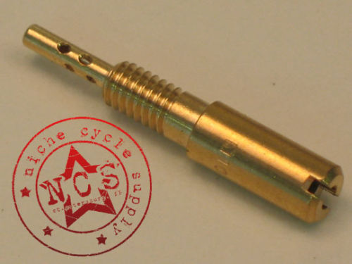

Just in case anyone else is having a hard time getting the Teikei #50 pilot jet for their 660, I found an alternative Mikuni jet that is readily available. The VM28/486 #40 screwed right in and made my Skorpion the happiest it's been since I've owned it. I can't believe I've been driving that thing around for about 8500 miles now with a sluggish low end and popping overruns. Why the #40 Mikuni runs richer than the #48 Teikei I have no idea. Maybe it has something to do with the slight difference in design but it works great for me and can be ordered or purchased at almost any cycle service center in the US. My local Yamaha dealer had one in stock. :smt020 It cost me $40 worth of gas in the old Econoline to find the damn thing but at least my bike runs again.
Don't attempt to drill out the stock #48 unless you know exactly which size bit to use and/or already have a backup plan. I guessed wrong. :oops:
Here's a pic of the Mikuni. It's much longer and not as fat above the threads but works like a champ for me.

Nice work! I, too, was driven nuts by the erratic snatchy behaviour at low rpms, and reamed the pilot jet with a needle. That, and one notch up on the primary needle, transformed the low end behaviour. I now have the skorpion 3 years and expect to keep it for many more.

edfmaniac wrote:Just in case anyone else is having a hard time getting the Teikei #50 pilot jet for their 660, I found an alternative Mikuni jet that is readily available. The VM28/486 #40 screwed right in and made my Skorpion the happiest it's been since I've owned it. I can't believe I've been driving that thing around for about 8500 miles now with a sluggish low end and popping overruns. Why the #40 Mikuni runs richer than the #48 Teikei I have no idea. Maybe it has something to do with the slight difference in design but it works great for me and can be ordered or purchased at almost any cycle service center in the US. My local Yamaha dealer had one in stock. :smt020 It cost me $40 worth of gas in the old Econoline to find the damn thing but at least my bike runs again.
The pointy end of this jet would hit the carb body. Shave it ~2mm and its a perfect fit.

Postby edfmaniac » Mon Nov 19, 2012 5:06 pm
You could do that if you think it's necessary but mine has been working fine installed as is. There's an old saying I was brought up around, "If it ain't broke, don't fix it!", and mine ain't broke. LOL
