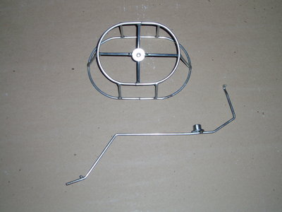

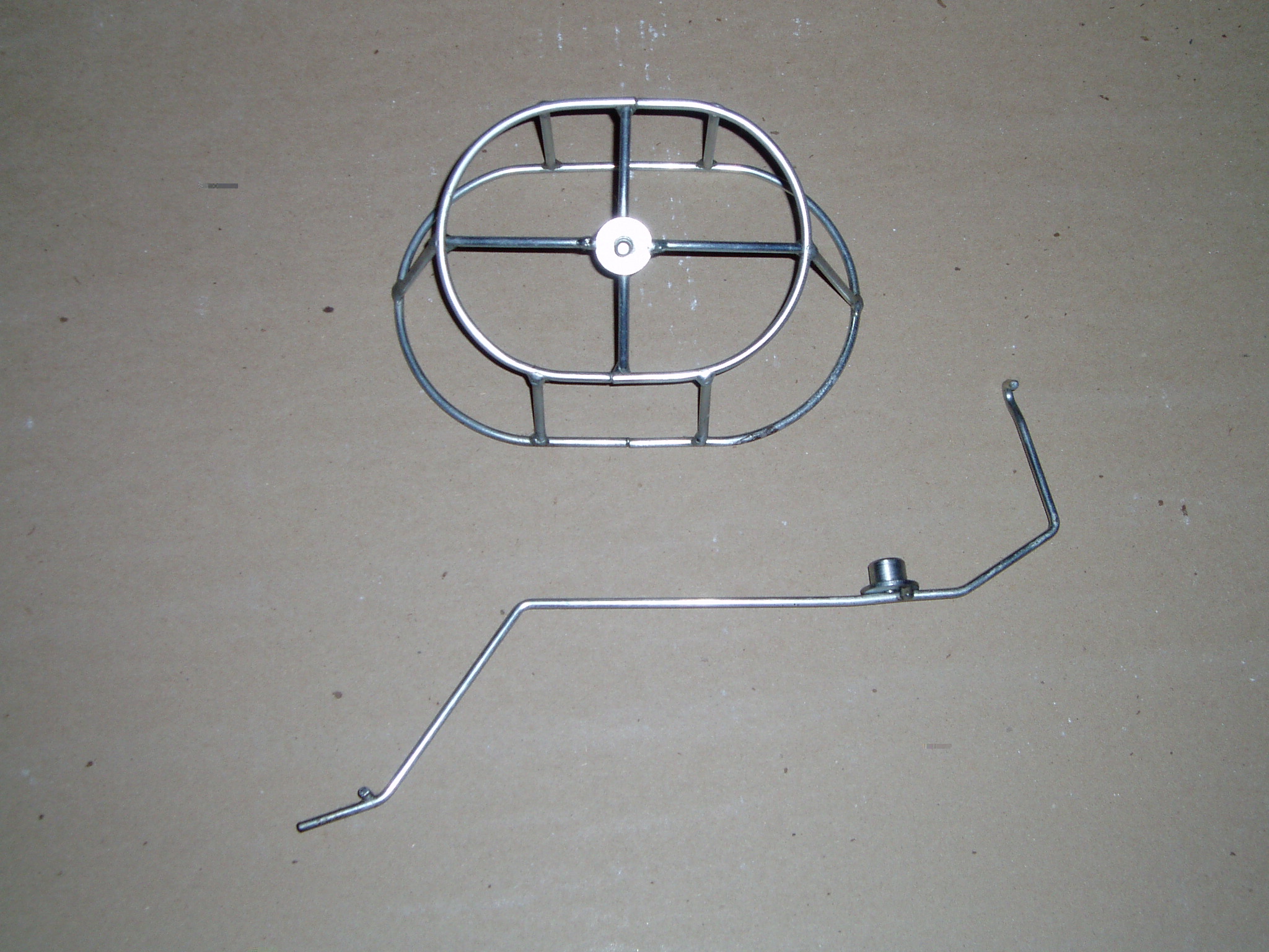

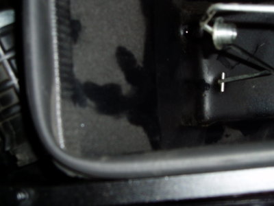

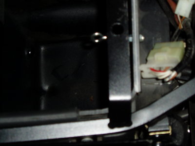

Postby malachi » Sun May 12, 2013 8:53 am
here ya go

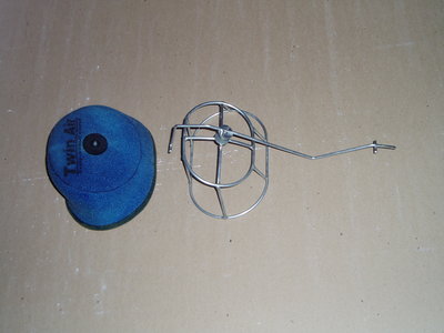

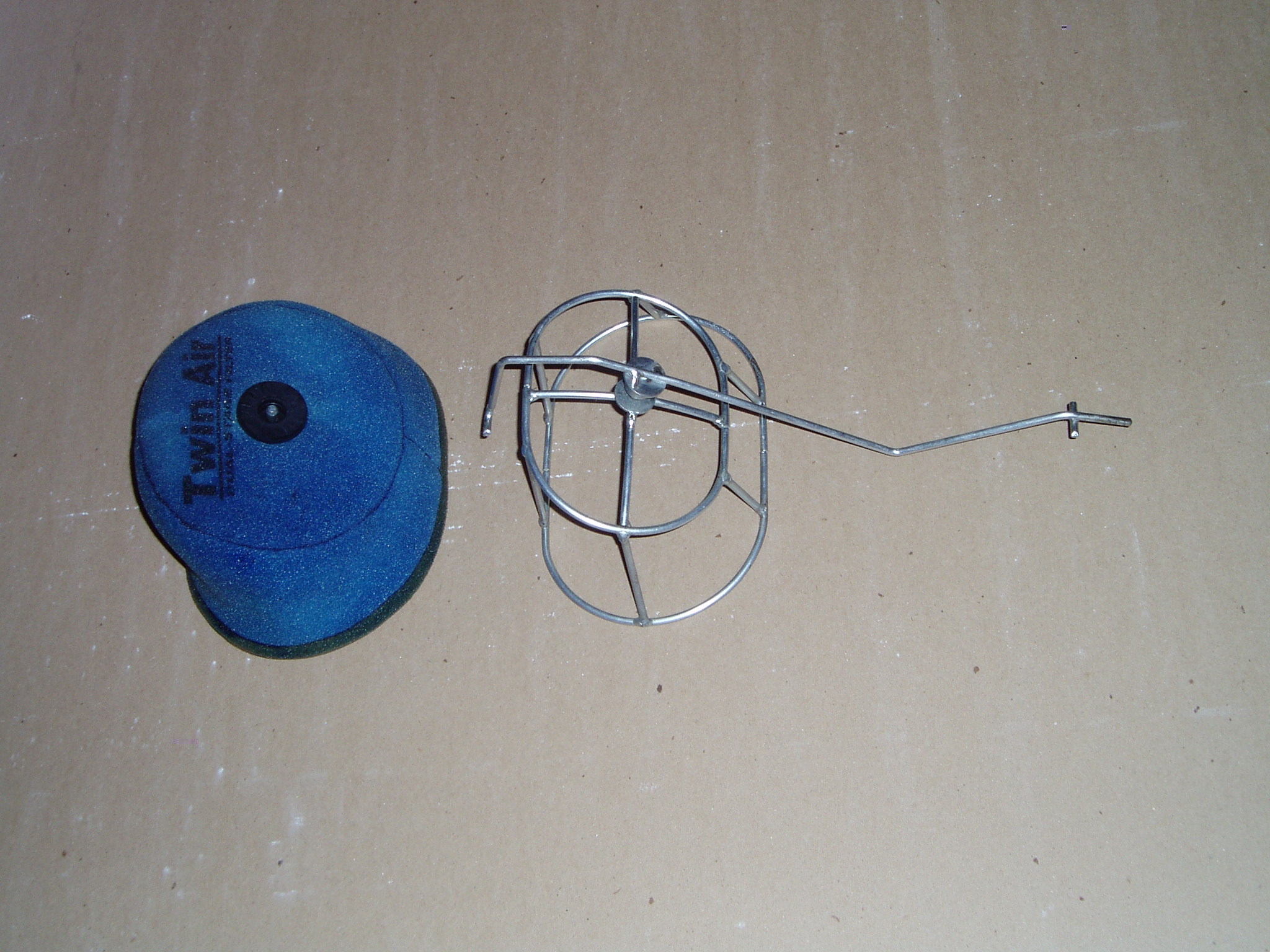

Just to add a thought and some more pictures.
The filter is used by ktm so it would stand to reason that the filters support frame might be also.
If you look at the top of the rear mud guard, where it attaches to the rear of the air box you'll see KTM and made in Italy...

Postby OLDMTNCARVER » Sun May 12, 2013 9:46 am

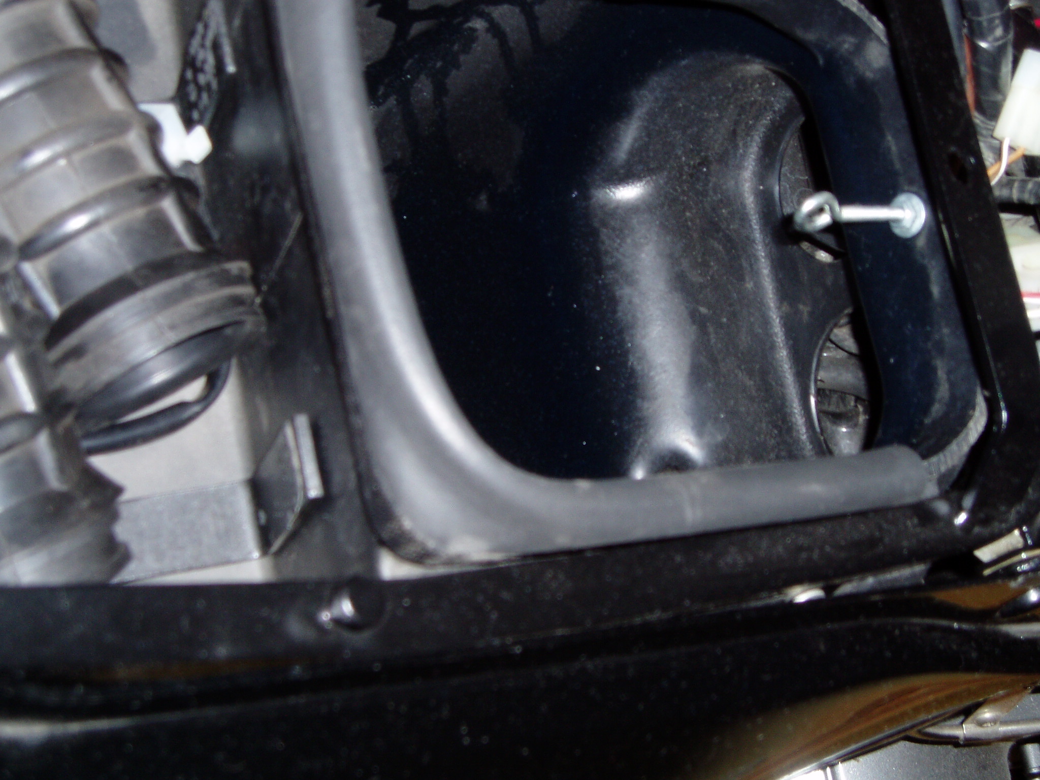

Placement of the filter and support is managed by a recess / recepticle at the bottom rear of the air box and the top hooks through the eye bolt supported by a by a nut and washer on one side and a nyloc and flange on the other.

Postby OLDMTNCARVER » Sun May 12, 2013 10:06 am

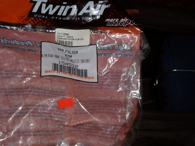

Purchased from my local KTM dealer.
The same as Edec on the first page of this thread, shared the numbers.

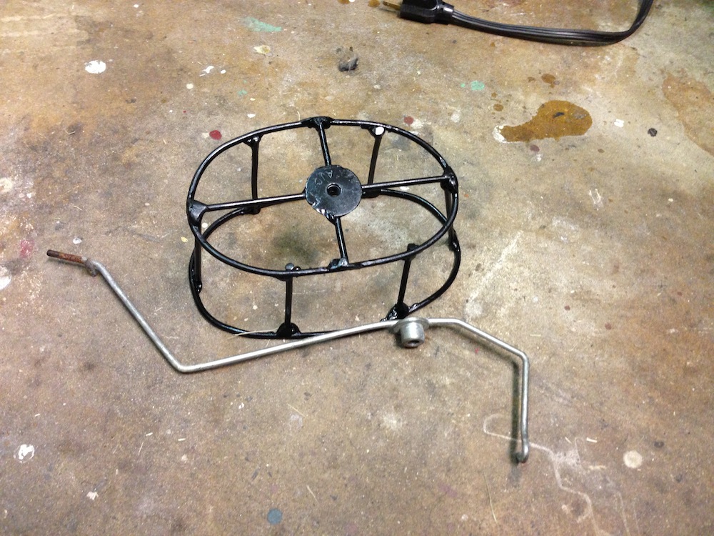

Postby Lifeislarge » Tue Jul 30, 2013 8:19 pm

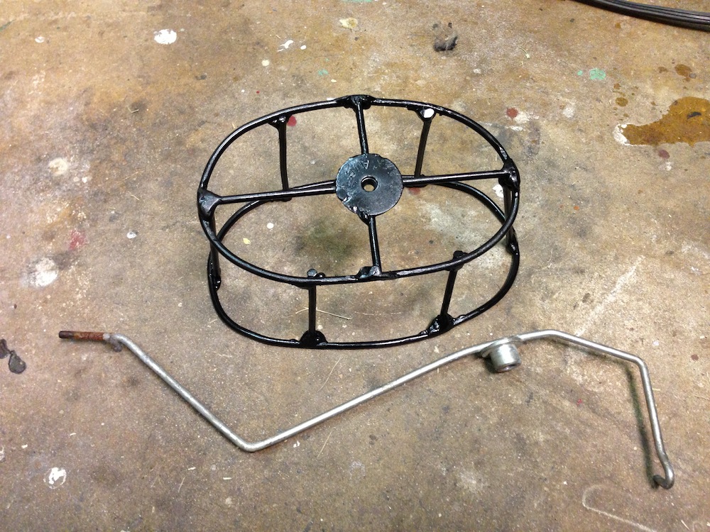

So I finally got sick of trying to find the elusive air filter cage and decided to make my own.
I only had pictures from this thread to go by but I think I was able to produce a reasonable facsimile.
I guess that I'll find out once I procure an air filter. The pics don't show it really well but I did build in the slope although in looking at the pics again I think the top oval is a bit bigger than the OEM. I may end up doing it again as I made it really quick and the welds are ugly. Or, who cares....
