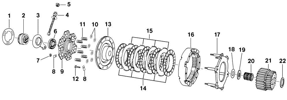

sounds like the clutch basket may have lost some fingers ( the tabs that rub against the clutch plates)
after looking this is different than i am used to seeing
item 17 the studs hold it together along with i think item 7 a nut
if one of those studs cames loose
you have a problem as it compresses the springs
it appears to be a simple engine and clutch
a fast strip down may give you time to get parts saturday
