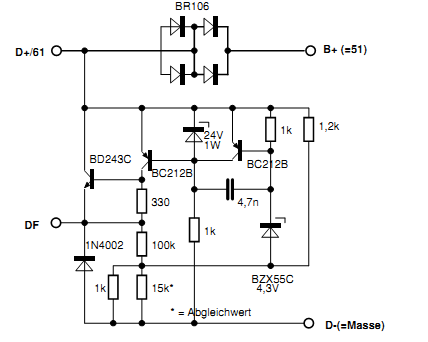

I replaced the mechanical regulator with this style electronic regulator: http://666kb.com/i/b1kr05gnftjhtuog9.jpg

Here's the 'elektronikus' style electronic regulator schematic. Actually a neat little circuit, really, despite being a bit crude. Not well designed for the 'dirty' environment of a motorbike. The principle is good, though. I replaced the 15K resistor with a 10K variable so I could tune the cutoff voltage.
I learned the hard way that these electronic regulators don't need the field-coil damping resistor - if you leave it connected, it'll either burn out or the regulator won't work properly.

thanks the road map always helps
that resistor in the original was some times a bulb.
the wrong bulb can really make things work funny
this thing also needs a home in a cool spot not stuck in the engine or headlamp shell
lots of air and no water
bottom left that in4001 could probably stand to be something a bit sturdier there is a whole series of those some are a bit more rugged
in some circuits 1n4007 1n4009 come to mind
and the strange way br106 is drawn
i am use to seeing it drawn like this
(edit) after some head scratching i think i understand what there doing
