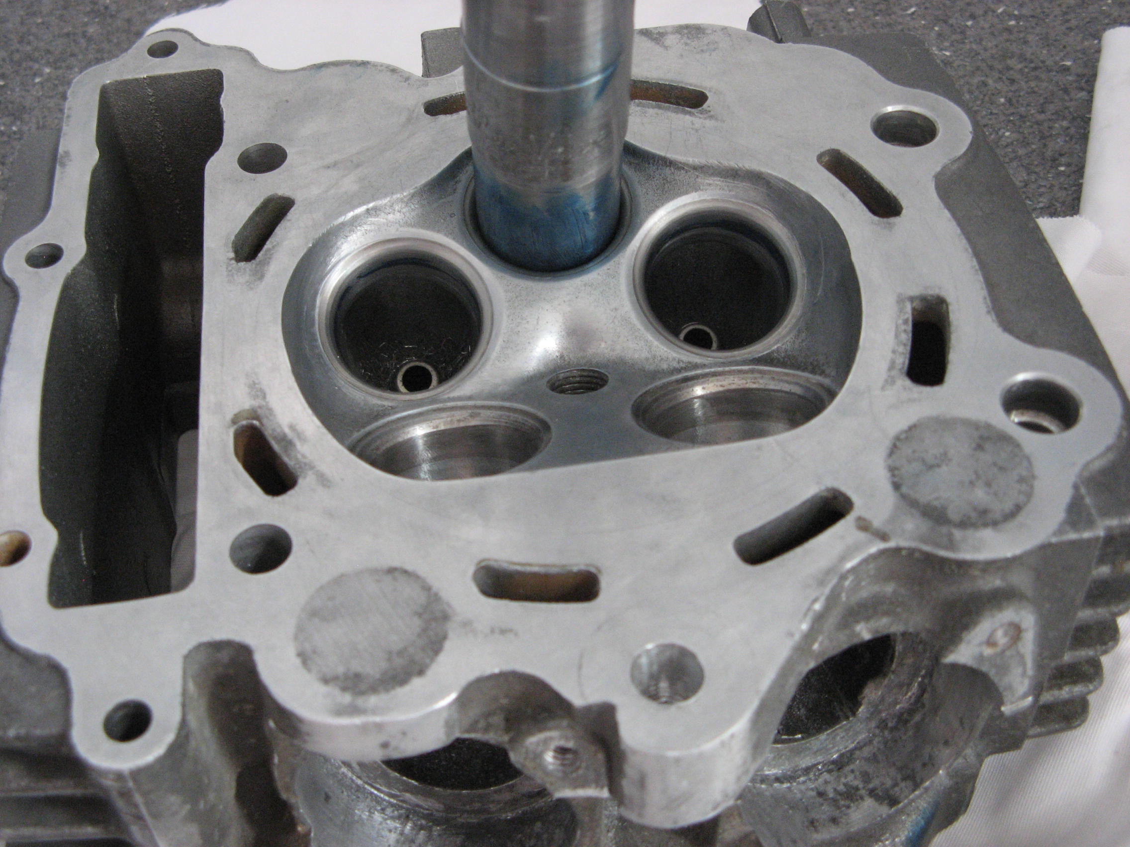

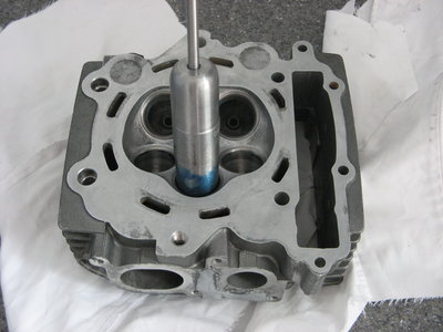

A little more progress. The inlet throats to accept the oversize valves are getting there slowly.
My blue'd up test plug
The blue "witness" marks showing in the throats

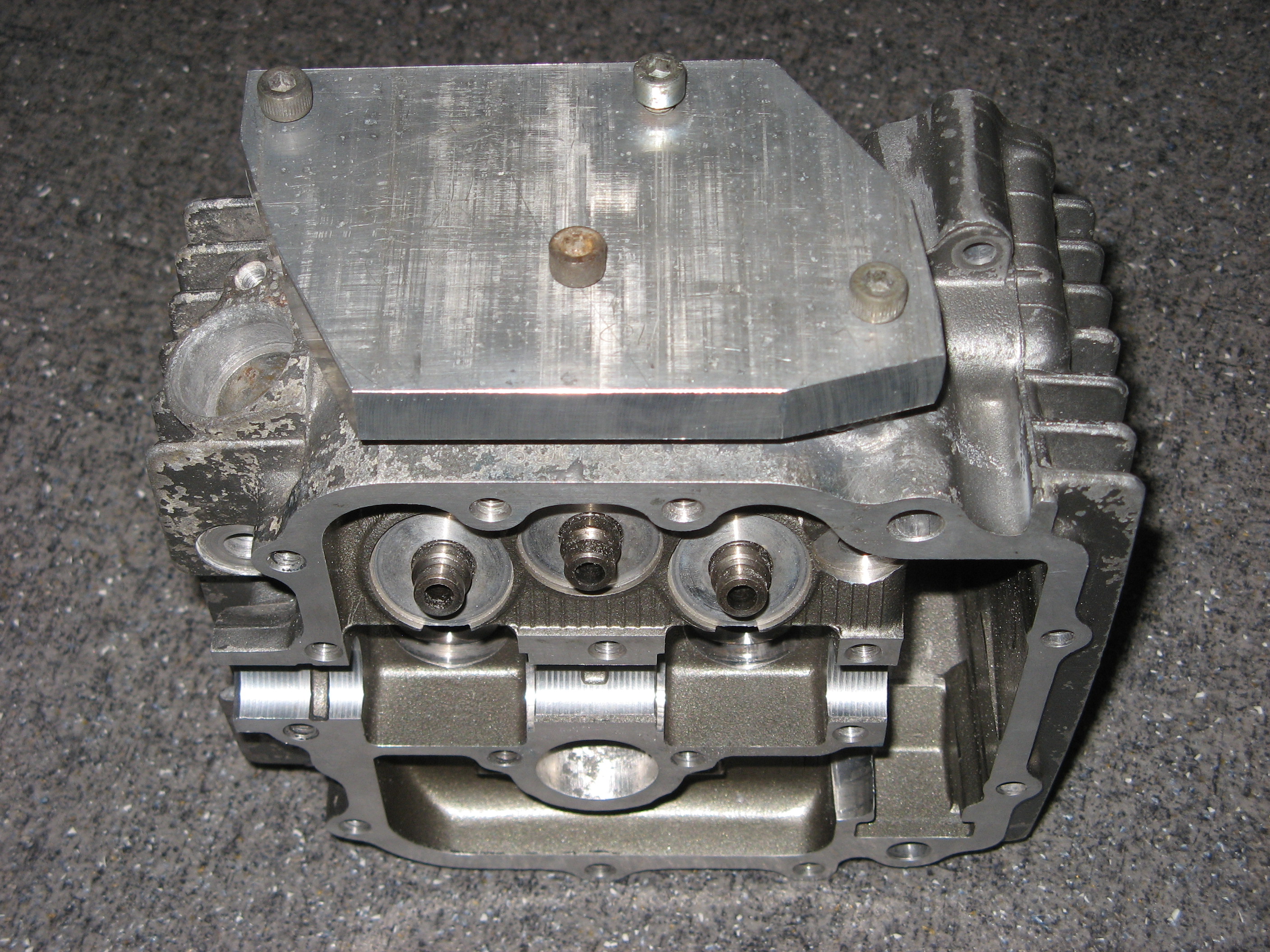

Postby sanddune51 » Mon Jul 07, 2014 8:02 am

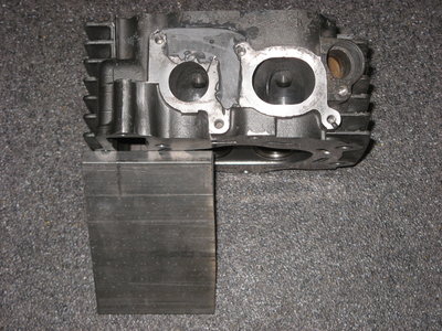

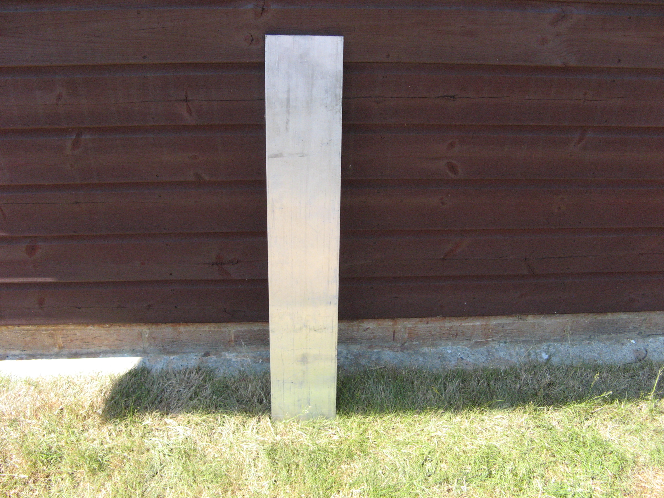

Found a piece of aluminium in my workshop 6" x 3/8" (150mm x 10mm),that I hope will prove ok to make an inlet adaptor from.
It was slow work to saw (by hand :lol:) a piece off for the job. Also used "JB Weld" to fill and reinforce the area above the small inlet port. I will tidy it and ensure the face is flat later.
Mark.

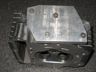

Postby sanddune51 » Wed Jul 09, 2014 11:35 am
Have roughly shaped the inlet manifold adaptor. I can't go very much further with it until I have decided how I'm going to mount the inlet rubbers and also the profile of the inlet ports at the head/adaptor interface.
Mark.

Postby breakwellmz » Wed Jul 09, 2014 2:32 pm
Well done.
How about clamping up a thin layer of Plasticine or similar between the plate and the head for the port profile to be impressed into, showing where you need to remove metal?

Postby sanddune51 » Fri Jul 11, 2014 2:37 pm
That'll certainly work. Might just sort out inlet rubbers and their spacing and fit to the carb before tackling the port. I think I'll make an accurate gasket and use that as a guide for the manifold adaptor.
Mark.

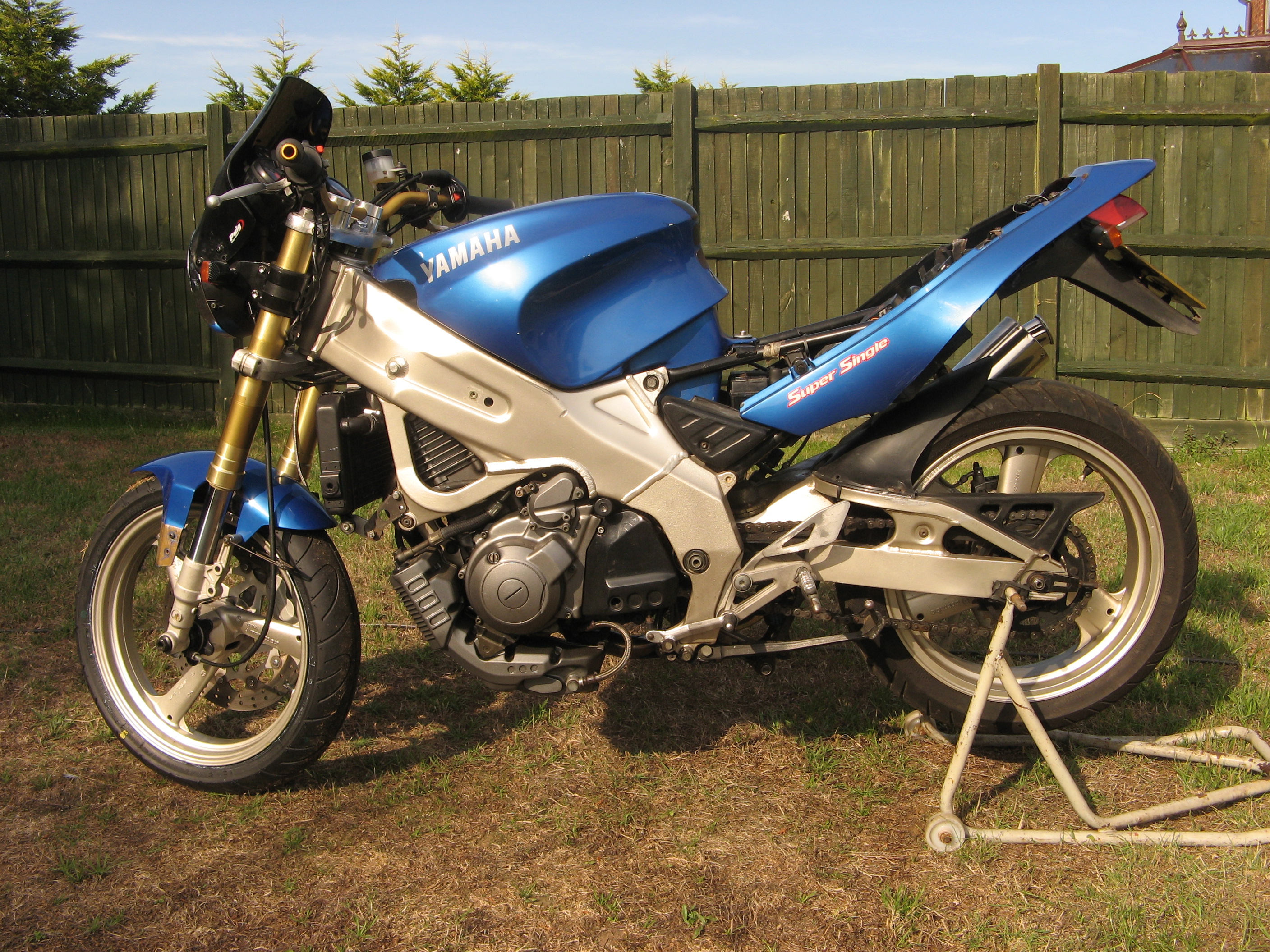

Postby sanddune51 » Thu Jul 17, 2014 11:40 am
Fork seals fitted and forks back in the bike.
Also took the opportunity to fit a nice new sticky Bridgestone BT-090.

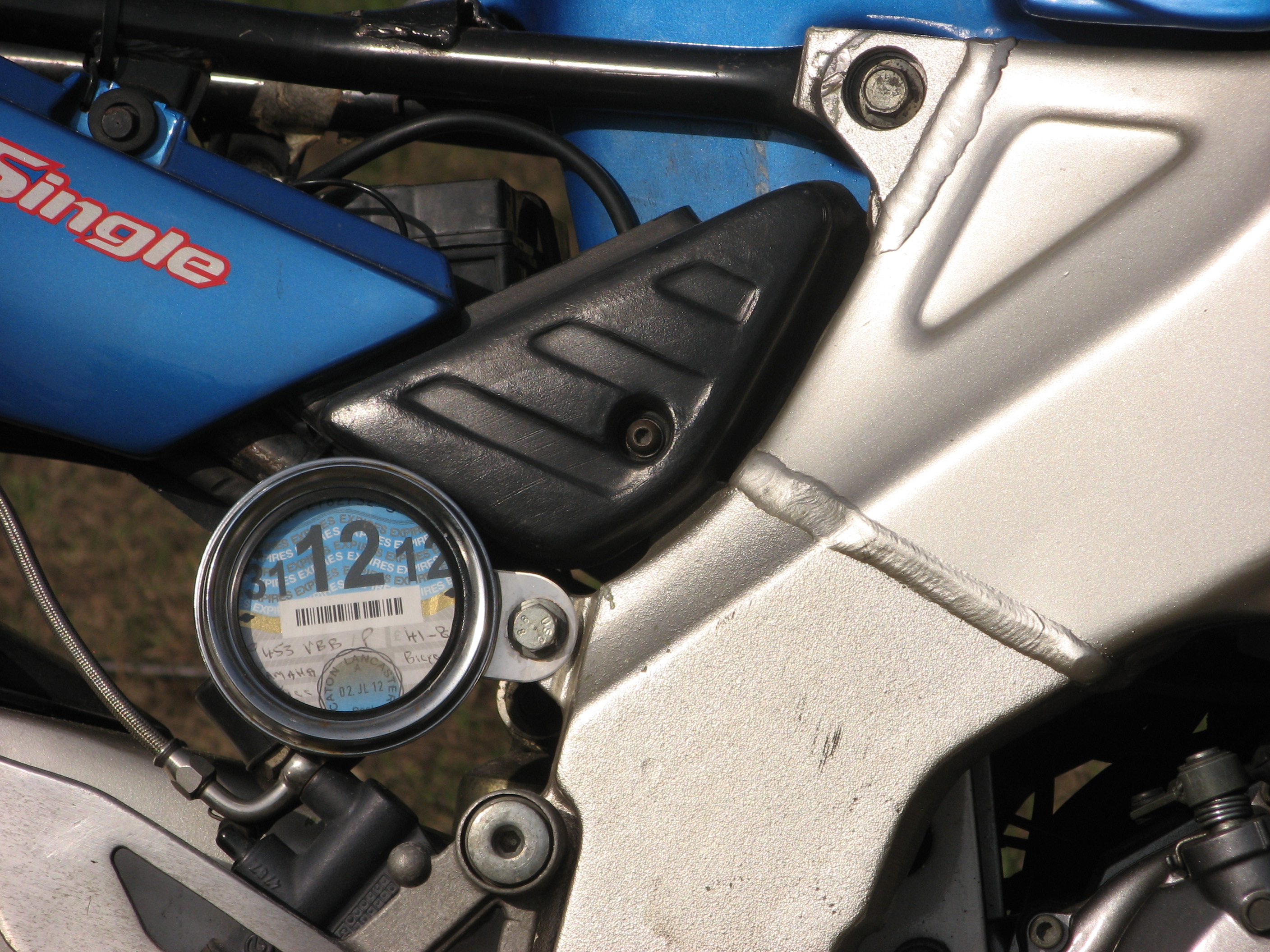

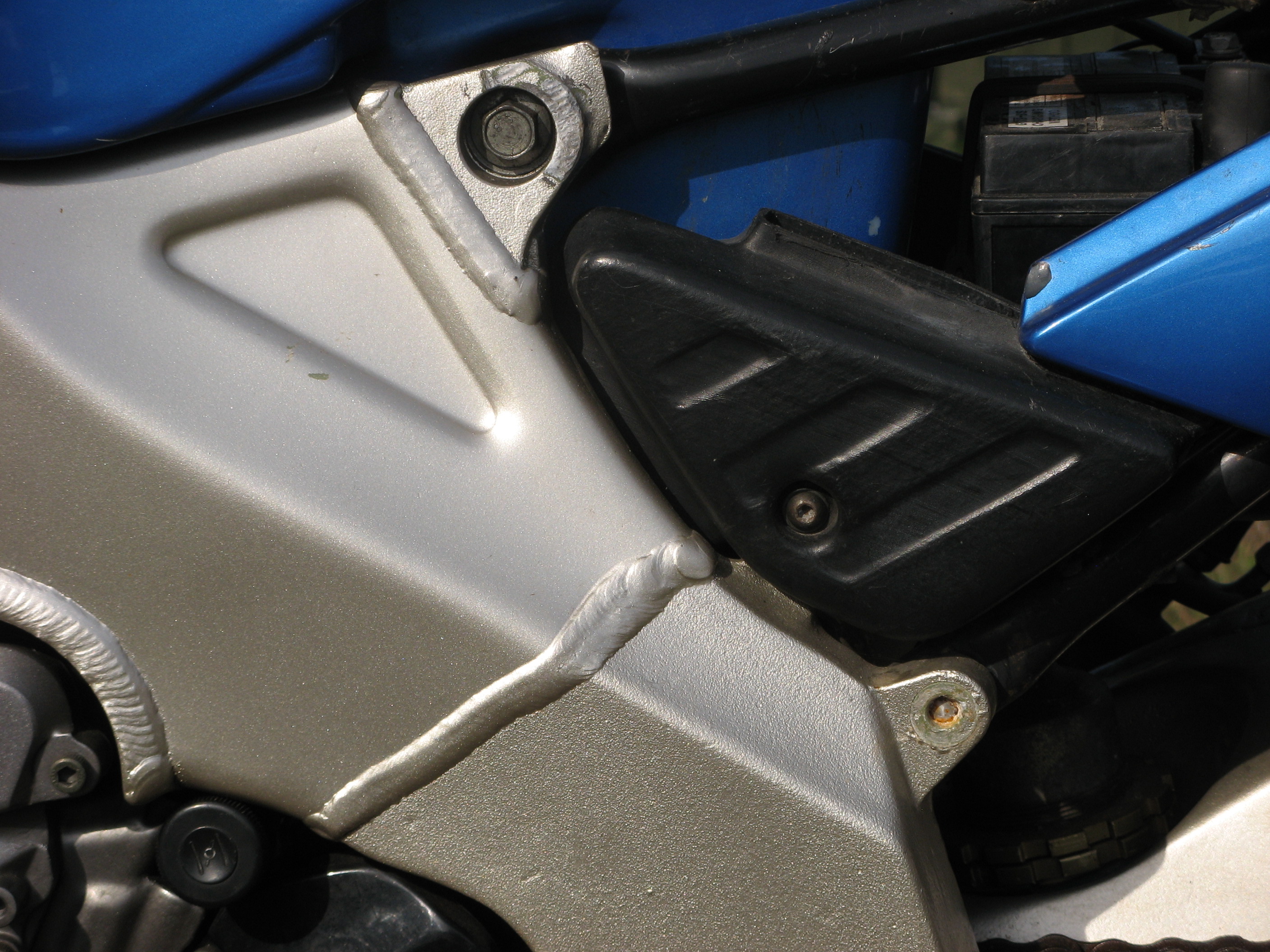

Alas have found another problem preventing me getting the bike MOT tested for the road. The numpty that fitted the tax disc holder on the right as his second choice option, presumably had the left side as first choice :(
Mark

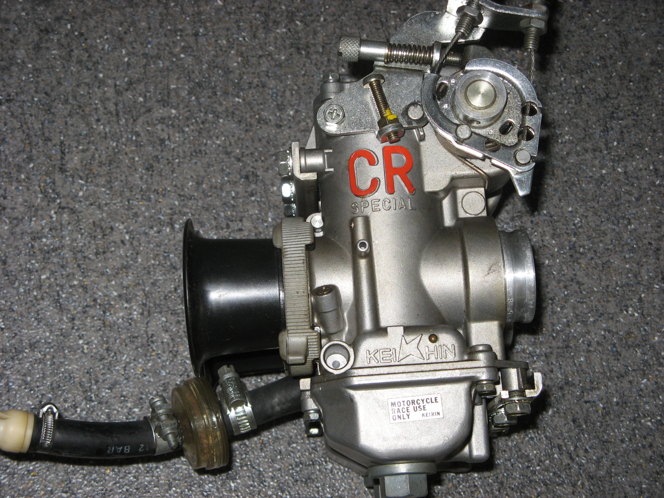

Postby sanddune51 » Mon Jul 21, 2014 2:24 pm

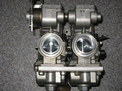

These Keihin 33's will be going on eventually. In the meantime does anyone have a lead on a pair inlet rubbers to fit the carbs? The spigots are 38mm outside diameter so the rubbers will need to be around 36mm diameter to grip the spigots nicely. Either flanged rubbers or spigotted will be fine. All the better if they come off a cheap commuter rather than a sought after racer :D

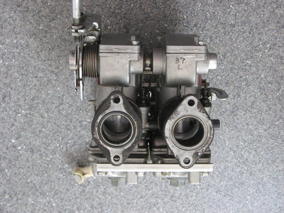

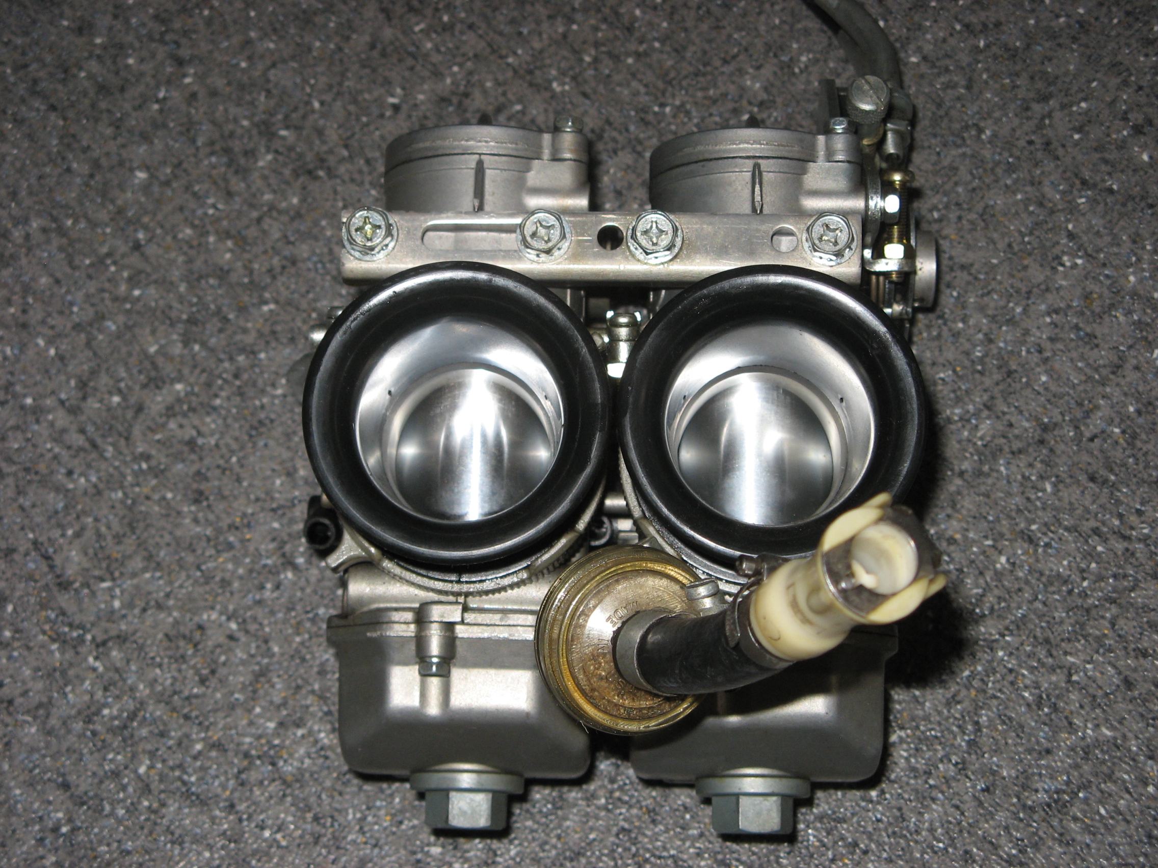

I managed to get to an autojumble (swapmeet if you're in the States) yesterday. Towards the end as sellers were packing up I chanced upon a cardboard box with assorted carb odds and sods. After a quick rummage I pulled out a couple of inlet rubbers that looked like they might be persuaded to fit my carbs. I explained my position to the vendor who very kindly said I could have them for a pound (£1 :shock:). I was so hasty in putting the coin in his hand that I forgot to have the other two identical rubbers laying in the box for an additional pound :lol:
Upon returning home I found that the rubbers indeed fitted very nicely but would require opening out to match the 33mm bores of my carburettor.
A quick trial fit.

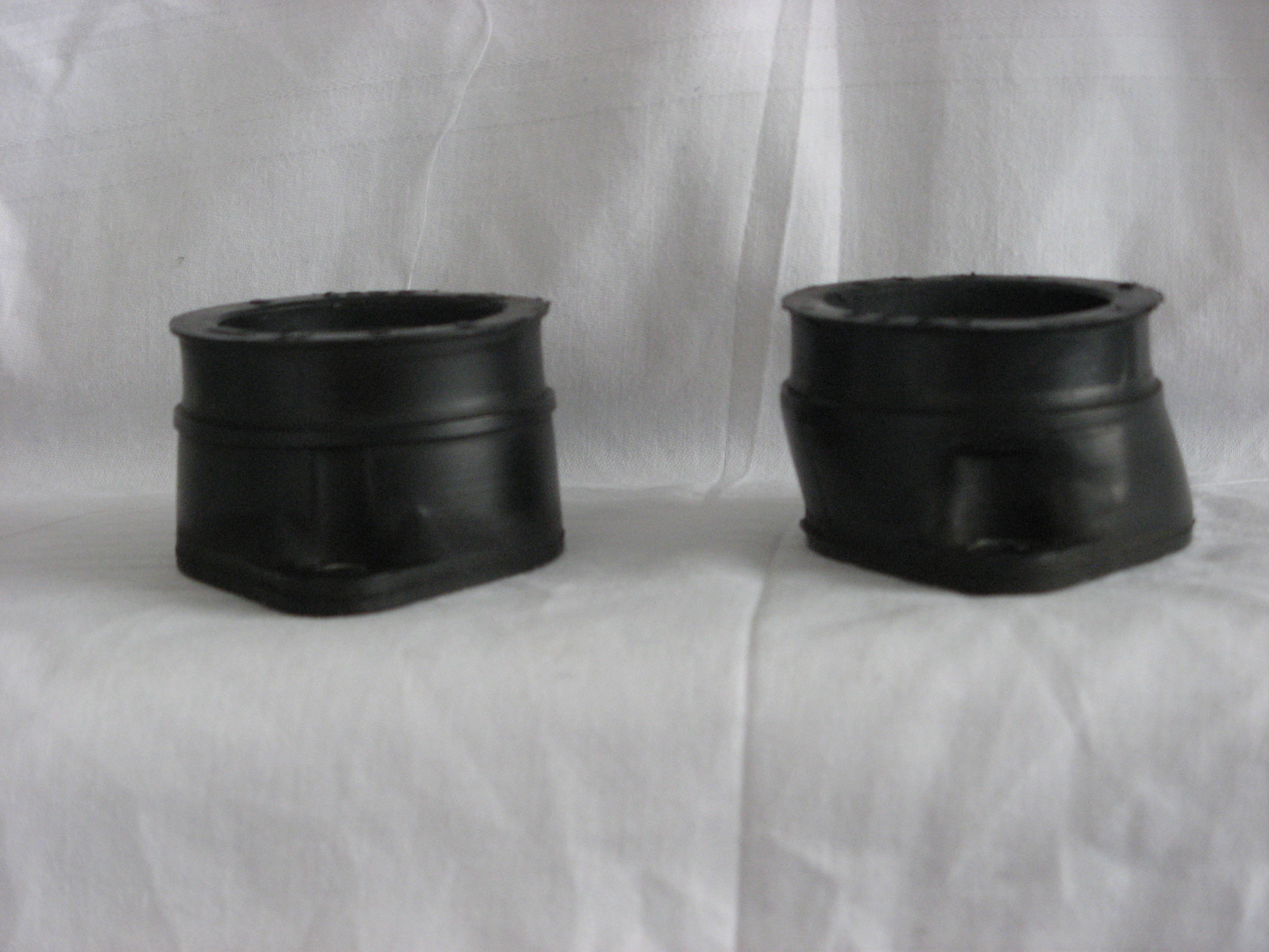

This was when I realised that I had inadvertently picked up a dissimilar pair. Probably an outer and a centre rubber from a 4 cylinder machine.
I had already asked the vendor if he knew what machine they were from, he didn't. I think I still have a reasonable chance of making this pair work for me, but, kick myself that I wasn't a little more thorough at purchase time. I think my childlike excitement at the low cost overrode the clear thinking that would have served me better....Oh well, we live and learn.

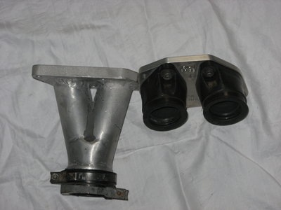

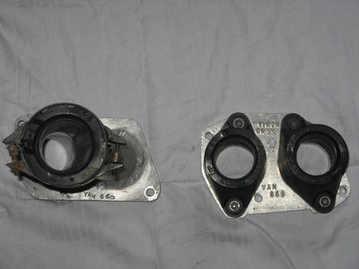

Postby sanddune51 » Sun Oct 11, 2015 12:30 pm
It's been a long time since I last updated this thread, but I have made a little more progress.
I decided I would make 2 inlet manifolds / carb adaptors. One to fit the Keihin CR33s and another to fit a Keihin FCR39, this will also easily accept the 41mm version should I ever want to.
I will post up some more later.
Mark.
