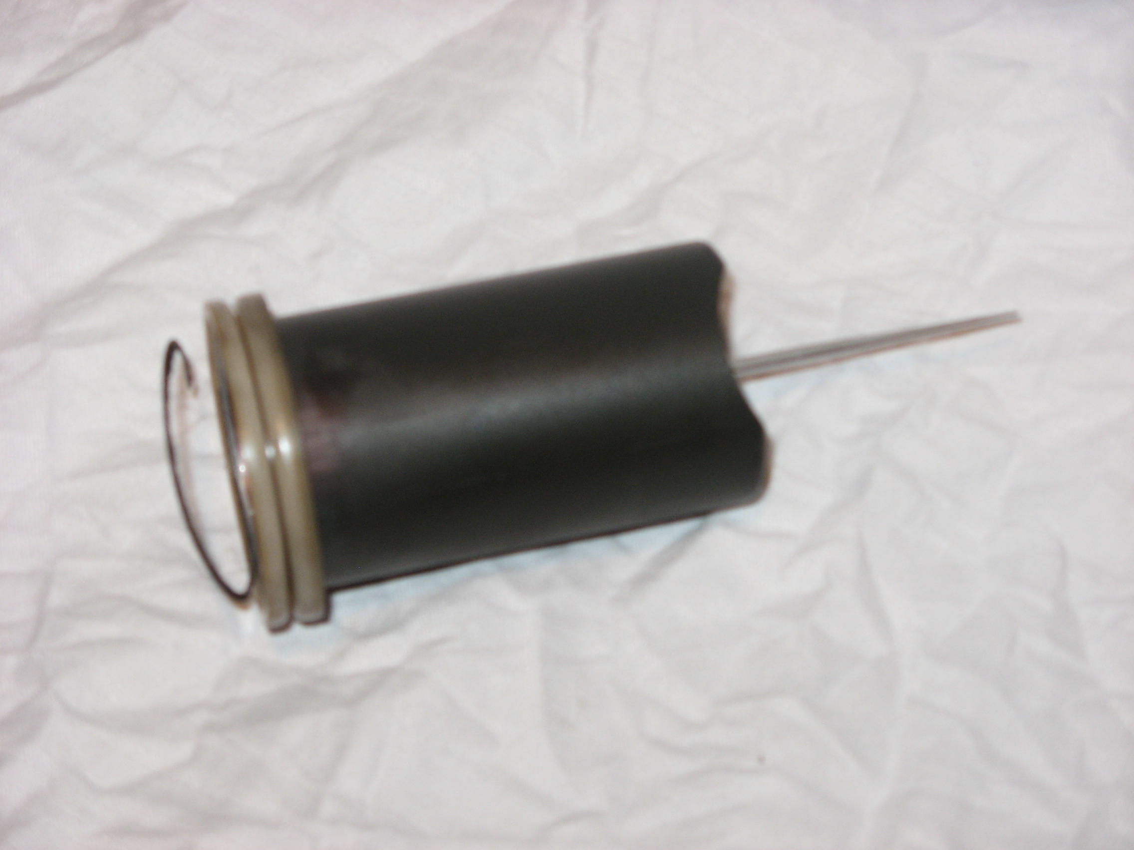

I finally found time this afternoon to investigate what I thought was extreme lean running. After spending what seemed like an eternity figuring out how to remove the petrol tank, I eventually had sight of the carbs. I fully intended to remove them cleaning and inspecting for a reason for my poor running.
Oh boy! After searching on the forum, I wasn't sure that I had to remove the airbox to get the carbs out ..... and that seemed to entail removing the seat subframe. This was all getting a lot more involved than I had anticipated.

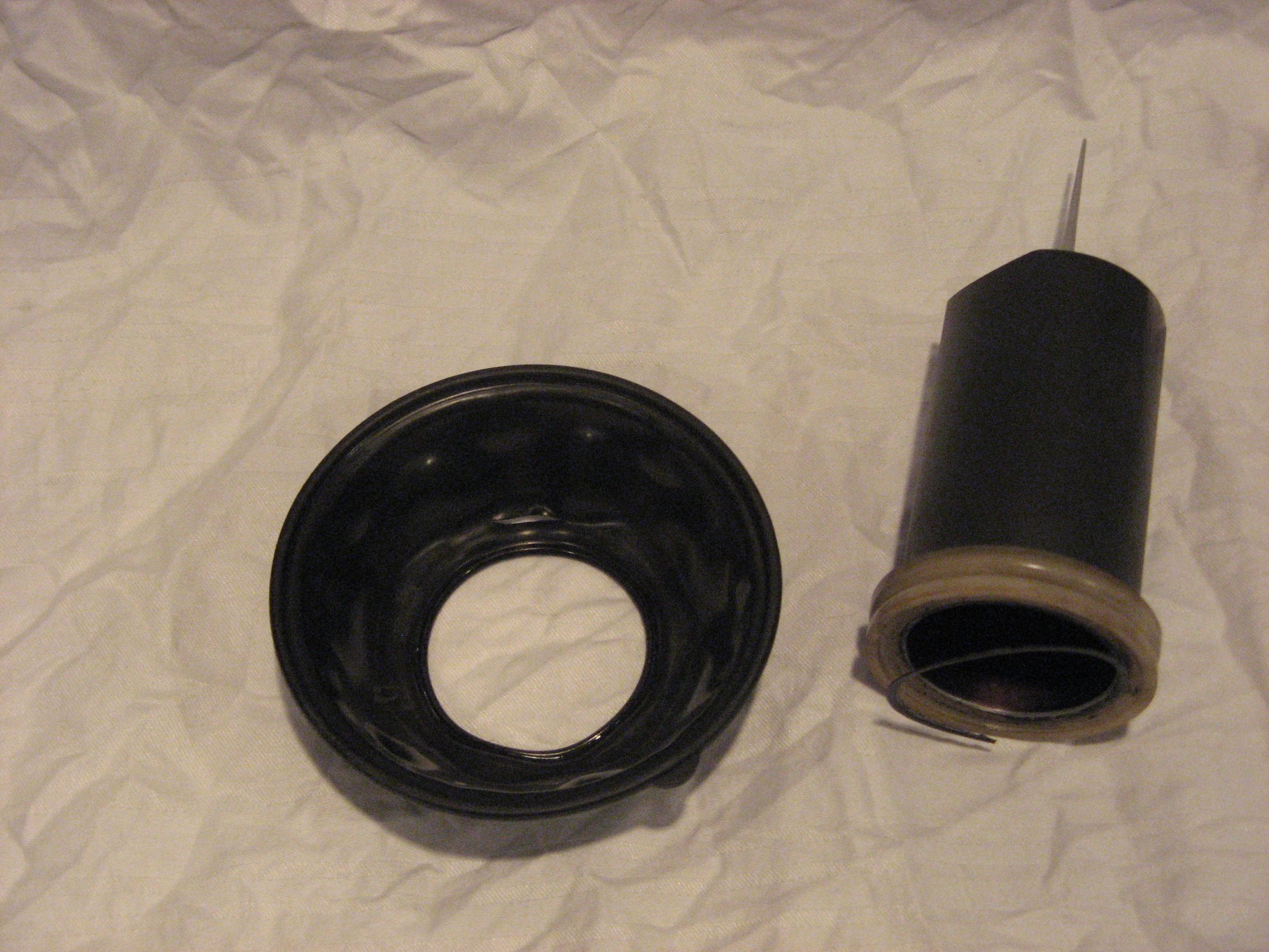

I decided to have the top off the larger RH cv carb and soon found the explanation for my carb woes.
A centimetre long tear in the diaphragm is apparent in the 12 O'clock position.
More curious was the fact that what looked like a slim spiral wound circlip was hanging off the top of the slide. I could just manage to separate the white plastic retaining rings and remove the diaphragm.
Is this correct? Is the diaphragm meant to be removed from the slide?
Looking at the Keedo website shows a diaphragm with slide at 99 Euros :shock: Has anyone managed to find a cheaper way of repairing, what is, not a great carb in the first place. Can a diaphragm be obtained secondhand from a plentiful commuter bike?
If repairing the inferior standard carbs is going to start getting expensive, then I'd rather put the money towards the purchase of Mikuni TM's or Keihin CR's.
For now I have plundered the SZR of it's slide with diaphragm and will fit that tomorrow.
Mark.

Stock carbs are good for 60hp and respond fairly well when tuned right. Unless you want to spend a lot of money on new flat slides, or spend another round of tuning trying to fix some other second hand carbs, I'd just spend the money for a new diaphragm and put he stock carb back together. You don't need to remove the airbox on the Skorpion to get the carbs out, just forcefully remove the connecting tubes between them.

The air box dont have to come out form the carbs to be removed.
You loosen the boots and shove them into the air box to the first rib.
The slide out of an xt600 is about the same I think. The xt's are plentiful in the US.

Postby sanddune51 » Mon Aug 04, 2014 4:32 pm
Thanks for the advice fellas.
I fitted the slide and good diaphragm today fro the SZR to the Skorp and although better at W.O.T. at higher rpm's, there is a huge stumble at the point of transition from primary to secondary carb.
The jury is still out for me. After experiencing the wonder of pumper slide carbs on my TRX850, I don't think I would ever be happy again with a CV carb.
Mark.

Postby zippy49 » Tue Aug 05, 2014 9:50 am
I had the same problem with my Traveller. The original carbs had sat for 8 years with fuel in them, petcock on.... :shock: They were full of scale, You'll have to replace them with better units or clean them completely. I also adjusted the crossover screw to open the secondary much sooner in the throttle travel. The last bit of stumble was due to a sticking choke plunger, it runs great now.
