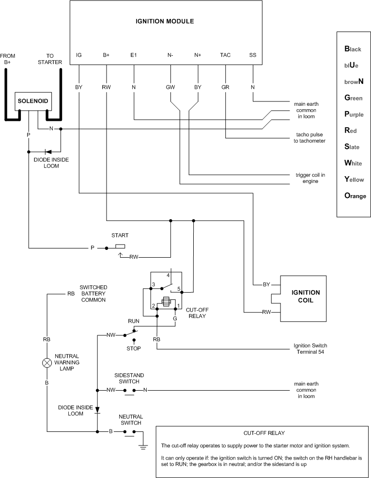

Postby DAVID THOMPSON » Fri Oct 03, 2014 3:39 pm
read about the relay 19 problem
ever thing on the bike runs through it and may be making you cut out
and here is a drawing of it
click on drawing to make bigger
if its going bad it can be buger
drawing by tony idle

Postby givusago » Sun Oct 05, 2014 6:18 am
Read through them. Thank you. There was a thread before and you suggested a halfords part that would be a suitable replacement relay. Could i have the link please. Maybe replacing this part will help. The side stand switchlooks good but if the relay is old could be faulty.bikes done 22000 miles so a spruce up may be in order.

Re: MZ rt 125 issue
Postby givusago » Thu Oct 09, 2014 2:25 am
Thanks for your help Dave.
It seemed to be the kick stand switch. I disconnected the wires from the stand and tied them together. Its been working fine ever since. :) :) :) :) :) 8)

Re: MZ rt 125 issue
Postby DAVID THOMPSON » Thu Oct 09, 2014 8:34 am
that side stand switch is easy to break
do be careful with it disconnected
and you may need to sort out something to replace it to pass MOT
friend of mine ..dealer made him put side switch back on his bike..
but he keeps A "RAT" BIKE and i think they do not want to inspect it
because he always has some thing jimmed up on it .because he treats bikes like a dirty shop rag...
