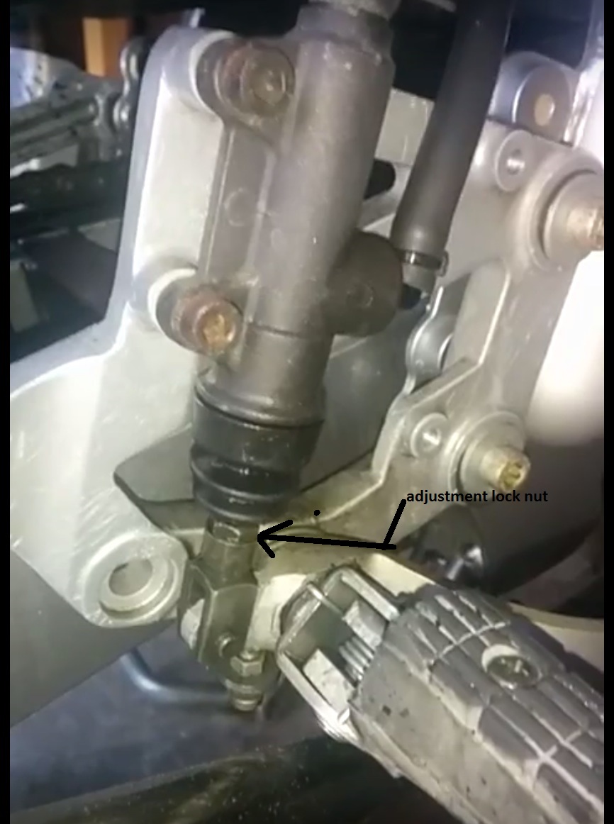

I was on the exit ramp of a highway last week when the rear brake stopped working. Luckily I was only 2 miles away from home, and the front brake still worked. The rubber hose that connects the brake fluid reservoir to the brake pedal had corroded. The brake fluid had completely leaked out.
After installing a new hose today, bleeding out air bubbles from inside the rear brake system, and filling up the reservoir, surprisingly, the rear brake still does not work -- pressing the pedal gives no resistance at all.
What could possibly be wrong? I doubt it is the brake caliper. And I believe I had bled the brake properly. Could it be the brake pedal mechanism itself? While bleeding the brake today, the interface of the rubber housing to the rear brake master cylinder (?) appeared to be very slightly leaking brake fluid with every press of the lever.
The cylinder also makes a shushing sound. Please see this MP4 video on my Google Drive share folder: https://goo.gl/KUY93e
What do you think? If it is the master cylinder, is it something that I fix or replace? If it is the latter, does anyone know the make and part number for it? Thanks again for the help with my bike.

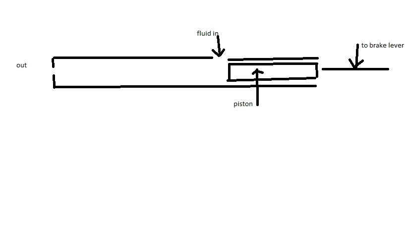

Postby DAVID THOMPSON » Mon Oct 19, 2015 9:54 pm
these are a beast to bleed
and the push rod from the lever to the pump piston can shut off new fluid from entering the pump if its pushing the piston in to far at the start of stroke
the piston must retract all the way
pressure does not happen till inlet is closed and it must open for new fluid to enter
CLUCK ON PIC TO SEE IT BIGGER

Re: 95 Skorpion Sport - a failed rear brake

Postby DAVID THOMPSON » Tue Oct 20, 2015 2:26 am
the bleeding after checking if the pedal has no free travel
pedal may be to tight at rest and not letting fluid enter master cylinder
see comment in the picture
its a bit hard to see
CLICK ON PIC TO MAKE BIGGER
