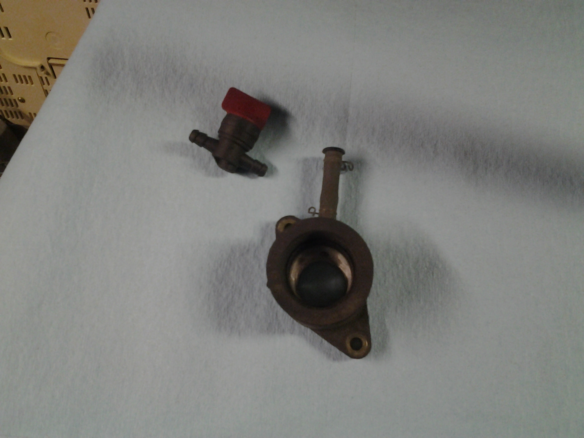

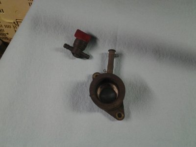

fresh gas in carbs and tank
remove tank so you can see under it
on top of the rubber piece that mounts the left Carb to the engine
at the top there is a tube that has been plugged
i have know idea what it was originally used fore
it is a direct input to the intake and has been plugged
on my bike and a spare carb set i have
it can be used to prime engine
1 gas tank
do remove the bracket from where it is fastened to frame
DO NOT UNBOLT U shaped bracket FROM PLASTIC TANK
too much risk of making a hole in the tank
these tanks are getting hard to find

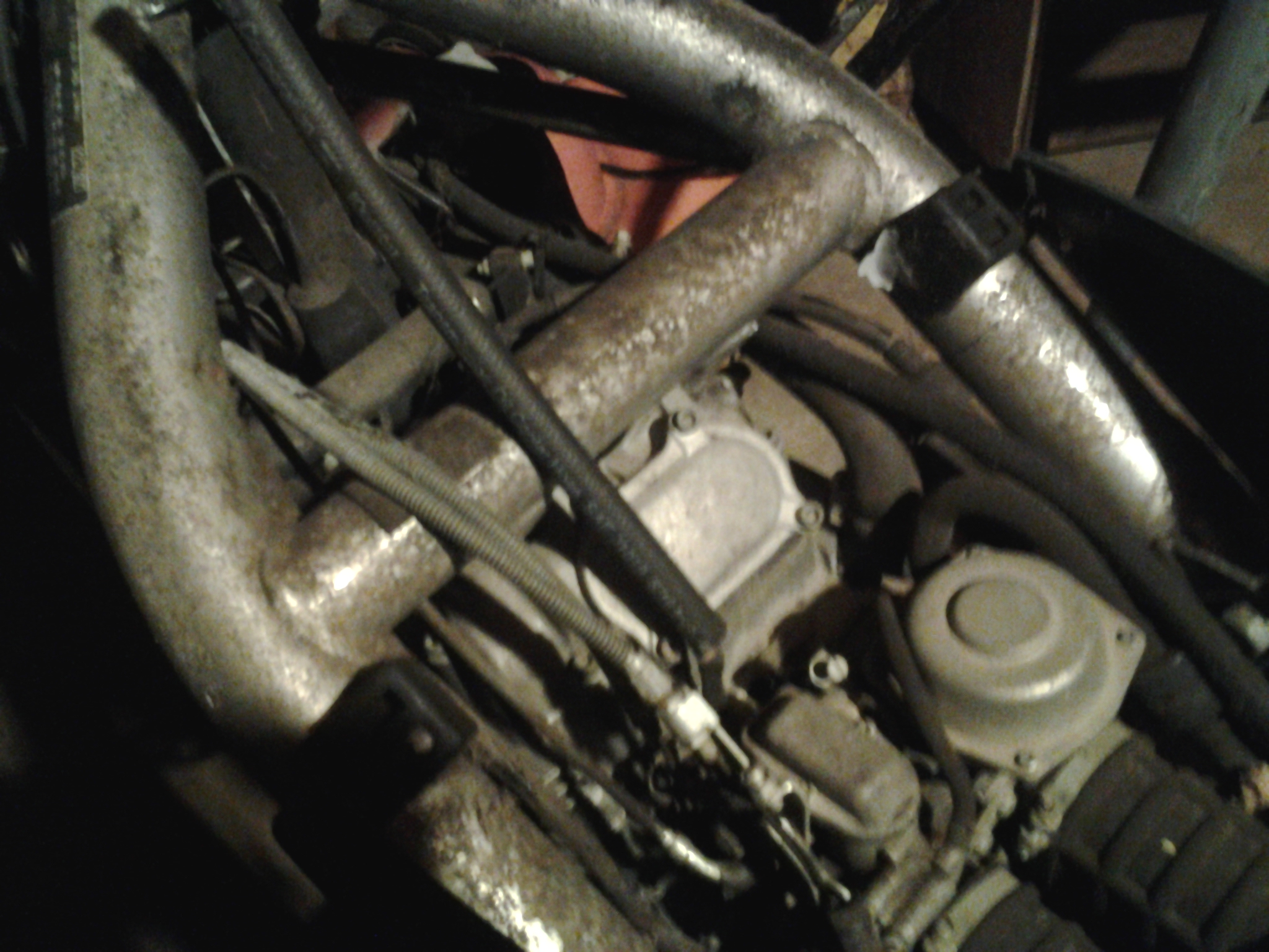

attach a hose to the intake and place it so you can access it from the front
make sure it is not kinked and add the lawn mower fuel shut off on the end
use it to add a bit of fuel to the system when it will not start
the pictures should help
do not remove bracket from tank
here is TUBE into engine location
route hose under frame tube to front
put shut off in the end and make sure it is air tight when shut off
vent location
lawn mower shut off valve and intake carb mount with tube

Postby DAVID THOMPSON » Mon Feb 20, 2017 6:22 pm
leave the shut off closed and secured where it is easy to get to without taking off the tank
it needs to be so the added fuel can flow down hill
then add a few cc of fresh gas when needed then shut tap and crank bike
when it fires do not roll the throttle on so the vacuum will draw fresh fuel into carb
may have to do it a few times to get it to go when it has been standing for a few weeks
BE CARFUL too much fuel can get you flooded or make motor over speed

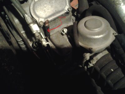

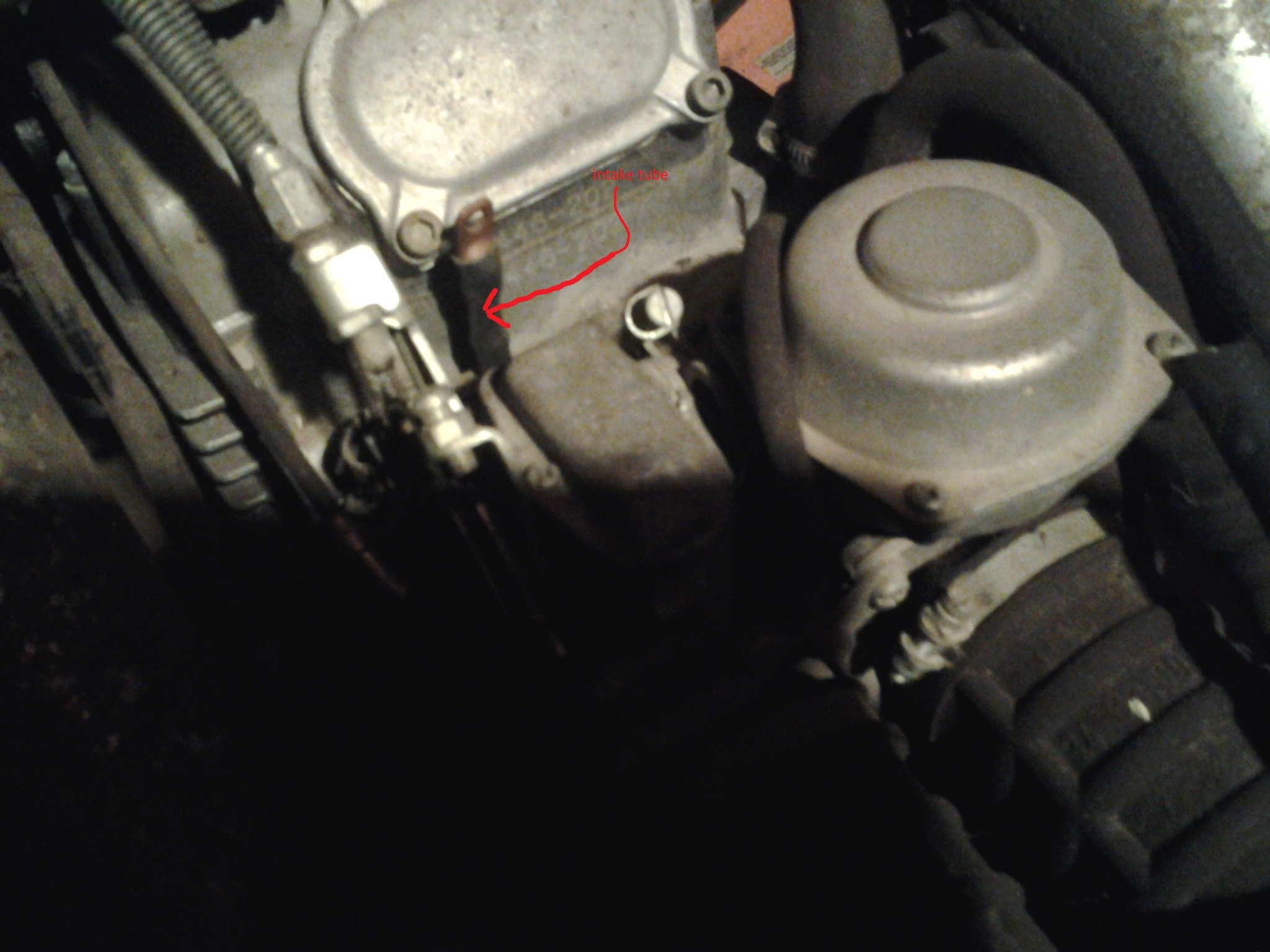

Postby edfmaniac » Thu Feb 23, 2017 2:06 am
Smaller jet goes in the carb with the bowl that feeds a single intake valve. (first pic) The larger goes in the CV carb, the one with the diaphragm, and feeds the other two intake valves. (second pic) There's a small crossover port in the head but only a small fraction of the fuel/air mix can crossover, and only from the smaller carb to the larger port behind the other carb. Here's a pic of the crossover if you are curious. I had started to clean up the ports before sending it to a professional for some major work.
Hell you may be able to get away with just swapping the jet on the CV carb if you weren't pulling the bowl off the other already to put in a proper pilot jet. The CV carb jet is STUPID EASY to swap out. I can do it in about 2 min if the fuel is drained already. It's just beneath that big ass brass nut on the bottom.
