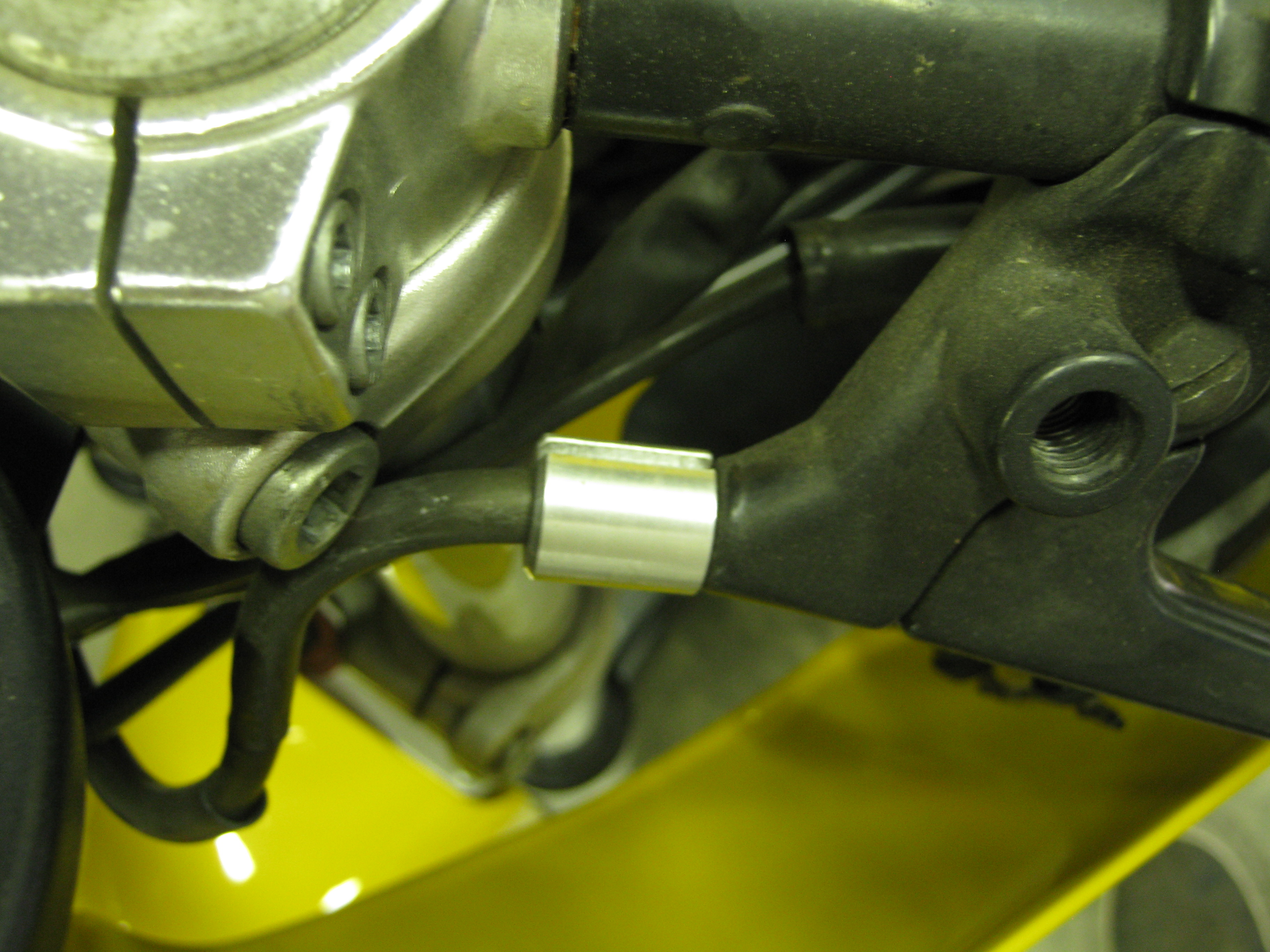

Postby jimc » Sun Jul 02, 2017 11:30 pm
A followup for the clutch cable substitution.....
see:
viewtopic.php?f=3&t=6012&p=31679#p31679
Has been working well.
Note the need for an adaptor at the lever end and resulting close fit to the top triple clamp..

Re: MZ Skorpion, Clutch cable snapped!
Postby DAVID THOMPSON » Mon Jul 03, 2017 9:29 am
now we know why no adjuster
there is no room for one
short bars were always a bad idea on a street bike
