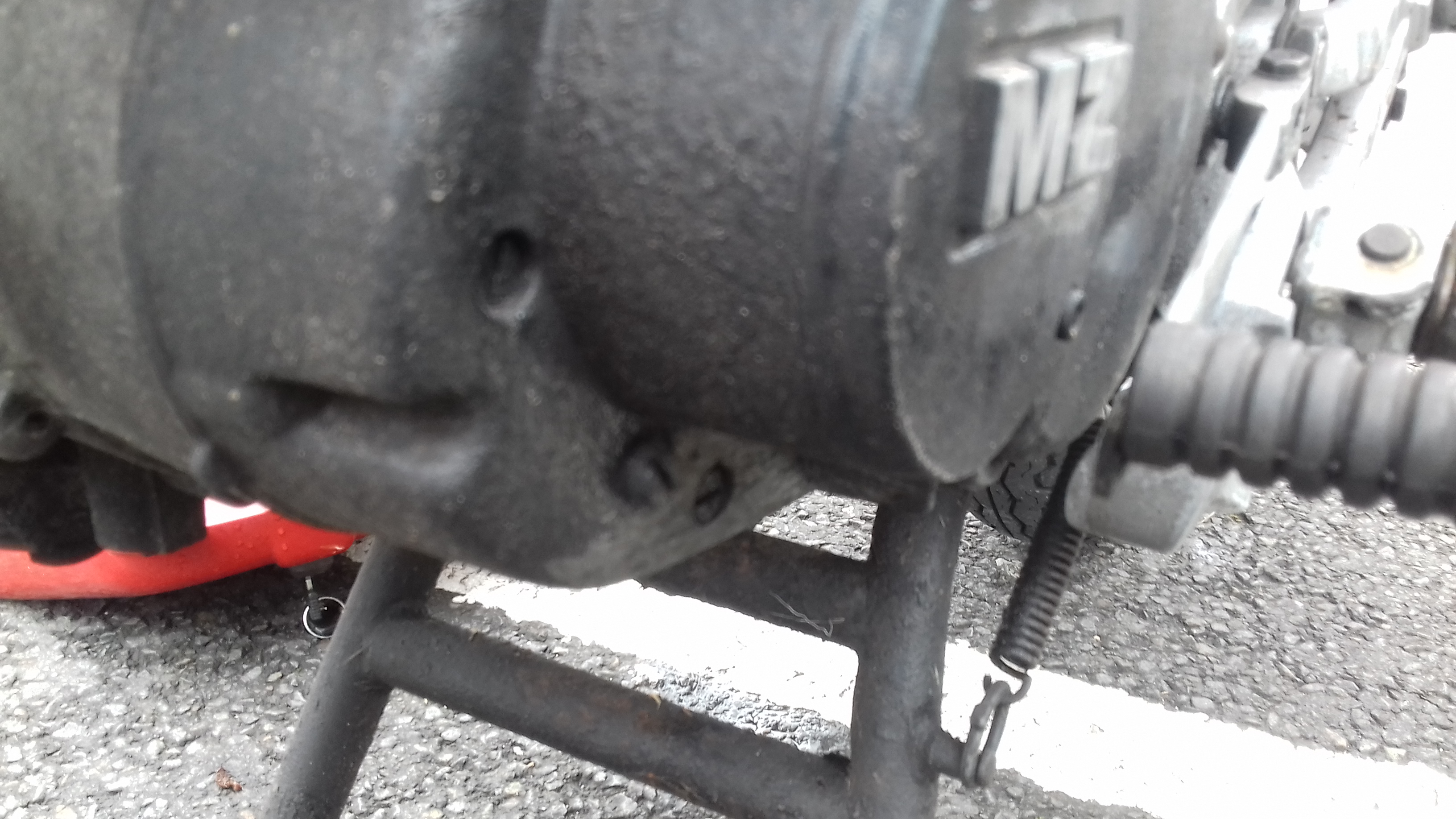

Postby Simon Mac » Mon Apr 02, 2018 8:48 am
Is it this one Puffs?
The transmission oil is checked via a screw on the left-hand side of the engine. If oil comes out it's OK.
Simon Mac
Posts: 3
Joined: Mon Mar 26, 2018 1:04 pm
Re: Etz 125Sportstar
Postby Puffs » Mon Apr 02, 2018 11:37 am
Yep,
is the one Haynes indicates for the 125/150. Total volume is just 500cc.
