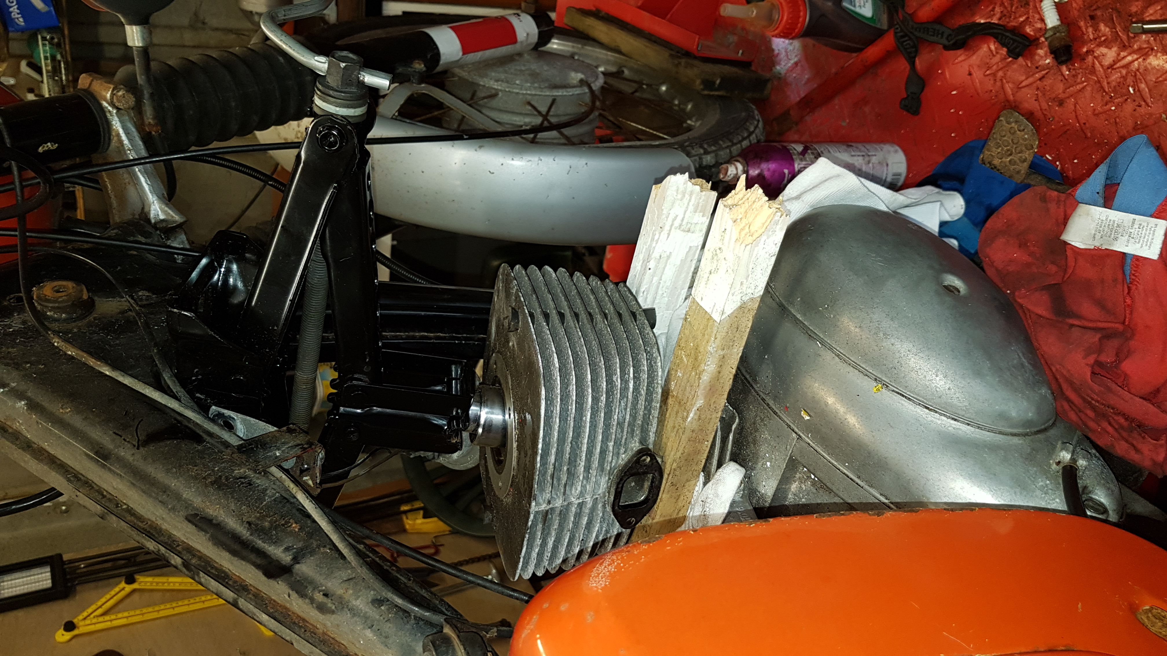

Postby shaunlacy » Sun Apr 08, 2018 5:46 am
got the scissor jack off my Landrover and created a screw - still no movement, blanked inside the barrel with a wooden insert so as not to damage barrel & piston!!!! AAAAAAgh!!!!
Properly seized

Re: Piston Seized in Barrel
Postby shaunlacy » Sun Apr 08, 2018 10:58 am
Broke Jack! other half furious lol! oh well, next idea . . . . .

Postby dirtsurfer » Sun Apr 08, 2018 7:54 pm
I would have thought something else would give before your jack broke. Whip the engine out of the frame and start pounding. Tell her you love her
Postby Puffs » Mon Apr 09, 2018 4:30 am
I too am baffled it was the jack that failed first. I would expect the frame to go first, and at least be bent in some odd way. Or the bridge in the barrel below the inlet. Anything...
Those blocks of wood could be 2", so close to 58mm: are you sure you're not at TDC? If you want the piston to move, the crankshaft should be somewhere mid stroke, best roughly half-way between BDC & TDC.
Suggest to spray WD40 onto the piston through the inlet, and from any other side you can reach it. Support the barrel on something suitable (mid stroke), best below the overflow ports at the sides (the bit below the inlet channel is weaker), making sure it is supported evenly at all sides, and straight. This to prevent bending the conrod, although that might already be bent after the exercise with the jack. Then heat the barrel, cool the piston & hit it. Or load the piston as outlined earlier.
Do you have any idea why the piston is stuck this way? Is it just corrosion, or is there maybe some other mechanical reason? If it's corrosion, how bad does the lot below look? Big-end & main bearings still OK? If you need to replace those anyway, no point in pussyfooting & consider to sacrifice the conrod. At any rate, that seems preferable over bending the frame. But before you do anything drastic, think carefully.

Postby shaunlacy » Mon Apr 09, 2018 10:27 am
Hi, definitely not TDC, it dropped about 3/4 of an inch onto blocks, If i thought I could get e replacement barrel I'd cut it off but they look rare as rocking horse .....
That jack lifts my Landrover, so at least two tons of force applied before it buckled . . . scratches head . . .
Postby dirtsurfer » Mon Apr 09, 2018 4:00 pm
shaunlacy wrote: . .
On the plus side just been out for a good long ride on another bike so am chilled now, will look at it later in the week!
A good ride helps to clear the mind
Can you see where the bore is scored? If so you could drill some holes in the crown of the piston close to the side. Then inserting a narrow cold chisel or use a dremel to work away at the piston and rings in the bound area :smt022
