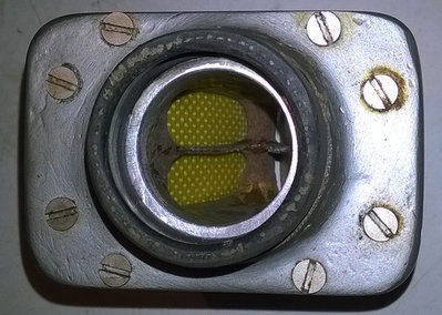

I can imagine one would use something like this:
plastic bush.png (28.51 KiB) Viewed 705 times
or thinner, but on mine it is (and as far as I can see, has always been with this manifold) just metal on metal, with a good fit.

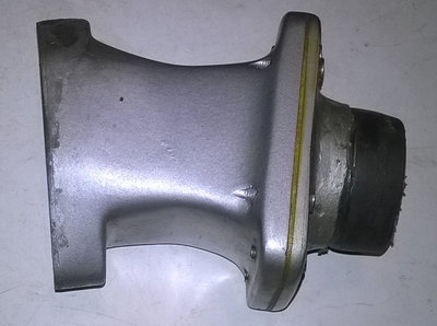

The original manifold has an M6 bolt on either side to clamp the carb's spigot, but the thick alu will not allow for much movement. So the fit will have to be good & hard, if you want to use that original manifold. But of course you don't have to, see below as an example for an alternative I drove a couple of years with (+ shortened inlet skirt).
RV ETZ, top.jpg (24.68 KiB) Viewed 705 times
RV ETZ, carb side.jpg (39.35 KiB) Viewed 705 times
Posts: 2019
Re: OKO carb for ETZ251
Postby dirtsurfer » Sun May 06, 2018 10:29 pm
Puffs wrote:.......see below as an example for an alternative I drove a couple of years with (+ shortened inlet skirt).
That rubber packing really looks like a piece of re-purposed radiator hose and is that a reed valve in the second picture? and Intriguingly use of 8 screws to hold in place!

Postby Puffs » Tue May 08, 2018 3:27 am
Yeah, so? Radiator hose comes in exactly the right size, is resistant to petrol, reinforced, and very strong. Pray tell: what would you use for the flush spigot of the stock BVF?
Andy, it's a reed valve that exactly replaces the original inlet manifold. I have changed very little to the porting inside the cylinder, but doubtlessly I rounded the top of the exhaust a bit & some widening of the ports, but nothing special. I took a couple of mm off the inlet skirt, & lightened & optimised the piston a bit, but otherwise a standard 3-ring piston.
Riding-wise it gave more power low down: the gains were particularly in the lower rev regions, so that the bike became less sensitive to shifting in order to keep it on top of the original narrow power band. It wasn't really any faster (around 85mph), but that wasn't my intention either. The bike was a commuter.
The reeds didn't come from any other bike, I made them for this reed valve, from aramide & epoxy. I made the entire thing, except for the re-purposed radiator hose and the 8 screws, those were made by someone else. I used it for some 4 years.
Of course if you want to really increase the power of the engine you'd have to reduce the dead volume between the reed & the piston, so then you have to shorten the inlet path & drop the reed box into it. In this one, the reeds stop a few mm short of the end of the box.

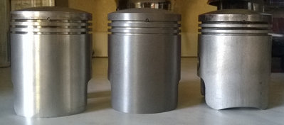

Edit: the piston I used with the RV is the one on the right, it's a Megu. The one in the middle is a new Almot, the one on the left is a RAM with about 2000 miles. The inside of the raised skirt is shown below.
RAM, Almot & Megu with lifted skirt.jpg (16.83 KiB) Viewed 703 times
Megu with lifted skirt, inside.jpg (30.03 KiB) Viewed 703 times
Porting is indeed pretty much standard, see download/file.php?id=4989&mode=view
