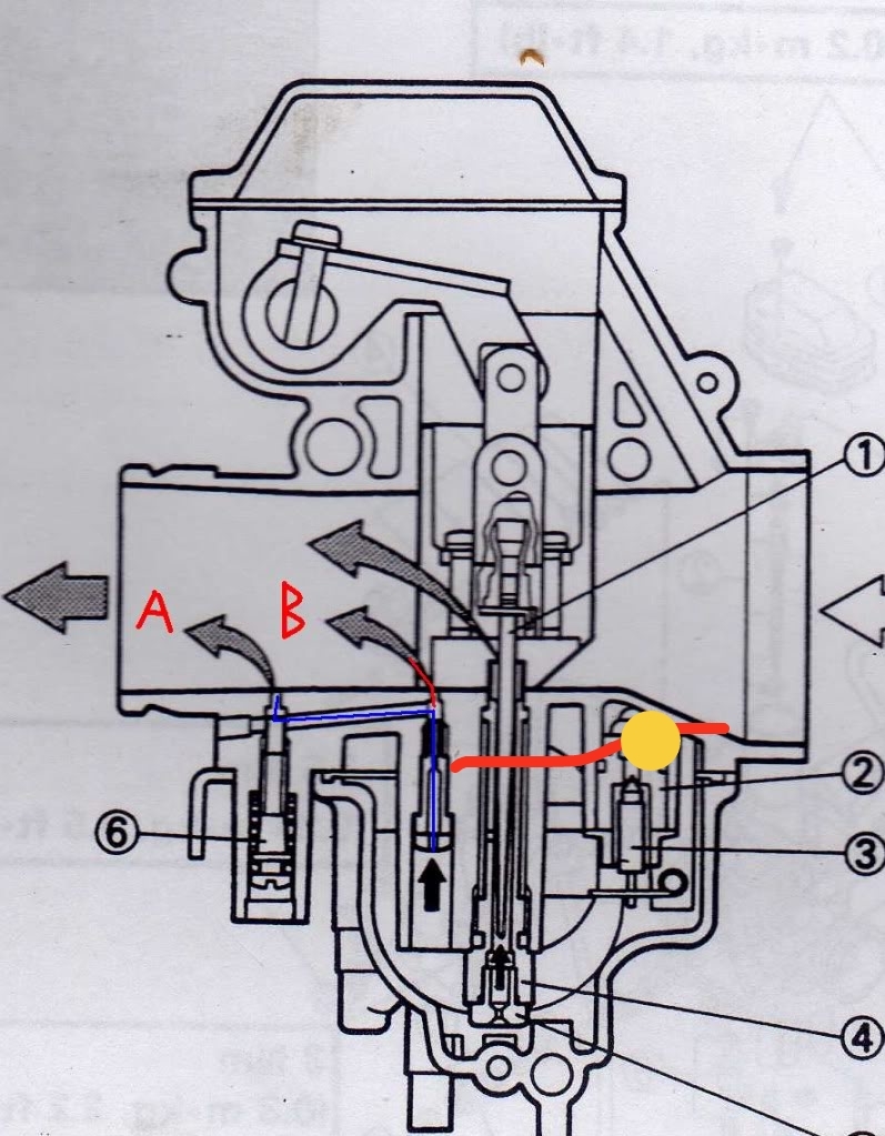

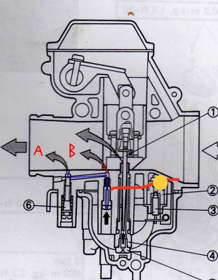

Postby breakwellmz » Sun Mar 31, 2019 4:11 pm
I`ve at last sorted this out!
After putting another in-line filter on without any change, i thought of one last thing before having to bite the bullet and take the carbs off.....
Took out the slow running adjustment screw(6) and blasted aerosol carb cleaner up the hole it came out of, and put the screw back in; it`s been fine ever since!!! :D :D
Thanks for all your input chaps.
