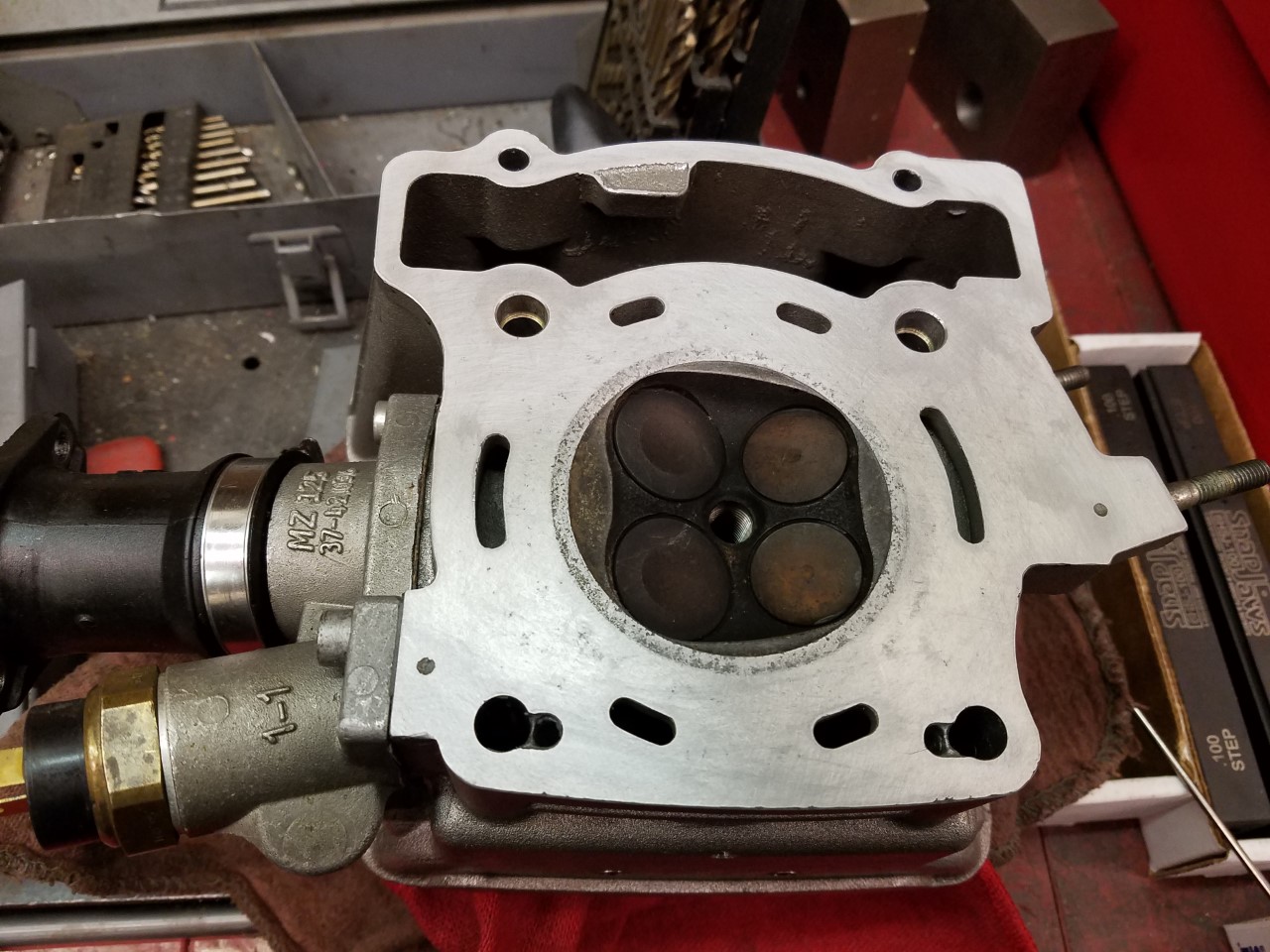

So when I crank it over , it is pumping air into the radiator . I put a pressure gage into the radiator filler opening and as it cranks it raises the pressure in the radiator. When I ride it , it will burp out coolant from the over flow hose. This is why I believe it to have a head or base gasket leak ????? I took the head off and reheated the copper gasket, lapped in the head and it still is pumping air into radiator.

Postby 3rjmorel3 » Tue Oct 23, 2018 6:08 pm
Does this corrosion around the combustion chamber look like it could be the cause of leak in cooling system that pressurizes the radiators when cranking the bike over? burping the coolant out the overflo tube?
