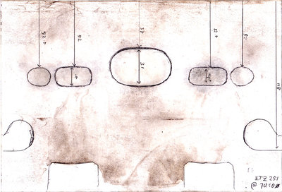

As promised, I've taken my barrel off & pencil-printed it. The picture below should be properly scaled, lengths are mm measured from the top of the barrel. Note that the standard 251 barrel has a 2.0mm high rim there, with an OD = 73.0mm, which falls inside the head. So it's measured from the top of that rim, and if you drilled the barrel up to a 76.00mm bore, that rim is gone & you need to subtract 2.0mm from the numbers. Also note that at TDC the edge of my piston is about 0.8mm below the top of that rim.
Port map ETZ251 @ 70.50mm.jpg (32.15 KiB) Viewed 861 times
These numbers match quite well (+/-0.5mm) with other maps I have seen, of both ETZ250 & ETZ251.
Widths you can measure yourself, but realise that what you're seeing is a piece of paper rolled inside the bore, so the actual width of, for instance, the exhaust port is less than the length of the arc you see on the paper.
I've also had a look at how the ports go inward from the surface of the bore; if they do that at an angle, the height will change if you increase the bore. But actually only the bottom of the exhaust port is at quite an angle, the rest is largely perpendicular to the surface of the bore. So you don't need the 2mm base gasket to correct port timings, in fact you disrupt all the timings of port opening/closing by that 2mm (for ° try http://www.race-base.com/2t-tools/steuerzeit/). But you do have the issue of preventing the piston hitting the head (as it can not enter the head, without machining that).
On the backwards running: it does so because your ignition allows it to. When it kicks back (due to too high pressure, or possibly the port timing issue) & rotates in reverse direction, the points close at 22° after TDC, and bouncing causes another spark. Way too late, so it runs like sh*t, but still good enough to ruin your rev cable. Maybe try the electronic breaker/ignition you have on the other bike?

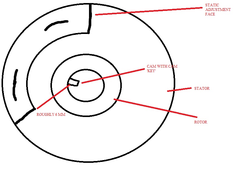

Luckily however- before I did all that work, I compared both my MZ's. Specifically the 'key' in the rotor which controls where the timing point would be and I did find a difference, albeit small- but likely a breakthrough in my problem, and what I had a feeling might be the issue. (after all- the only thing different was the crankshaft).
I measured as best I could, what the difference was in MM between the edge of the 'key' in the rotor to the, although unreliable- the best place I could achieve at that time, the edge of the timing adjustment plate base. (not the timing plate itself). I found a 1mm difference! The Working bike (and I will measure tomorrow what my brother's MZ's is like to confirm) had a 6mm gap. The bike with the problems had 5mm! Obviously the timing key on the crank is off! Which explains why the bike ran so much better when I seemed to be setting firing at '0.5mm' before TDC... It is too pre-mature a spark, and although it doesn't run backwards, this is likely the problem of the compression on previous 300cc cylinder.
This gap was measured with pistons on both machines measured at 2.5(ish)mm BTDC. 1MM gap in that small revolution has a significant amount of difference! But.. I need to find out how much that equates to the 'mm measurement' taken from the spark plug with the piston. I can quite likely find that it 'would seem artificially' that the best firing point would be '0mm BTDC/Fire at TDC'. of course this is artificial and not actually the case, but as long as I remember what the actual firing point is of this machine then the problem should be solved, right????
The pin for the stator rotor has obviously been put in the wrong place.., if not by the smallest amount...
I'm hoping, that adjustment via the plate is still available, and getting the true 22degree firing point is not out of range of the adjustment plate..
We're getting somewhere Puffs....

I'm getting confused a bit, so a summary - please correct me if I'm wrong.
From your other thread I understand that the electronic ignition works well, and from this thread I understand that your new ignition did not solve the problems you had with the bike. With an old 250cc barrel on, it doesn't actually run backwards, but after warming up it still runs poorly, and with this new ignition in very much the same way as with the points before.
And you have found a difference in how the key is located in the crank pin, between your 2 ETZs. But what I do not understand is how that can explain the poor running. You set the ignition timing (on either ignition system, points or electronic) with reference to the piston position, right? Some 2.7mm BTDC? Then that's all that matters. If the key is rotated a bit, it just means that the cam for the points (or the timing disk for the electronic ignition) is rotated a bit, and that consequently the base plate for the points (or for the electronic ignition) is also rotated a bit. But that doesn't matter, the spark still comes when the piston is at 2.7mm BTDC. (The crankshaft is then some 21°-22° BTDC, regardless of the position of the key.)
How do you measure the piston position when you set the ignition timing?
Apparently the orientation of crank pin, that has the key in it, did not receive too much attention on assembly in the factory. They didn't press it in very accurately, rotation-wise, and as long as it is within the adjustment range for the ignition, that doesn't really matter. (It is not something that could go wrong when you, for instance, take the crankshaft apart to replace the big end: for that, those crank pins just stay in place. So it has to be in the factory.)

Yes. the two posts are different. The fact that the bike doesn't work properly is inconsequential to the electronic ignition in my opinion.
I'm finding it very hard to look at aventues as to what could be wrong.. Very difficult indeed. Perhaps I am grasping at straws. I agree however that the adjustment of the plate should remove this problem of key placement.
I measure the position of the piston with a timing tool with mm increments identified.
I must say though, that the crank I put in the bike is not the same crank that blew a big end. Merely a replacement that I picked up on my travels..
