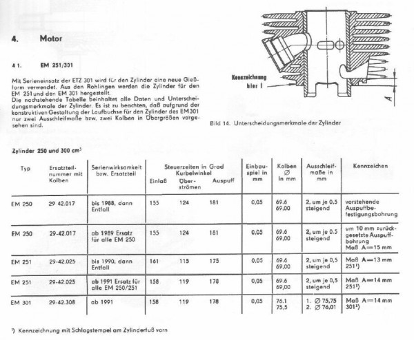

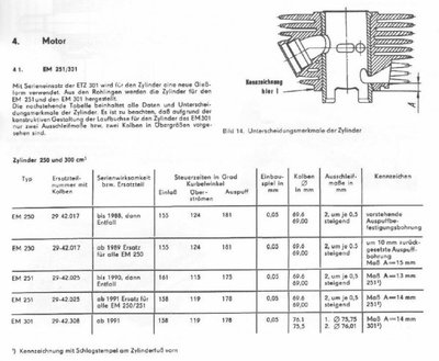

Postby Guesi » Mon Apr 15, 2019 9:48 am
Guesi Motorradteile
MZ spare parts
Posts: 468

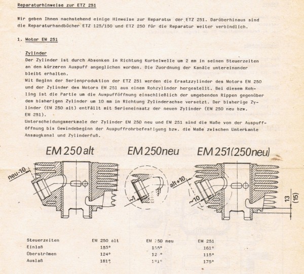

Postby Guesi » Tue Apr 16, 2019 3:42 am
Because the frame is shorter than the ETZ 250 frame, they had to install a shorter exhaust.
To correspond with the shorter exhaust they had to change the measurements inside the cylinder (especially the intake side from 15 to 13 mm).
So the best performance is to connect the 251 cylinder with the 251 exhaust...
Also due to the shorter frame they had to change the exhaust pipe and the exhaust holding nut. With the ETZ 250 echaust pipe the front mudguard came in contact with the exhaust pipe when the front brake is used hard.
Guesi Motorradteile
MZ spare parts

Postby Puffs » Tue Apr 16, 2019 9:25 am
Well, as always, things are more complicated then you'd hope for.
Look at the timings, given in degrees crankshaft angle (Steuerzeiten in Grad Kurbelwinkel) in Guesi's 'Zylinder ETZ 250-251.jpg'; there are generations of barrels, varying both by model & by year. The biggest difference came right with the introduction of the 251, so between the latest 250 & the first ('89) 251. Then, from end '90 onwards, the timings are roughly half-way between those 2 extremes.
The timings of the first, '89 251 suggest more high RPM focus, and apparently they didn't like that too much and went half-way back. It is possible that yours, being an export model, is just one of the first of the latest generation, which has less difference with the 250. Quite possibly those differences are so small that they are difficult to perceive, and might be masked by other effects. You should however have the ~10mm difference in how far the exhaust port protrudes, and 1mm in squish band. So say these data.
These timing differences could also explain differences in how you & me perceive the character of our bikes.
PS/edit: I just had a look for the indicated markings on mine, a '89 251 UK export model, and I cannot see any markings / Kennzeichnung at all at the indicated place. Yet I am quite certain it is an original barrel, of the first 251's.

Postby Puffs » Wed Apr 17, 2019 7:32 am
Actually a pretty crude thing they did there; simply taking a bit from the base & thereby reducing the exhaust & overflow opening period (by resp. 6° & 9°), while at the same time increasing the inlet opening period (by 6°). That will increase the blow-back (through the carb) yet reduce the breathing ability above the piston. Maybe a longer piston skirt would have been in order, and it does explain why I felt the need for a reed valve (to which it responded very well).
Also, I suppose the bit they took off the base was added to the top of the barrel, in order to retain the volume of the combustion chamber & the size of the squish band, but I don't see mention of that.

Postby dave47 » Wed May 01, 2019 8:53 am
Puffs wrote:PS/edit: I just had a look for the indicated markings on mine, a '89 251 UK export model, and I cannot see any markings / Kennzeichnung at all at the indicated place. Yet I am quite certain it is an original barrel, of the first 251's.
I have two ETZ barrels, one made in 1985 which must be an "alt 250", and one made in 1989 which looks like a "neu 250". According to the official data, kindly supplied by Guesi, they should both have the same timing, but, in fact, all the ports in the later barrel are approx 1.25mm lower. They otherwise appear to be the same size and shape. So my 1989 barrel does not really match any of those in the data chart; it has the appearance of a "neu 250" but the timing of a 251.
The exhaust outlet also looks a mess. Instead of being circular and central in the pipe seating, it is irregular in shape and wildly off centre.
@ Puffs
It may be that your barrel is the same. In fact my rather rough and ready measurements fit quite well with the paper transfer that you have posted elsewhere on this website, except that your exhaust port is 2mm bigger than either of mine. Has it been enlarged?
