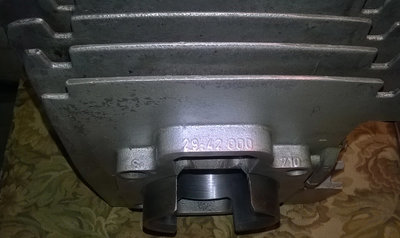

@ Puffs, If your number is not on the front, it will be on the LHS of the "neck", in the middle, but it is unlikely to tell you much. It will almost certainly say 29-42.000. On mine there is another number, 710, to the right of that. It may be coincidence that this is 017 backwards.
I say that my barrel has the appearance of a 250 not 251, because it has no frontal number, and what numbers it has are the same as the 1985 barrel.
On the RHS of the neck are two small numbers which almost certainly indicate the month and year of manufacture, eg 89 and 8. They might be upside down.

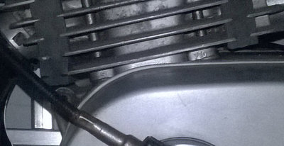

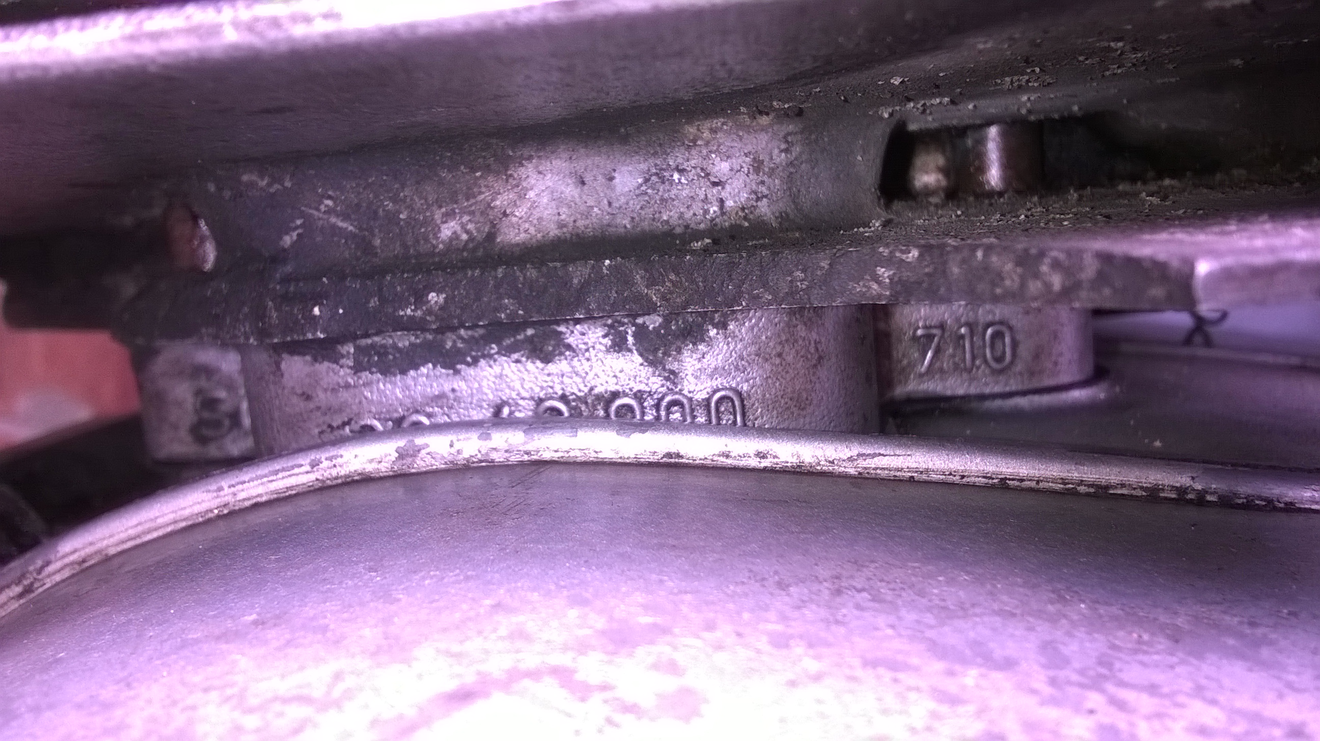

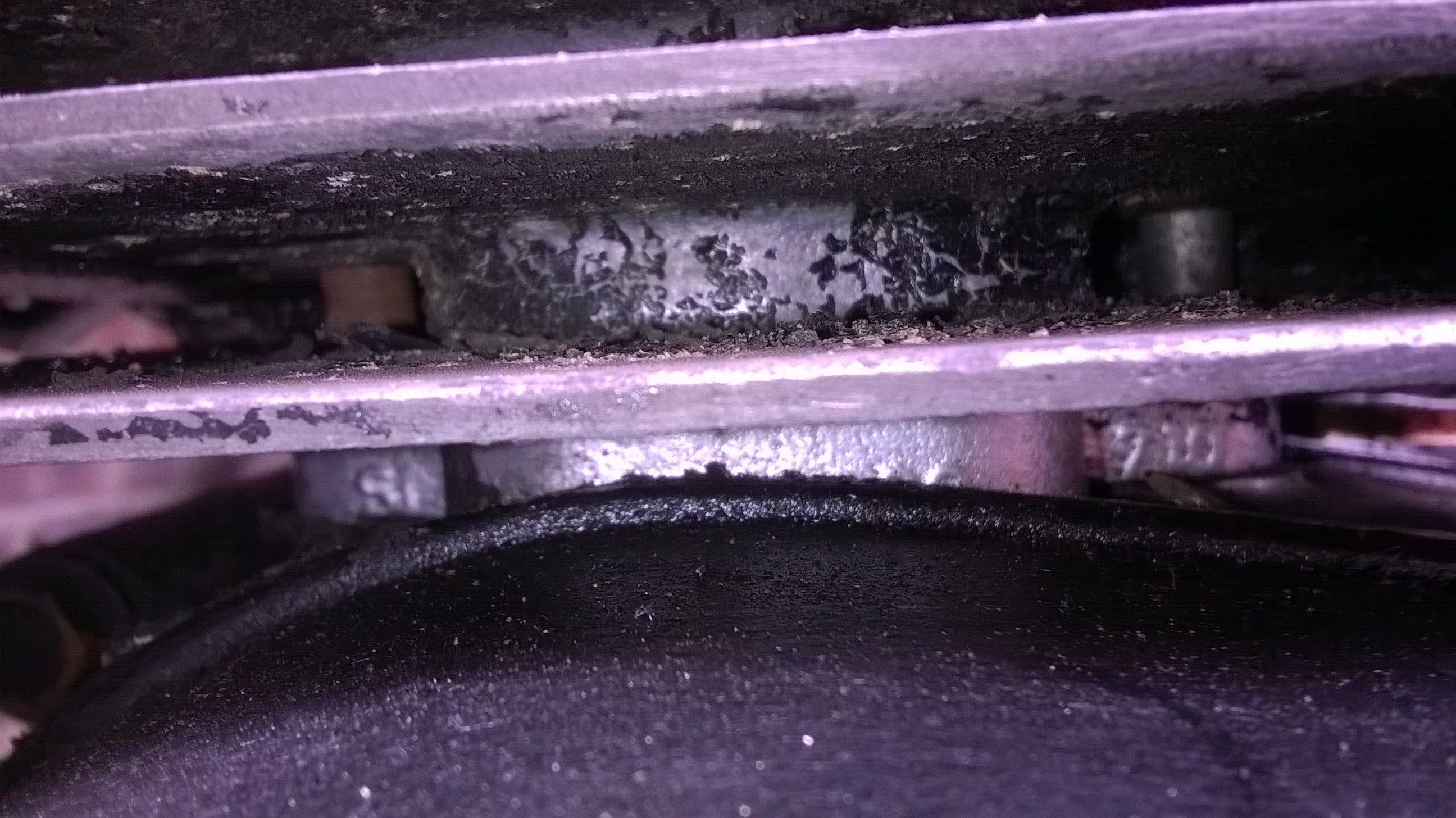

The number will be where I said, but may be obscured to a greater or lesser extent by the LH cover which for some reason is higher than the crankcase. It is mostly visible on my early ETZ, ( broken fin makes it even more visible!) but only the top part of the final .000 can be seen on the later bike. It tells you nothing anyway.
All the markings are the same on both of my barrels and on yours, except the date marks. I think it very likely that this is what they are, because apart from anything else they are in circular panels, which suggests they are changeable. This would indicate that your bike, like mine, has a replacement engine/barrel, but whether from a late 250 or early 251 is anybody's guess. I suspect that MZ may have used the same for both for at least part of the period 88/89.

It's not really 'anybody's guess' if they are 250 or 251 barrels; the numbers & measurements given in the documents Guesi's provided can serve as guidance, particularly Maß A. That should be easy to measure accurately, but also the port timings are an indication. Next time I have the barrel off, I'll have a look.
FWIW, it looks like the 'Si' & the '710' on your first photo are a bit lower than on your 2nd, which would be consistent with Maß A being (2mm?) less.

I think you are right , it has been dropped by about 2mm, (not 1.2!), which makes it the 251. The data sheet must be wrong about the position of the number. The footnote must only apply to the later 251/301s.
The "datemarks" on my earlier bike read "E" and "85", which I take to mean May 1985. It is consistent with being on a D reg bike (UK), but somebody must know for sure.

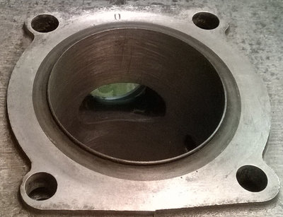

It turns out that at the behest of my neighbour Dr. Alzheimer I had made some pics when it had it's latest rebore:
ETZ251 barrel, ID numbers neck.jpg (23.01 KiB) Viewed 836 times
ETZ251 barrel, top side.jpg (32.5 KiB) Viewed 836 times
So indeed, '29.42.000' and '710', while the stamped '0' @ the top tells me very little.

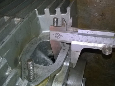

Postby Puffs » Fri Sep 27, 2019 7:13 am
I've had the barrel of my '89 251 off, and referring to viewtopic.php?f=5&t=9624&p=49338&sid=2aecf9a7e375fbcba527282589100173#p49338 , indeed:
Maß A = 13mm.
Maß A = 12.9mm.jpg (30.96 KiB) Viewed 836 times
See in Guesi's figure that the in '89 new 251 has a (much) longer intake opening, combined with shorter overflow & exhaust timings. It looks like they just chopped off 2mm from the base of the barrel, and added that to the top, while keeping the casting mould. This may explain differences in character between bikes, and why mine benefited so much from reeds. After just 1 year they went to a happy median Maß A = 14mm, possibly realising they didn't really like the new character?
