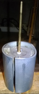

Postby Puffs » Wed Jul 31, 2019 10:32 am
The first thing I did after that, was return the needle to it's previous position. That's not actually quite #3, more like #3½ (in-between #3 & #4). This is what it looks like,
Org = preferred position (~#3).jpg (16.86 KiB) Viewed 636 times
and the reason it's like this is because I had lost the original clip into the engine a long while back. The steel clip it has now is so small that hopefully it won't cause any damage. The original did cause damage. Below the steel clip is a 2mm nylon bush to stabilise the needle, and I hope that bush won't cause any damage either in the event something happens. One can hope.
Looking at the drawing of the 30n3-1 carburettor in the Haynes manual, there is an 'O'-ring on top of the carburettor's throttle housing, in the lid that screws on. I didn't have that. It cannot leak much across that very fine thread, but I had an 'O'-ring that fitted fine, so I installed that. And adjusted the throttle cable for the lid coming up a bit. Then I found that the 'O'-ring made no difference, so I was back to where I started - but left the 'O'-ring in.
Next I focussed on the idle adjustments in this carb. Until then I had: Pilot 2½ out, Bypass 3½ out, idling at about 1300RPM. That ran fine, but it surged. I then tried to lower the idle (against the idea to reduce the amount of mixture it gets on the overrun), and I arrived at:
Pilot: 1¾ & Bypass: 2¾, idling at about 1000RPM. It ran pretty well, but cold starting was a bit more difficult. I did about 70 miles with that, and it still surged. Initially I thought it was a bit less, but probably that was just wishful thinking.
So then I went back to the 'Standard' setting: Pilot: 2½ & Bypass: 4, idling at about 1400RPM. The take-up is better than with the low idle, and for the surging it does not appear to make any significant difference. The bike runs fine, but it still surges going downhill w/ the throttle closed.
Not sure where to go next. Maybe another carburettor (in which you can close-off the flow better), maybe back to reeds? Or maybe just pull the clutch.

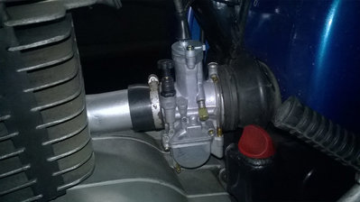

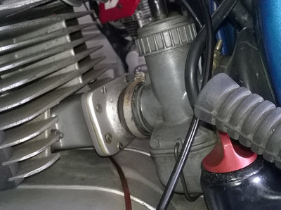

Postby Puffs » Tue Apr 28, 2020 7:26 am
Following on from this, I too tried one of these PWK clones, a Koso PWK32, as detailed in viewtopic.php?f=20&t=10290&p=51251&sid=8a66b7fd0117aafef4b03ba2f25ddcef#p50780. When I wrote that, I had not done to many miles with it yet, and my first impression was that I thought to see some gains at the lower end, though the top speed had not benefited. A pic:
Koso PWK32 mounted.jpg (21.08 KiB) Viewed 636 times
(It also received clamps on the manifold & air box side.)
I always find it difficult to judge if something like this, like another carb, brings any real benefit. Initially you have just bought & installed that shiny new gizmo, and by the nature of that, you/I tend to have a more positive view on the matter. New is always better, for if it isn't you wasted your time & money. And also, when judging differences, you have to compare how the thing runs now, with how it ran several days back. I find that difficult. It is a subjective impression, which I find difficult to remember. For top speed, I use one particular stretch of road, shielded from wind, so that is a reasonably objective comparison.
I still haven't done many miles with it, but a few hundred, and now also in nice weather; I think enough to judge. Now I think the gains I saw at the lower end were actually due to me raising the barrel (by 1mm), which I did just before fitting the Koso. And top speed-wise, there is not really any difference between the two carbs either, and neither is there in the way the engine runs. With both carbs there is some minor surging on the overrun, but nothing significant & it doesn't bother me.
So now that the honeymoon period is over, I thought: let's try the original BVF again, and get a new appreciation of the differences. That is easy, as I had made a dedicated intake manifold for the Koso, and kept the original one for the BVF. Put the BVF back, and I now think there is actually very little difference between the two. As swapping is easy, I'll probably go back in summer to give the Koso another try.
I think the Koso is nicely made (I like the chromed slide & carb body), it's good value for money and it works well. There's nothing wrong with it, but it does not really bring any significant improvement either, and for originality I'd prefer the BVF.

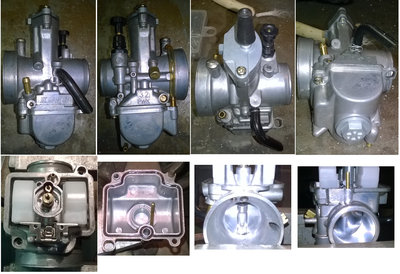

Postby Puffs » Wed Apr 29, 2020 7:00 am
Bing is another fine maker of carbs, with many years of experience. West German, I believe. Around '75 I put a Bing 54 on my CZ 980, to replace that Jikov; that Bing is still on. Not quite in the same price range as this Koso though (around £14 for the Koso if I remember correctly).
For reference a few pics of the Koso:
Koso PWK 32.jpg (42.23 KiB) Viewed 631 times
Koso 2.jpg (29.53 KiB) Viewed 631 times
I have no idea how this carb influences the fuel consumption for this bike. Sorry, not my focus, not even when I used the bike for commuting.
