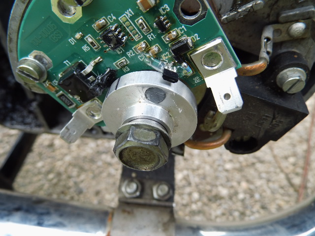

An electronic ignition is available for about 100 Euro.
https://www.guesi-motorradteile.de/pic_ ... CI3608.JPG

There are several ignitions on the road with no negative feed-back.
The ignition timing starts at 0" on 1000 rpm
At about 2000 rpm it is at its full ignition timing (about 2,7 mm before TDC.
At the moment there is no english version of the installing instructions. But we will make a video and will publish it on youtube the next days (in german and in english)
The coil must not be changed (which allows also to change to contact breaker in case of failure of the elctronic ignition -which won´t happen :-) )
But if you are on a long trip somewqhere in the desert :-) you can take the contact breaker parts with you and change it in case of failure within 20 minutes...
