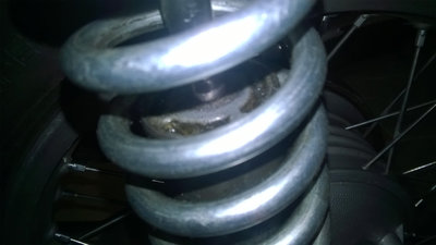

Postby Kruh » Fri Mar 06, 2020 12:56 pm
Puffs wrote:My ATF (Q8 Auto 15) has a viscosity not dissimilar to SAE10, yet seems a bit thinner. SAE10 is what Haynes recommend for both the ETZ forks and the shocks.
Can you even dissassemble the rear shocks and change the oil?
If yes, how?
Kruh
Posts: 149
Location: In the shed
Re: Fork/suspension oil for ETZ 250
Postby Puffs » Mon Mar 09, 2020 6:28 am
The original ones you can, unscrew the threaded ring below the bump rubber:
and you can pull the whole lot out. See also pg 90 of Haynes.

Postby Kruh » Mon Mar 09, 2020 7:21 am
Ah, I see
Thank you
