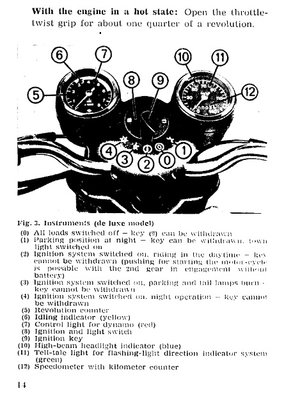

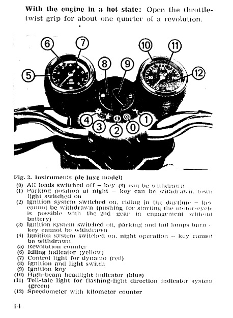

Hi.
I have found in the owner's handbook:
You can find it in page 14 here:
ftp://blurredmanswebsite.ddns.net/Vehic ... ndbook.pdf
You use position 3 for tail and pilot lamp to be illuminated.
Position 4 for dipped beam. Position 0 is pilot lamps on, but ignition off.. For parking in an unlit road.
