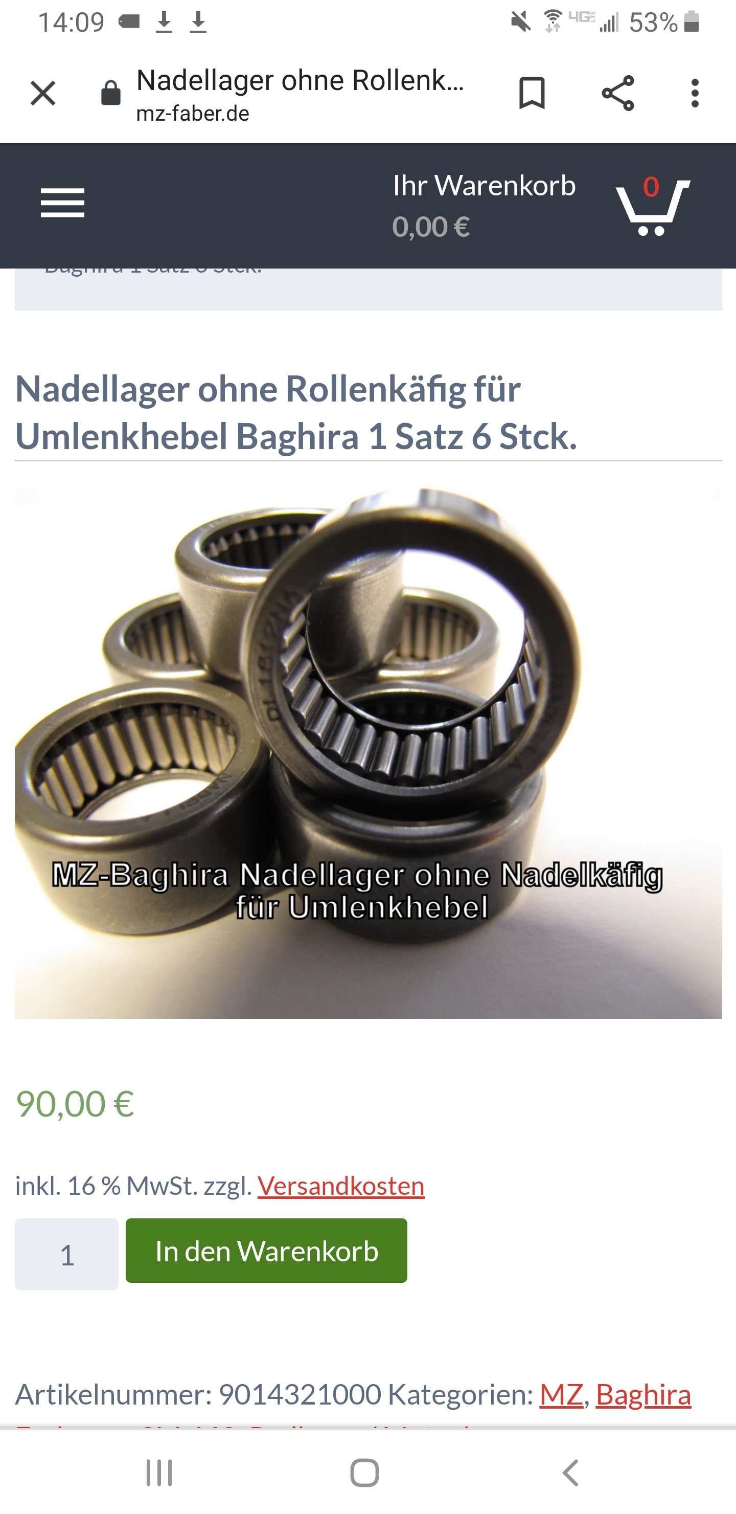

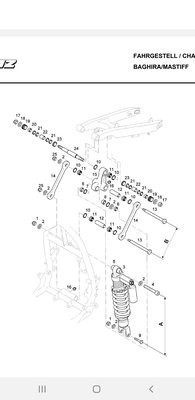

Does anyone have a US source? Item 11 needle bearings part number 9014321000... need 2 not 6. Unless anyone wants two I'll buy and we can split them.

That's a lot of money for little needle rollers. I've just looked on line and find drawn cup, full compliment, 20x26x25 mm bearings as an example are about £5 each. I guess that's about the size you want. I did my Skorpion bearings some years ago, can't remember what size they were, got the old ones out, measured them, found some etched i.d. on them and bought them from a local bearing supplier. It's becoming that OEM suppliers are a last resort because of their extremely high prices. Have you tried Graham's Motorcycles in Taunton UK? Official MZ spares supplier, I imagine they sell them in any quantity you want.

Hi Ralf, Thank you for the reply. I did reach out to Grahams. They only want £8.60 each :D that will have to do.
