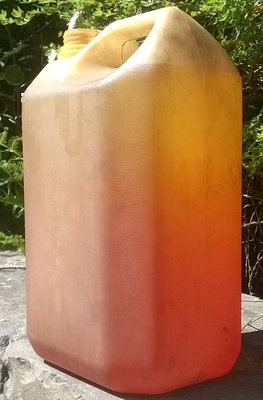

I don't have such an oil cup on my MZ either, but I have something very similar on a 2T electric generator, in PE.
I always carry a bit of oil with me (in the battery area), just in case, but if I plan to mix at the pump I take a set quantity of oil with me, and fill up with the desired amount of fuel. And then, after I ride away, a bit of acrobatics to mix it. Just to show oil + fuel do need shaking to mix well, this is what happens if you just add the (red) oil to the fuel, without shaking:

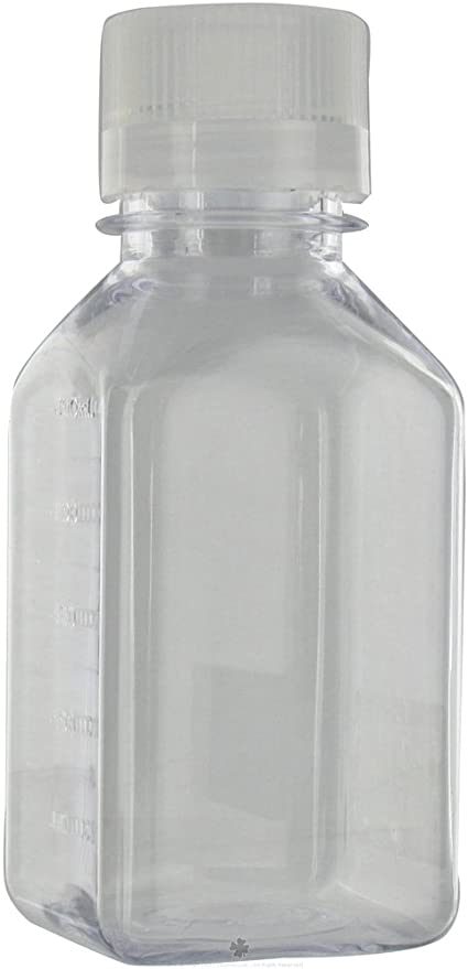

Guesi and puffs thanks for the lively conversation. I’m hoping this thread can be useful for others searching in the fuel. I understand the normal perils and pitfalls in discussions about oil and oil quantity on forums but I feel this has been a nice conversation among all players.
In the end it sounds like if I’m 50:1 or slightly richer I should be good to go. To that end I found an 8 oz (250ml) nalgene brand container with graduations to accurately mix/carry oil on the road.

Postby Blurredman » Thu Oct 08, 2020 4:46 am
An 8oz bottle would be just fine for the 12.5litre/2.7gal tank you have for 50:1 :-D :-D

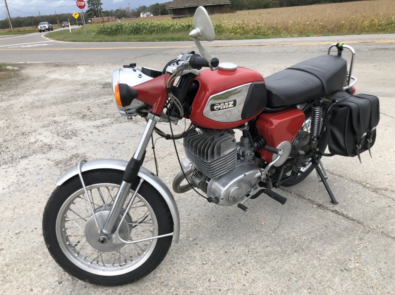

Postby R1100purist » Sat Nov 14, 2020 7:07 pm
Alright, got her cleaned up and did an initial shakedown ride. It was out to the country side and she did fine. Although a little difficult to keep her idling, and after a fast run idle was reluctant to come down.
Additionally there was a little leak from the drain plug that I’m trying to sort out.
