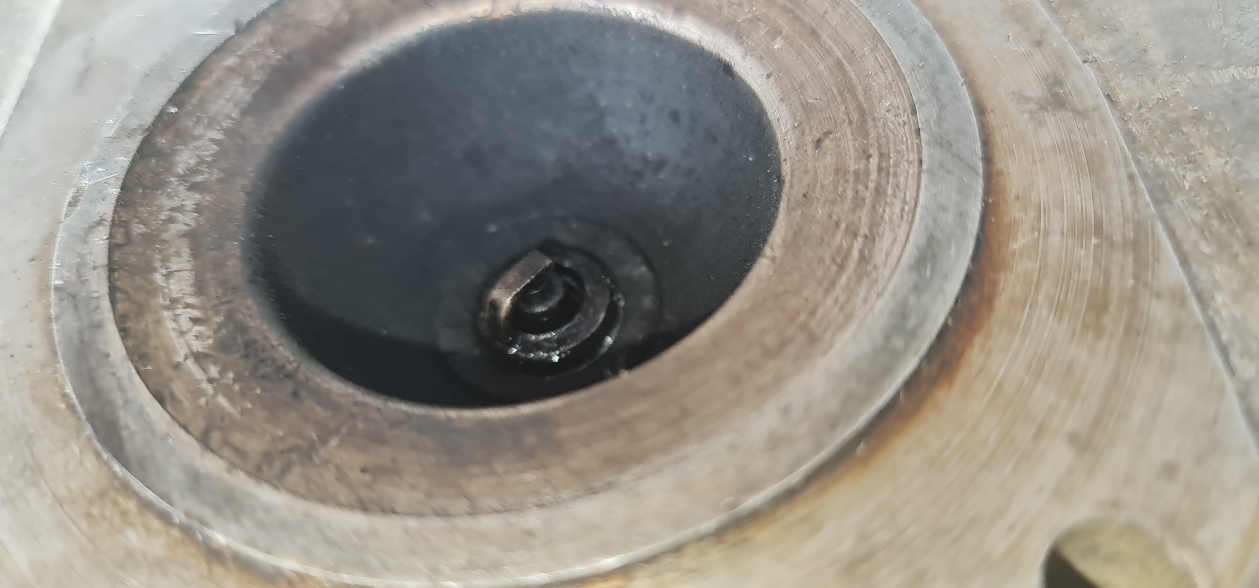

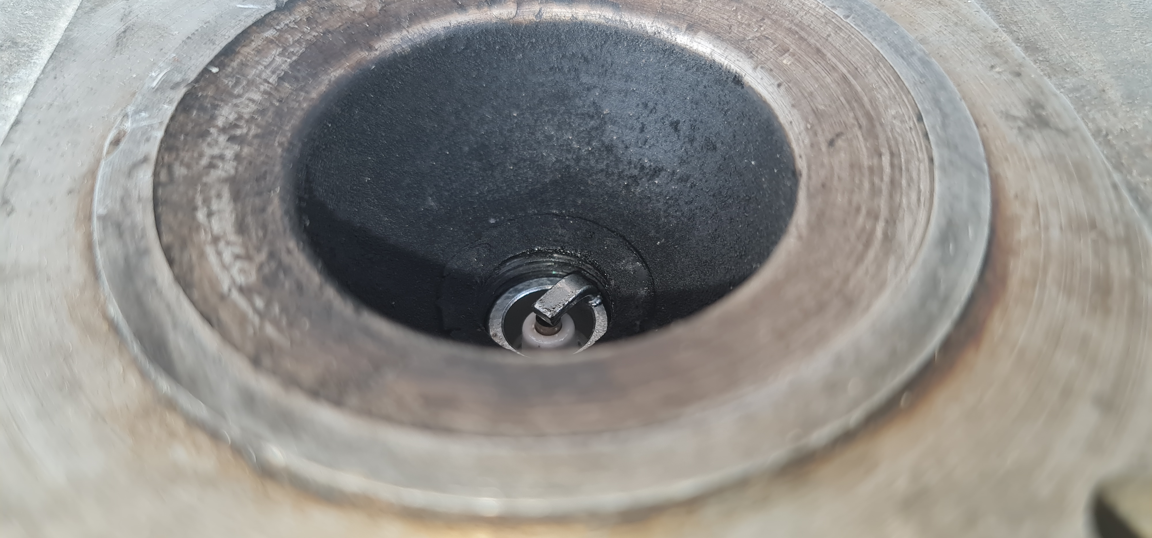

Postby grimstone » Fri Sep 17, 2021 1:10 am
Here is a tuff one:
Bought yesterday the b8hs but they do not seem to have tge good reach into the conbustion chamber, neither do my other plug. the b8hs serms short and the other seems long. See pics attached with plugs mounted in my reserver cylinder head (175/1 but they are the same as 250/1).
Any thoughts? Bike starts with the b8hs and idles ok, engine a lityle quiter I think... but still. The electrodo should just protrude with the tip where tge spark is generated inside the chamber...right?
Should I create a new toppic on this?

Postby grimstone » Fri Sep 17, 2021 1:58 am
Puffs wrote:Coming back to the plug: yes it should be a short shaft model, and yours is odd. I count 10 windings on it, vs. 8 on the one Guesi showed. I see the ring is off, and there also is the small hex size. Anyway, an NGK B8HS (or B7HS, is what I used most in my ETZ) should be fine.
Please see 1 reply above ... Need a new thread for this?
