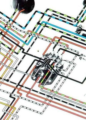

Postby Andy_C » Mon Nov 01, 2021 4:45 pm
So that black wire you have pointed at in the diagram is the +ve wire to the coil and rear lamp by the looks of it.
At least you know the coil is OK.

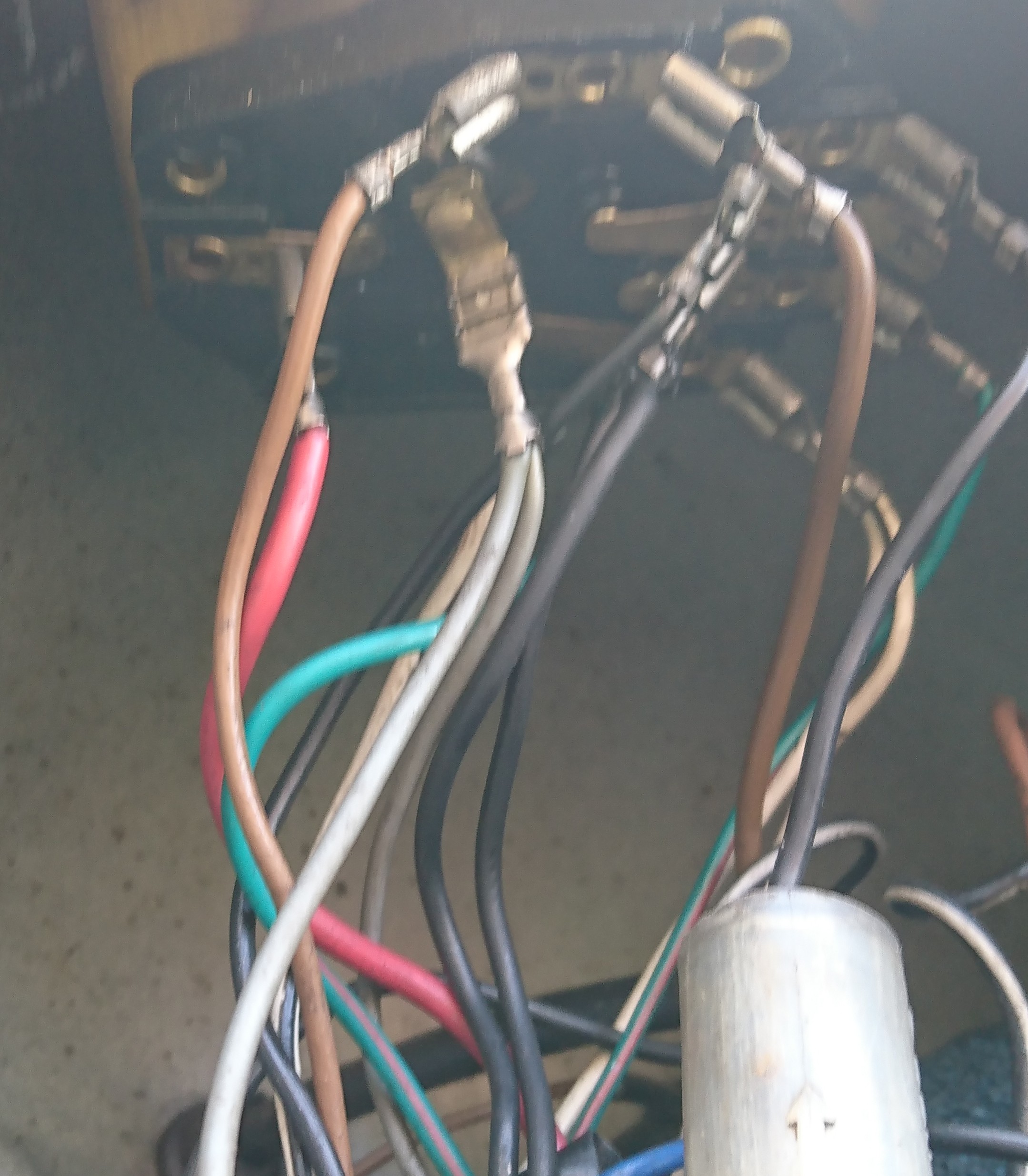

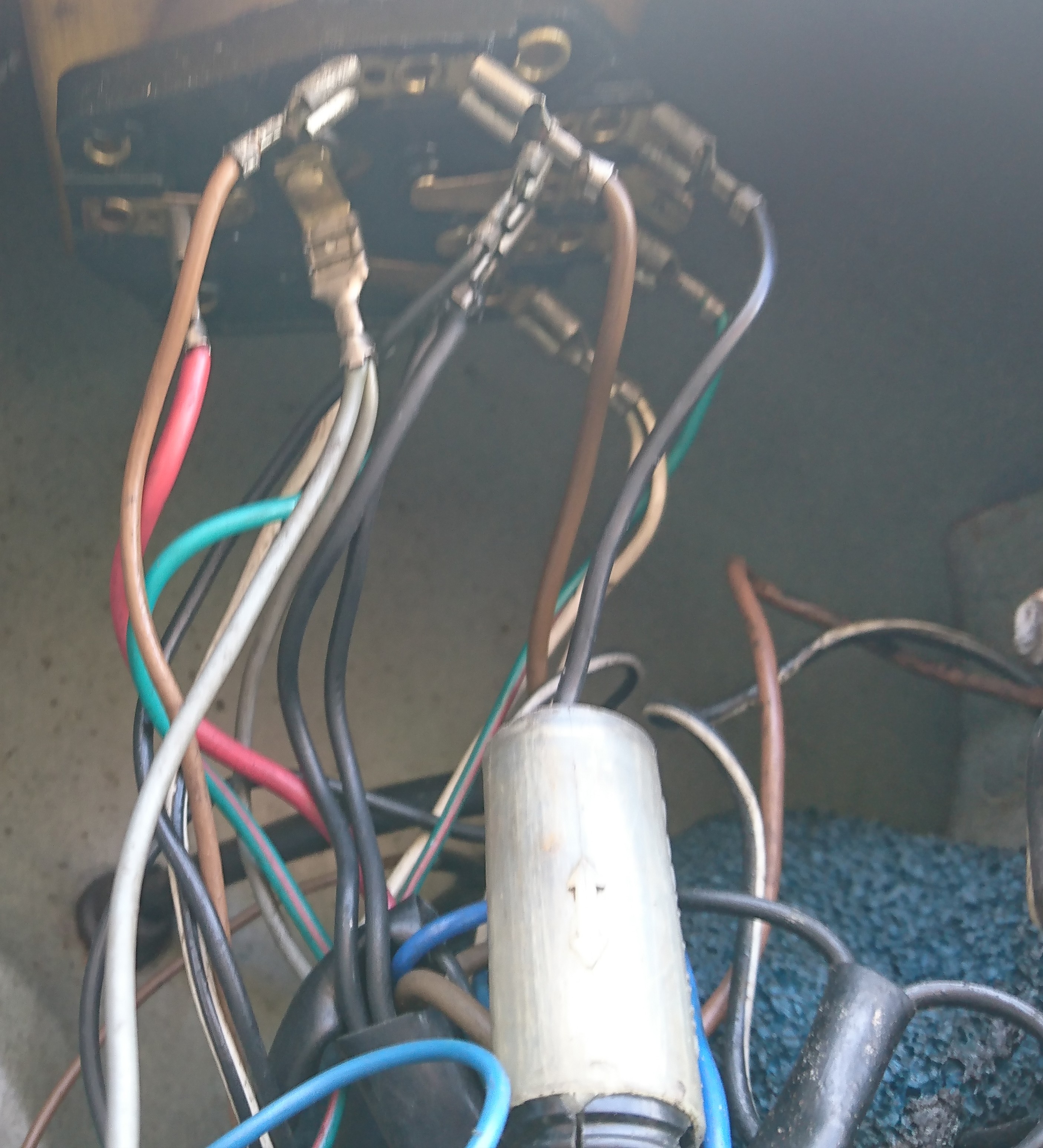

Andy, I have now got a brand new coil, but yesterday I discovered something alarming, with all the wires connected (apart from that black) still no spark, I sat down facing the now installed points and decided to meter it all out, and to my astonishment with the points open there was still a circuit through them ? I actually removed the points, put some paper between them and tested again, no circuit, so I carefully reinstalled them, and before I put the wire back to the condenser I checked them whilst open and they were fine, but when I put the green back to the condenser it made the circuit again (that green goes straight to the coil) so I took it off the condenser and put my meter on it, and then onto the green of the coil and as I expected I got a circuit, keeping my probe on the green from the condenser I tested the black, and bugger me I got a circuit, I was pushed for time to go somewhere and had to leave it at that, but first I think the coil is still faulty, or is it the black? as I drove away I thought about the black going to the coil, it comes from that straight connector block on the frame below the seat and the black that causes the fuses to blow is piggyback on it, I wonder if it could be earthing in that bloody block, there is another black from the other side of the block going to the rear light but I totally disconnected all those heading to the rear lights and indicators. I am heading off to work in 5 mins, but later I am pulling that connector block apart, and maybe fit the new coil too, then test again.
sidewaysid123
Posts: 32
Joined: Sat Oct 23, 2021 11:46 am
Re: Wiring help please
Postby sidewaysid123 » Tue Nov 02, 2021 10:19 am
Eureka, well it was the black wire in some ways, one black from the coil and the bare wire (which when connected blew the fuse)were joined into a spade connector and this went into that black terminal block, it was the 2nd one from the end, in the end was the brown which is of course earth, bugger me I had no idea that inside the terminal block the connections are linked together in two's , so I was putting the black from the coil to earth, so whoever had this bike before I bought it must have been messing around with the connectors at the black box, I have taken it off and prized it apart, I suppose I will get a replacement, but does anyone have a decent drawing of the connections with colours, the manual I have is murder to follow having to count down the lines of cables to see what colour you need. Anyway it is running, the front light works, the neutral indicator works, and I have had a light working at the back, but unsure as to the right combination of colours, mostly black and what I thought was white is actually a poor looking grey, the rear indicators are trash and the rear light is too, my main concern now is whether or not it is charging? how's the best way to check for a charge? I am so pleased I have it at least running and some lights working, should be easy peasy from here on.

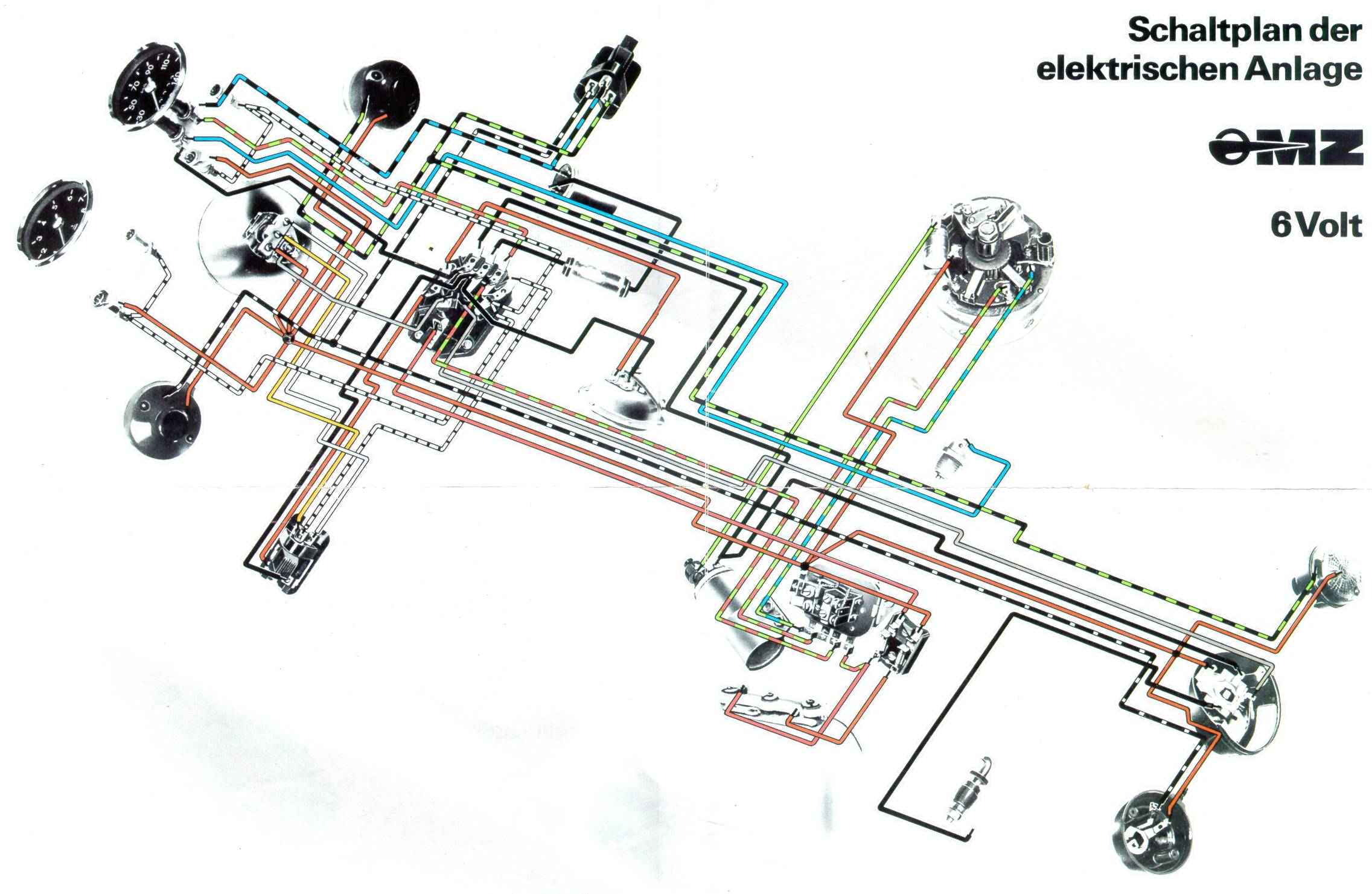

Postby Blurredman » Tue Nov 02, 2021 10:43 am
Taken from my FTP...
MZ_TS250-1977-Official_Service_Manual.pdf
(5.1 MiB) Downloaded 214 times
Posts: 1253
Postby sidewaysid123 » Tue Nov 02, 2021 11:22 am
yes I have that diagram, but I was hoping for one showing that bloody black terminal block with double spades and what colour wires go in one side and what colour come out.

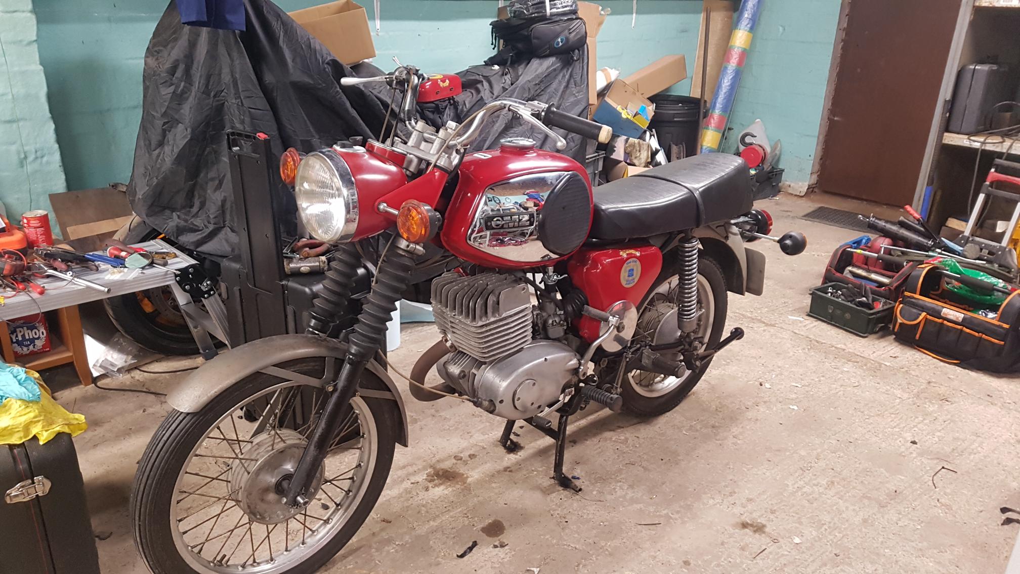

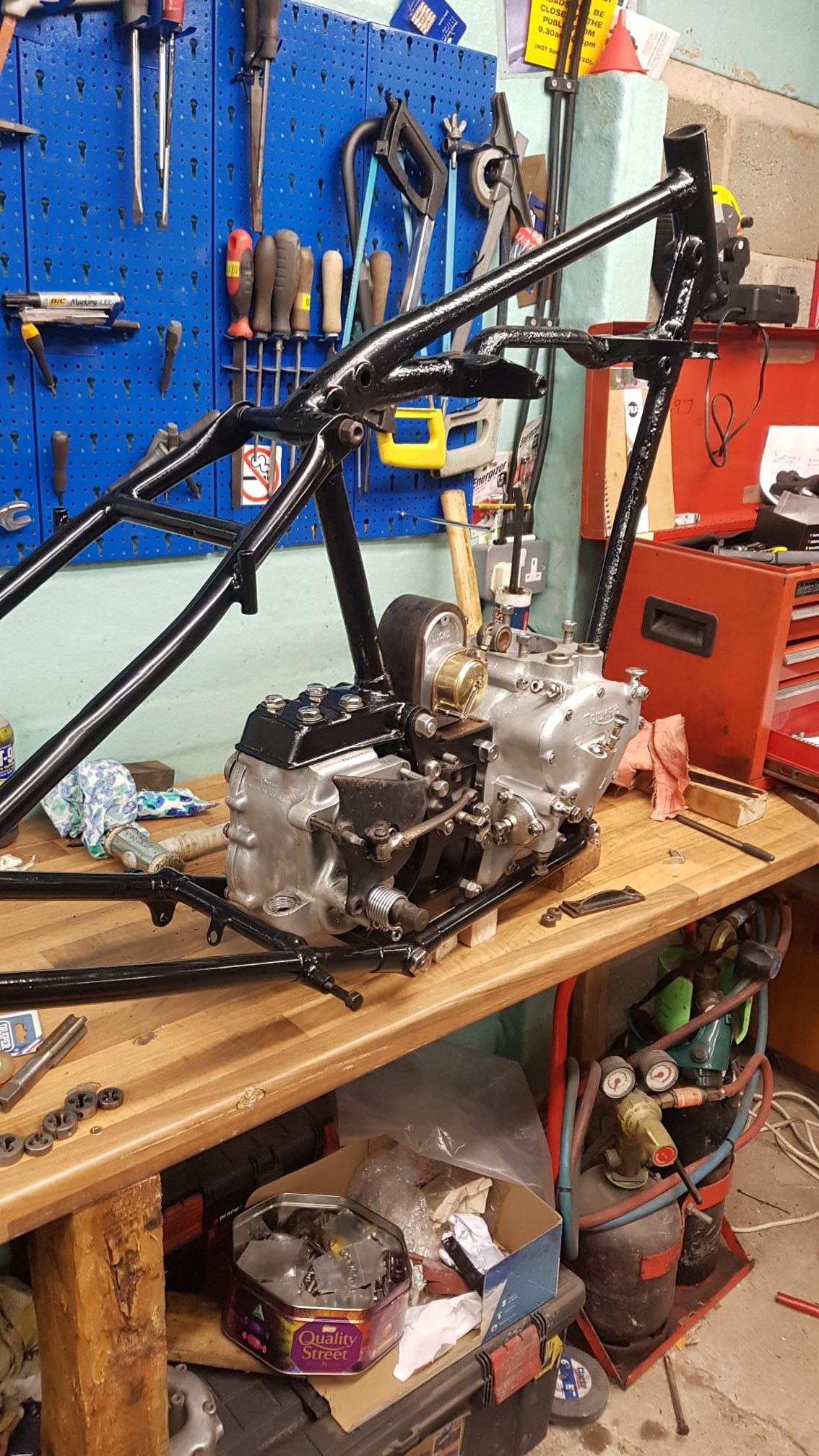

We are charging....I read the leaflet that I got with the solid-state regulator and did as it said with the DF+ and DF- but it didn't charge, so I swapped them around, and hey presto it charges, I think it was pumping over 7 volts in, what a relief, so I have turned my attention to the rest of the bike, I am putting a new backlight and rear indicators on (hope my wiring plan is successful, I thought I better check the gearbox oil, so I drained the old oil, there was no more than a bloody eggcup in it, I hate it when people let things get so bad, I mean if there wasn't a leak it should have more in. So I have put 750cc of gear oil in, I free'd off the choke lever, discovered that the brake light switch in the rear hub is knackered, the horn too, but I am getting there, I must be mad because I am trying to get my 1929 Triumph CSD built, so I can do the Banbury on it (see pic) thank you all who helped me, I will be back. Oh yeds one small thing, a bloke in my village told me that his Mum is the treasurer for the MZ club, is that this club, or are there others around?
