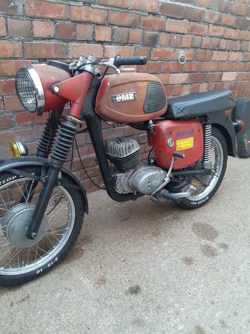

Hello there.
Earlier this year I was gifted a very sorry looking TS125 Alpine.
My first MZ, but the more I look into it, the more I appreciate the design and its simplicity.
A few months on and I have rebuilt the engine and had it running but am suffering from a dragging clutch and poor idle.
However the problem I least understand, is the electrics.
I have put a multimeter on the battery to look at the current direction and can never get any positive charge.
I also note that the mechanical regulator isn't doing any switching as I rev the bike.
Specifically - I notice that when I turn the ignition on (before I start the bike) there is 3 Amps draining from the battery. This seems high when there is nothing much switched on.
Can anyone comment on this?
If the battery is draining what is the best way to find the source?

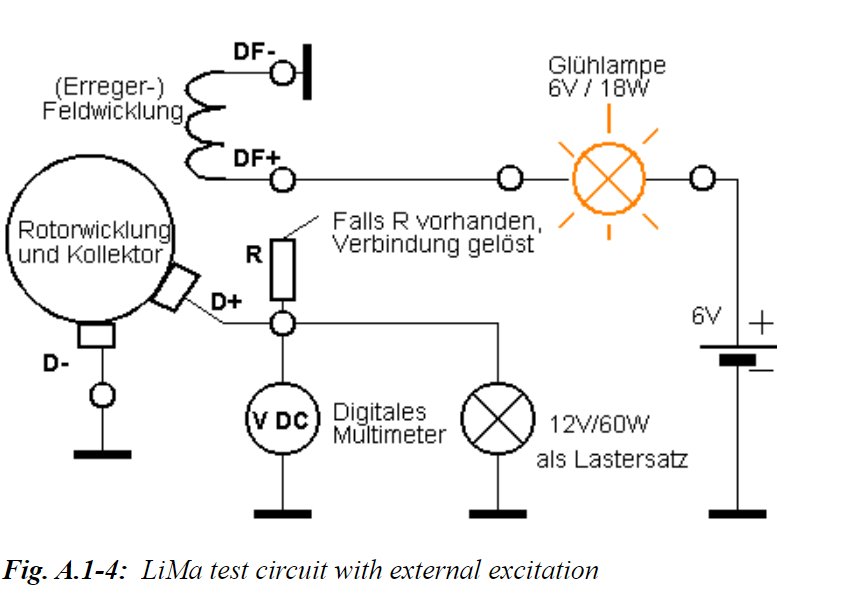

Postby stevebod » Mon Sep 19, 2022 8:00 am
Thanks for the continued help.
I managed some checks from Lothar's extensive document (very grateful).
I wanted to establish if the dynamo had an output so that I could then turn my focus to the regulator, if this was the case.
Following this procedure
Lothar's electrical test
I got the required output of 12V with the bike revs increased.
So I think the generator is working.
I heed Puff's comments about the current needed for the field coils, I may check that again, but I think the output is correct.
I need to look at the regulator next, but I might try swapping in a solid state one, I don't know what the opinion on this idea is?

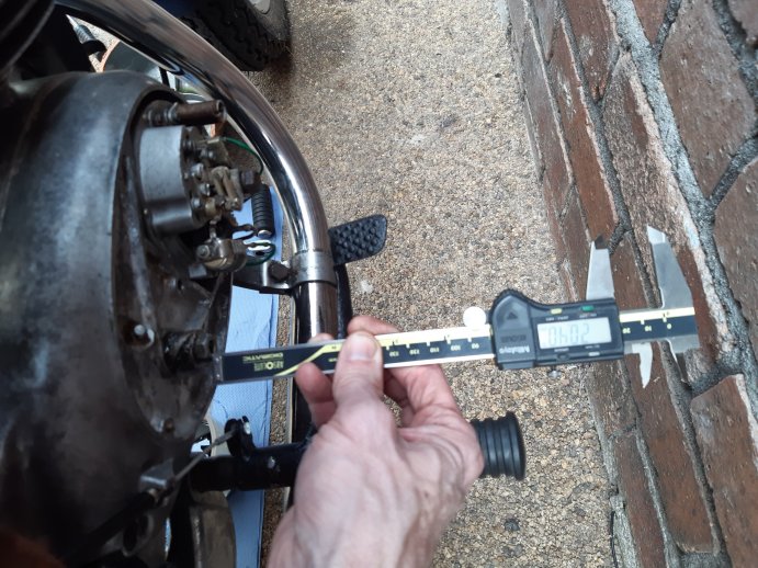

The other issue I haven't asked about yet is the clutch which is dragging quite badly.
I've made all the necessary adjustments - I even tried eliminating the free travel to maximise the clutch throw, but of course won't ride it like this, it was just to prove a point.
Even in this setting I can't select first gear without the bike either stalling or moving off.
Can I ask if anyone knows what the clutch throw should be?
measuring clutch travel
I measured 1.2mm of movement at the back of the clutch actuator. Does that sound enough?
Many thanks.

Postby Throwley » Tue Sep 20, 2022 3:31 am
stevebod wrote:Thanks for the continued help.
Going through exactly the same issue on mine at the moment. Clutch throw is around the figure you quote. Clutch basket, centre splines and driver/driven plate tongues are all perfect! First is difficult to select when cold, the bike stalls with the clutch out without a good handful of throttle.
I've found the condition improves vastly once the clutch is hot, to the point I get only a tiny rev. drop.
I suspect the oil maybe the culprit here. I'm using the manual-specified 80-90 EP oil, but was thinking of trying non-EP, or lowering the grade. Will let you know when I get around to it (have kickstart ratchet issues to sort first).
I'm getting VERY good at stripping the clutch!!
