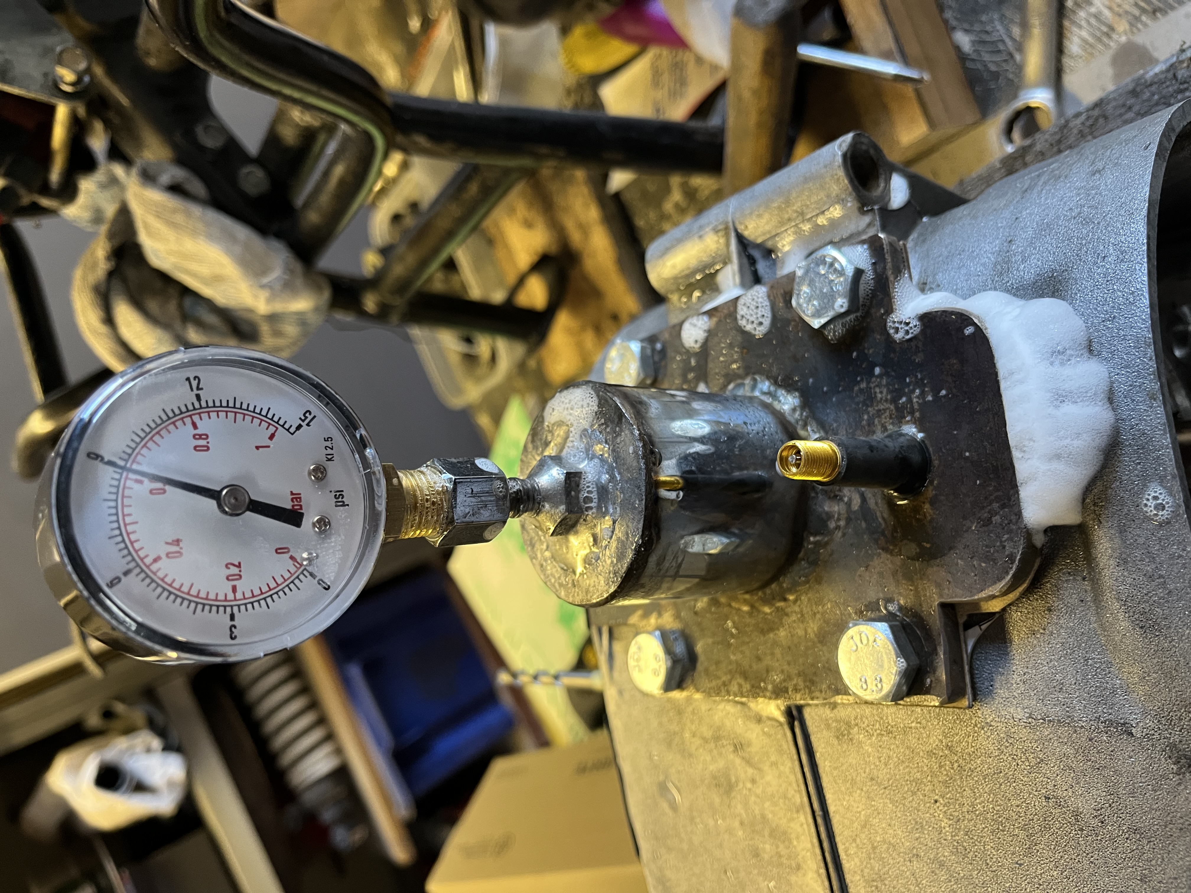

New oil seals etc but it smokes like a magic show with mirrors! Anyway I did a crank leak pressure test and wasn’t happy as it was gently blowing out of the gearbox level screw hole. So from that I totally stripped the crank cases and started again. I leak tested the crank case for hairline cracks but nothing so I was happy and both unhappy for obvious reason. I prepped the case halves and reassembled then made a bespoke crank pressure tester.
It held good pressure for a few minutes so I then built up the whole engine and refitted it to the bike.

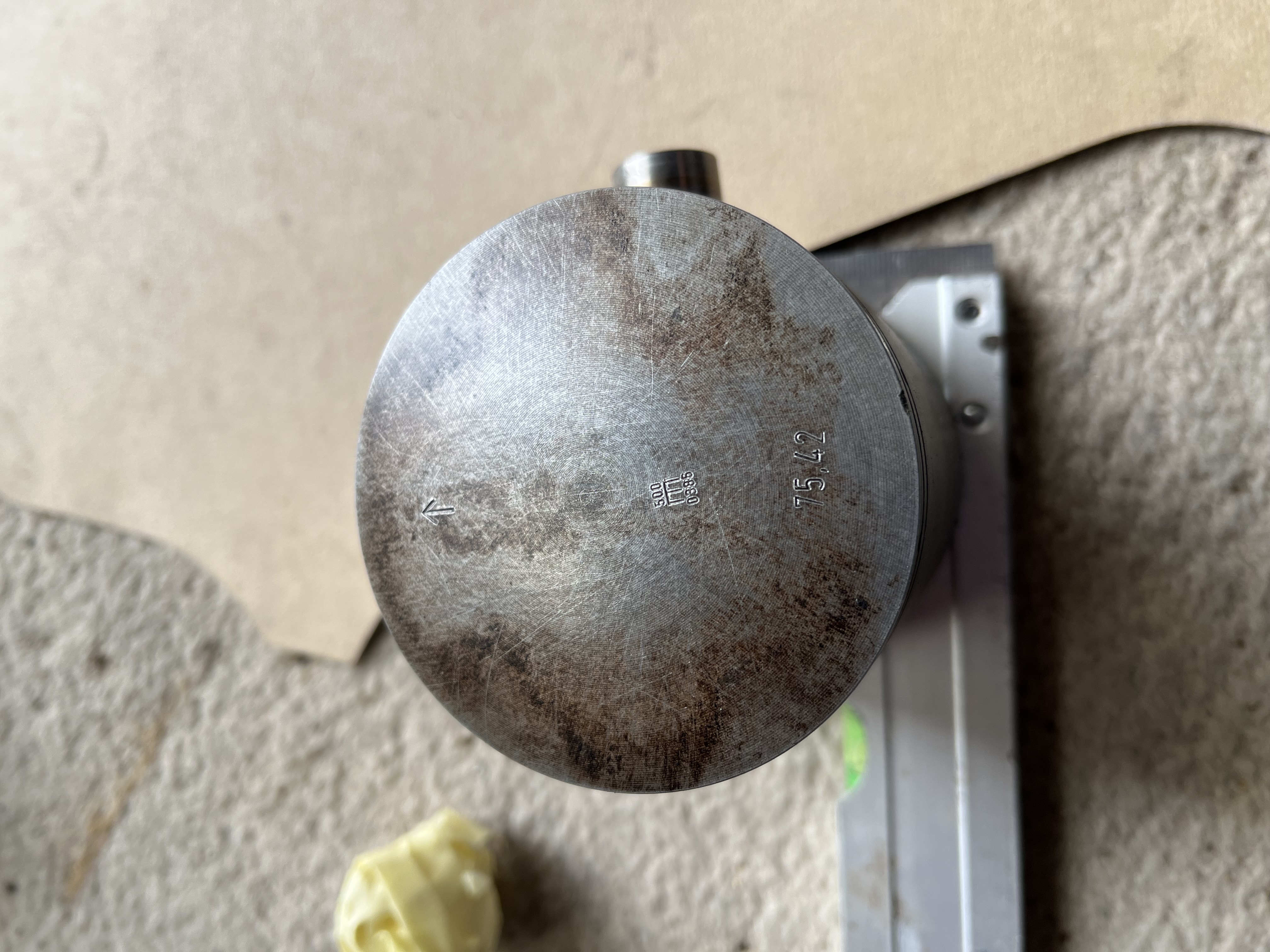

Whilst during the build I noticed the piston was a massive 75mm and that equates to 300cc. Anyway back on track…. The bike still smokes well past expected and covers the whole road in oil mist turning it black.

75mm would I guess be 287cc piston if stroke is still 65.
Probably likely if there aren't any markings that the barrel has just been over-bored. What do the linings look like? Are they thick still, or has it been bored out so much that tapered edges to help piston ring installation are missing?
I myself have an 76mm piston (making 295cc) but on an overbored 250 barrel. No markings etc- it's just been done, and I've continued to use it.

Crankshaft is the same on 250 and 300 ccm.
But the 300 ccm engine was not produced before 1989, so your 300 ccm engine is a 250 ccm engine tuned to 300 ccm. The piston should be around 75,45 mm.
