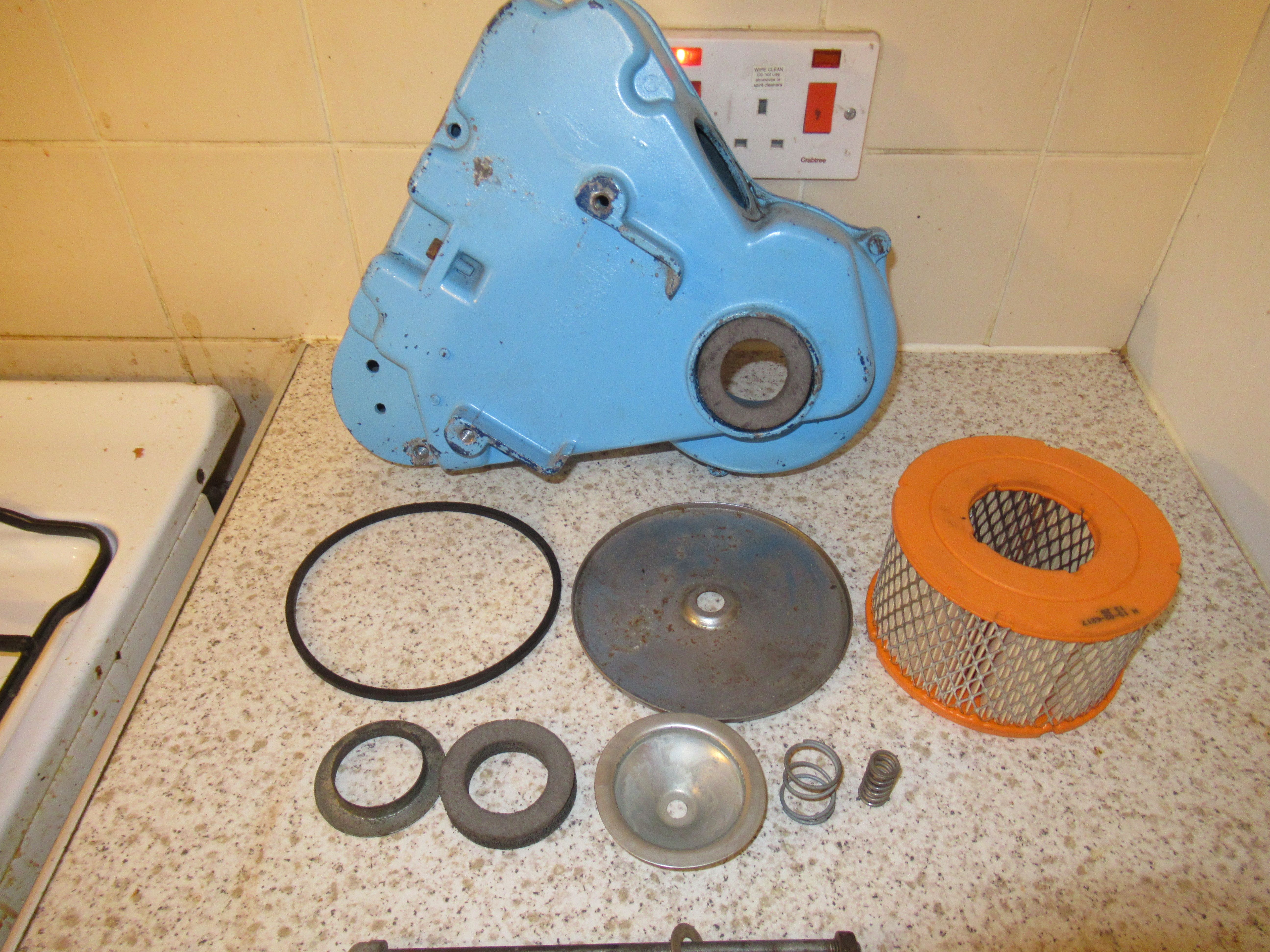

Re: TS250/1 - 5 speed
Postby mick » Fri May 19, 2023 6:41 pm
Hi folks. Can I ask if anyone knows the order of assembly for my TS 250/1 filter box. It has been years since I removed the filter and am uncertain how the order of bits go back together.
I have glued the new round sponge into the filter box where it connects to the frame ( is it correct ) but I also have another sponge in with the new filter bits I bought.
Above the long stud on the far left is a steel pressing that looks like one of these sponges fits onto it, but I do not know where it goes.
I also have two springs, one new small one and a bigger one I had in with the bits. Help :oops:

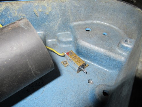

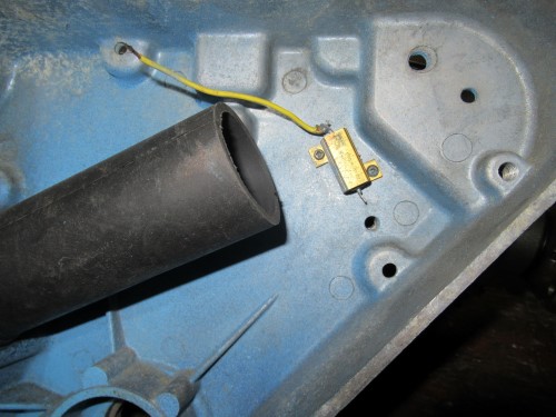

Postby mick » Fri Jan 19, 2024 11:32 am
Sorry about the delay folks.
Here is the component in place and it has blue over spray paint from the factory on it, so it looks original to me. Its academic though as it does not seem to have been used. Strange. Thanks for your replies :D

Postby breakwellmz » Sun Jan 21, 2024 3:27 am
It looks like an electric motor, how odd!
Postby Jay Bee » Sun Jan 21, 2024 5:29 am
Mick -
It's a resistor. "Power wirewound resistor", to give its full description.
Haven't a clue what it's doing there........
Postby mick » Sun Jan 21, 2024 11:33 am
Thanks for the info, I think I will just solder a new wire on the end it fell off from and then close the housing so I can fit it together.
Postby breakwellmz » Mon Jan 22, 2024 3:18 am
So what is on the other end of the wire Mick?
Postby Jay Bee » Mon Jan 22, 2024 5:52 am
The resistor needs series connection i.e. to both ends if it is to function.
As breakwellmz asked :-
breakwellmz wrote:So what is on the other end of the wire Mick?
How many unused holes have been made in the filter housing ? It may be a good idea to close those - securely.
Personally, I'd be very wary of any kind of threaded fasteners inside an airbox ; if they unscrew or detach you could end up with costly engine damage.
Jay Bee
Posts: 66
Joined: Wed Aug 13, 2014 7:38 pm
Postby mick » Mon Jan 22, 2024 4:18 pm
The only holes not used for threaded fasteners from one side or the other are the two just to the right of the resistor inside the cover. I agree that the bolts coming loose would cause bad damage to the engine, and the wires from the resistor are just 4 inch lengths of yellow wire, one of which has fallen off.
The screws for the resistor have small nuts on the rear that were heavily painted over and I think I will loctite those and do the same with threaded bolts to block the spare holes to stop unfiltered air bypassing the filter. Strange if this is from the factory.
